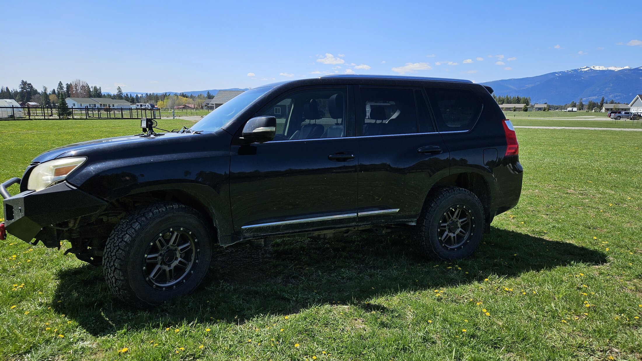

Yes, it's DIY if you've got the time and liquid courage. You can get color matched handles to remove the gross fake chrome. Didn't take long per door. DO NOT ORDER CHINESE KNOCKOFFS!!
The rubber gaskets for door handles are P/N 6924260080 and P/N 6924160060.
Black door handles:
69210-60150-C0 - Handle, Front Door (Qty: 2)
69250-60030-C0 - Handle Cover, Front Door RH
69217-60150-C0 - Handle Cover, Front Door LH
69211-60090-C0 - Handle, Rear Door (Qty: 2)
69250-60010-C0 - Handle Cover, Rear Door (Qty: 2)
