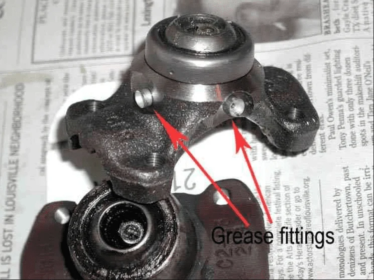

do you have a DC shaft? if so there is a ball joint that has a needle valve to grease the joint. very hard to see the needle valve and harder to get to. I remove the shaft to grease mine. Took me forever to figure out where my squeak was coming from. pic taken from the web.
I don't think so. Looks pretty standard, is that common?
