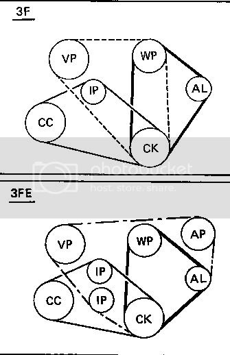

i was going donw the highway and one of my belts snapped. when i piulled over the main belt was the only one there. i guess there were 3 belts, i never really paid attention. i cant figure out the proper routing. can somebody show the way to rout them, and if you have part numbers for all three i would appriecate that. thanks
