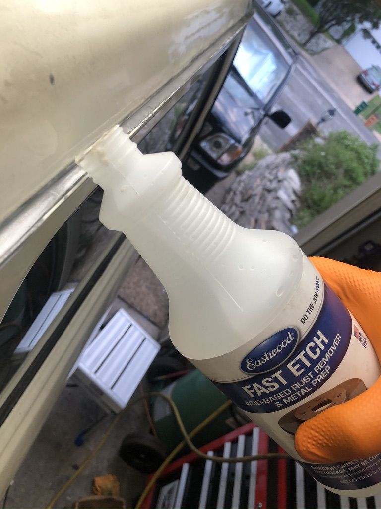

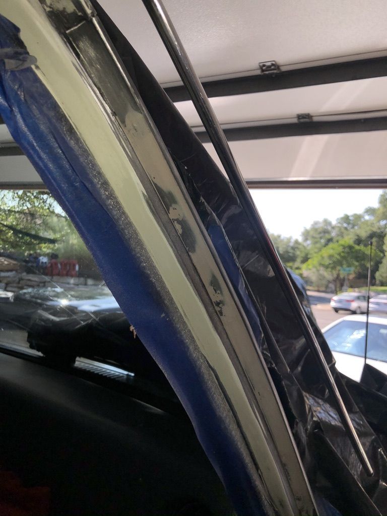

Expanded on my A piller work today, as I found some bubbles near the back gutter, just above the back window.
Some rust but mostly OK and I want it that way.
First step was to stop the good metal from rusting and convert the existing rusty areas.
Need some thoughts on the order of next steps:
- seal the seam with paintable or other seam sealer
- self leveling sealer
- prime
- paint
Should I do the same from underneath sans self leveing sealer? Can't see bubbling but there is that area where the two parts of the rain gutter come together.
Next steps look good to me. Scrape out and re seam seal the underneath area as well.
