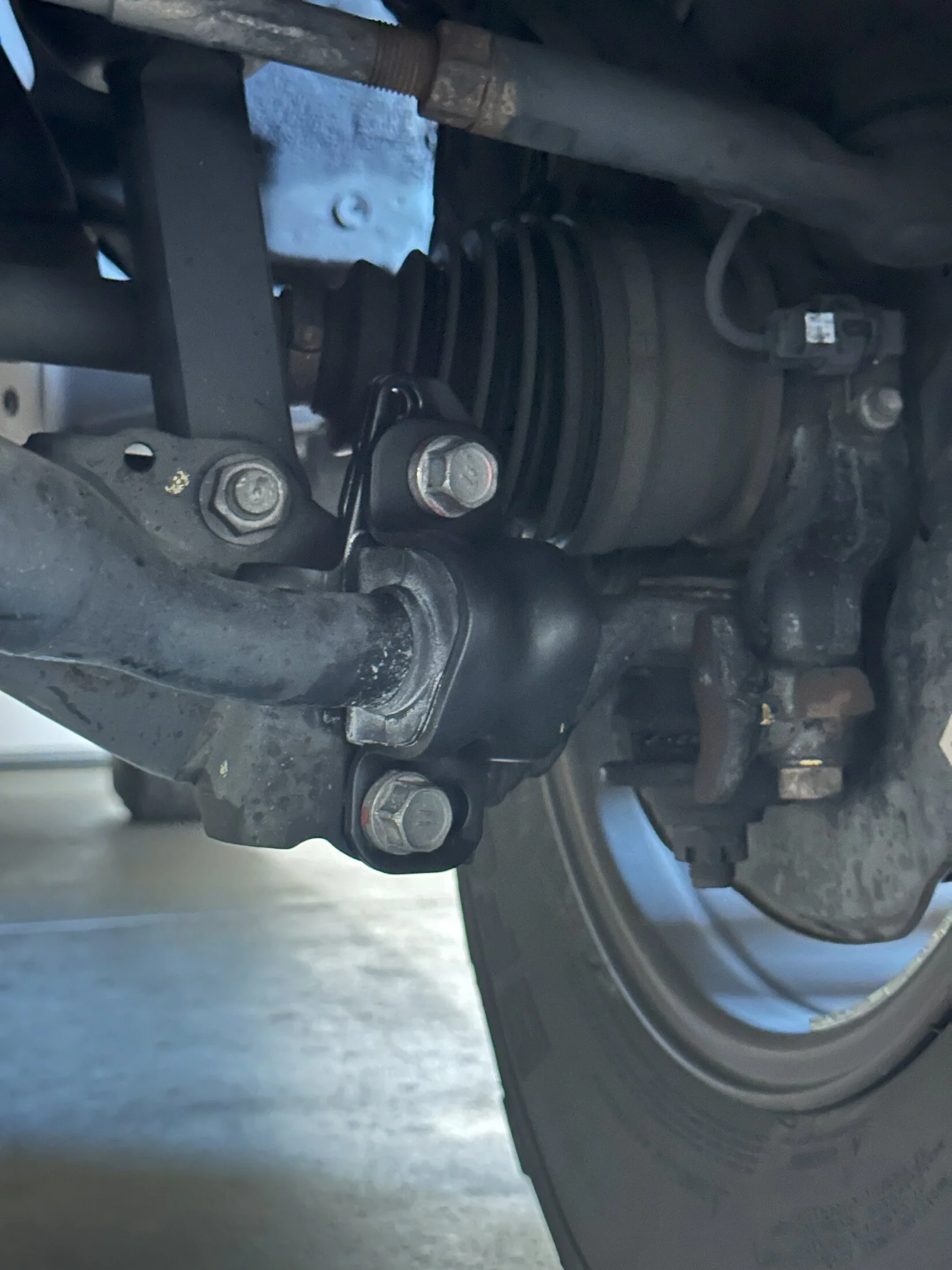

I inquired with Dom (DR KDSS) through his site, and eventually, it turned into a phone call. He looked through some photos I sent and recommended the front billet clamps and bushing brackets, with the option to get his bushings, too. It was cool of him to explain why no other parts were necessary in the rear or front. Anyone else could have easily said "buy this and this too" to get the revenue as high as possible. Where I was ready to drop $500+ to get things right, it all came to $189 this morning.
Here's where my front bushing is a little out of alignment - which he explained in good enough detail to make sense to my thick, dumb skull. You can see where the front sway bar is getting pushed down on the bushing. Will report back after the install is done.
