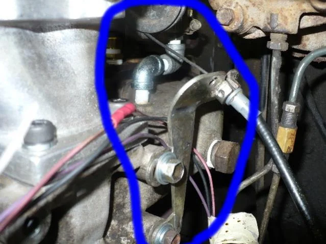

I sure would like to see an actual picture of a working throttle linkage using only the parts included in the Downey kit.
This is about as far as I got before I s*** canned the whole thing.

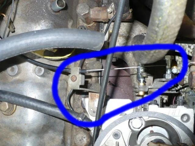

This way works so much better. And best of all the bracket was made from the existing TBI bracket all I did was cut off an ear and drill a hole. This way you get to use the cam on the later TBI's. Makes for a lot better and easier to use gas pedal. Also the cable needs to be maybe 18 inches max.
That being said Downey designed the brackets to really work for the early TB's. The one's with the single lever out the side. Still I couldn't see how it would work well.

Throttle cable conversion, nice. I have been contemplating this for quite some time. Would it work with the carb or is it designed to only work with the TB?

Yeah, Marshall's does run great and he is the ONLY reason mine runs at all. My point of this thread is the throttle bracket for the fancy dancy laser cut plate from Downey(spoken with lots of ooooh's and ahhh's) is a POS and until I see an actual working throttle cable using only Downey parts I will remain convinced that it cannot be done.
While I am not a spokesperson or otherwise a representative of Downey, the kit that Downey sells for the TBI didn’t say anything about not needing to adapt or fabricate something for the throttle linkage. At least nothing that I have read. To me it just offered a plate to give me a platform to start with.
I used their plate and with it adapted a clamp standoff for my hand throttle which is nothing more than a bicycle shifting cable terminated on the gear shift shaft. Also the regular foot throttle, I used the bracket that was used on the old carburetor linkage which bolted up on the intake manifold.
TB only.
