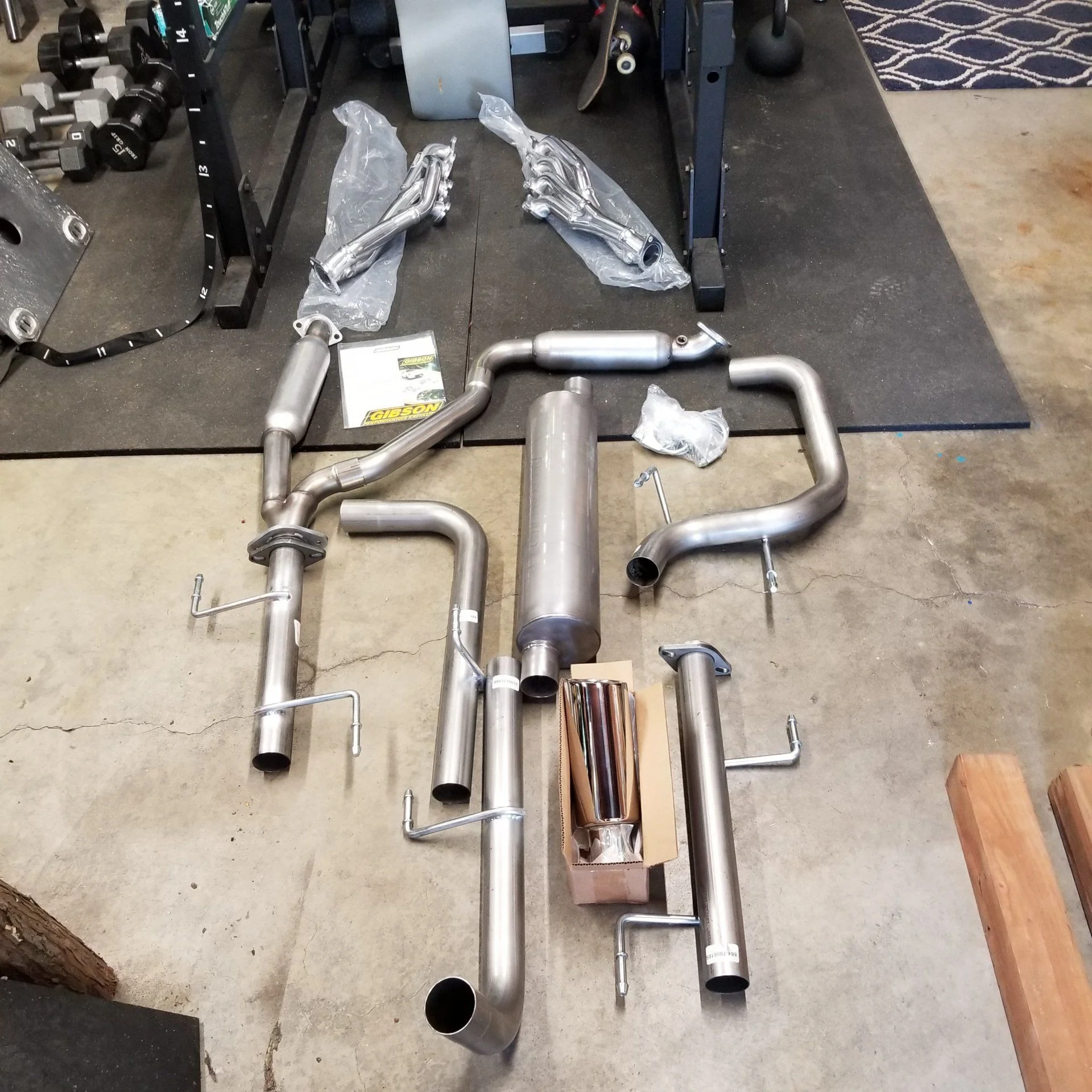

I purchased Doug Thorley long tube headers for the 03-04' gx470 with no secondary air pump tubes. I bought a Hewitt Tech SAIP module to bypass the pump and opted to remove all the associated plumbing. (More on that to follow).
I got URD mid pipes to match to my headers and a Gibson catback exhaust to finish it. My goal was for a nice V8 growl without being too loud and no drone (Time will tell).

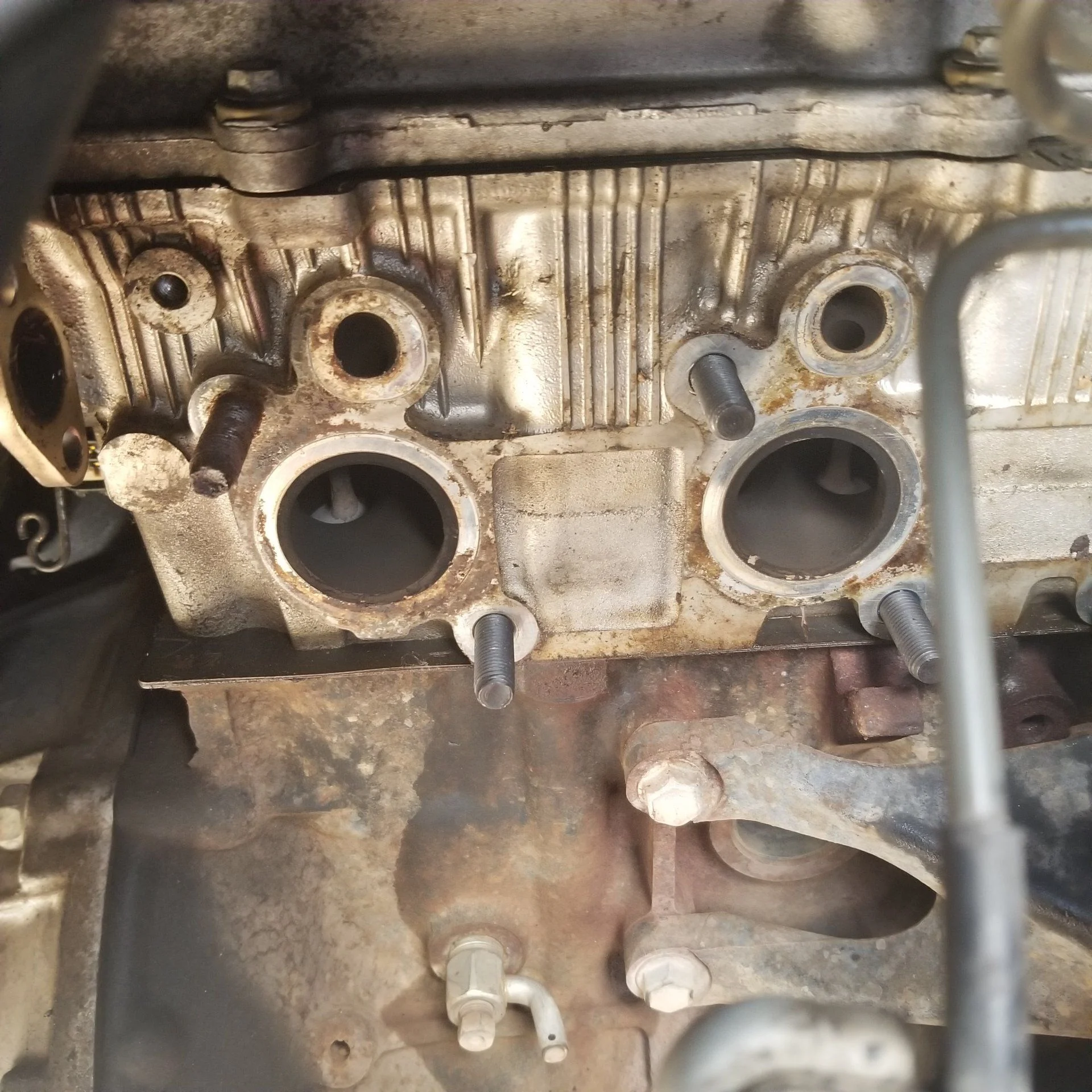

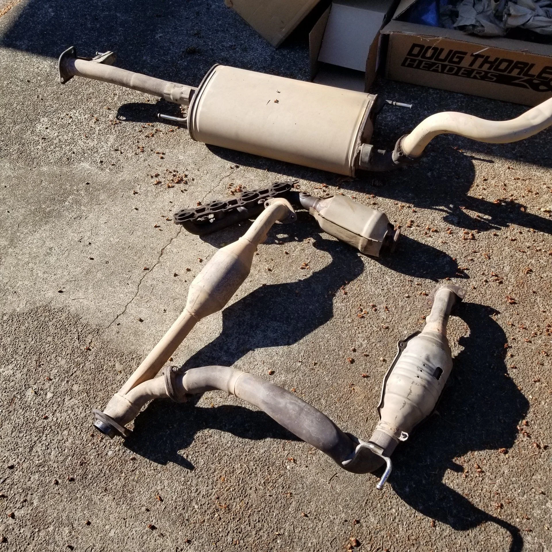

Header removal was atrocious. I've done Jeep headers, BMW M3 headers, Audi S4 headers so this job is not foreign to me. Lexus just seemed to put every suspension component and wire loom in the way of all the header bolts. I followed the instructions and started on the passenger side. It was a nice warm up for how s***ty the driver side was going to be. Passenger side came out in about 3 hours. Driver side took about 7 hours. I had 3 nuts strip on the driver side and of 7 of the 8 manifold studs backed out.
A thin wall long neck spiral extractor for the stripped nuts off after lifting the engine gave a straight line to the bolt. Fan shoud will contact the fan and one will break so don't try to hoist the engine more that 2" without removing the fan or shroud.
I replaced the studs that backed out with M10x1.25 studs of the same length and opted for JIS stainess notched flange nuts. I'll do a dab of red loctite on the bolts as blue with burn off with the manifold heat.

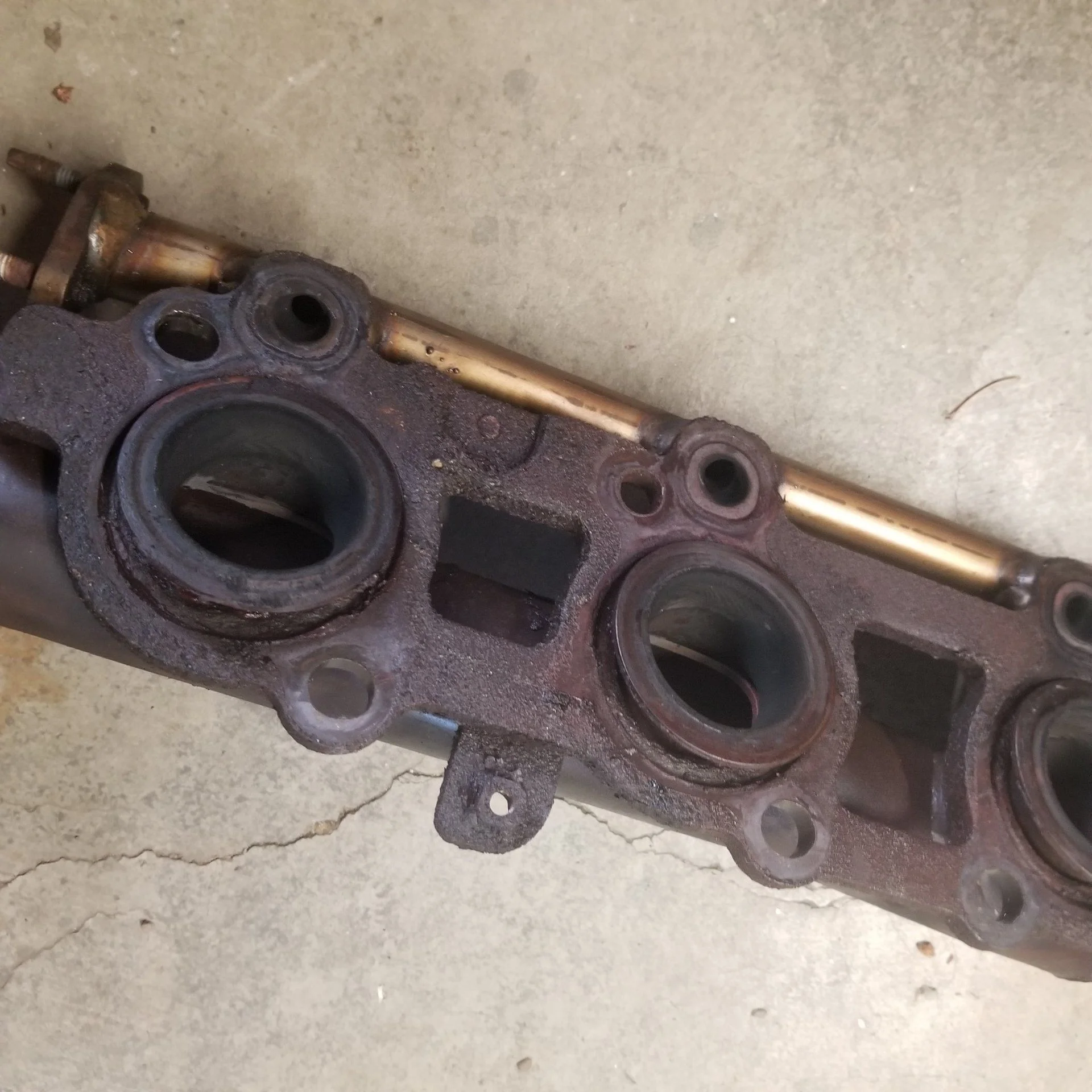

Problem I discovered once the headers were ready to reinstall is the 05-09 with the exhaust tubes actually have ports in the cylinder heads, not ported from the headers. This means I'll have open ports, which is a no-go. I send the headers I got a year ago back, which is a no-go. Or, I template the gasket, cut steel blockers and weld them to the header. I opted for "C".
I used the gasket as a template (rough face towards the header). (Made that mistake once!). Once I had my piece cut, I clamped the header to my table, aligned the blockers, clamped those (to prevent warping) then tacked them down.
Once cooled, I pulled them, test fit to ensure the ports were covered, then clamped everything back up and ran beads. I'm using flux as I'm out of gas and some research said it's better on stainless, but who knows, and it's all I had. Penetration looks good and the welds look solid. I'll finish header #2 tomorrow then start reassembling.

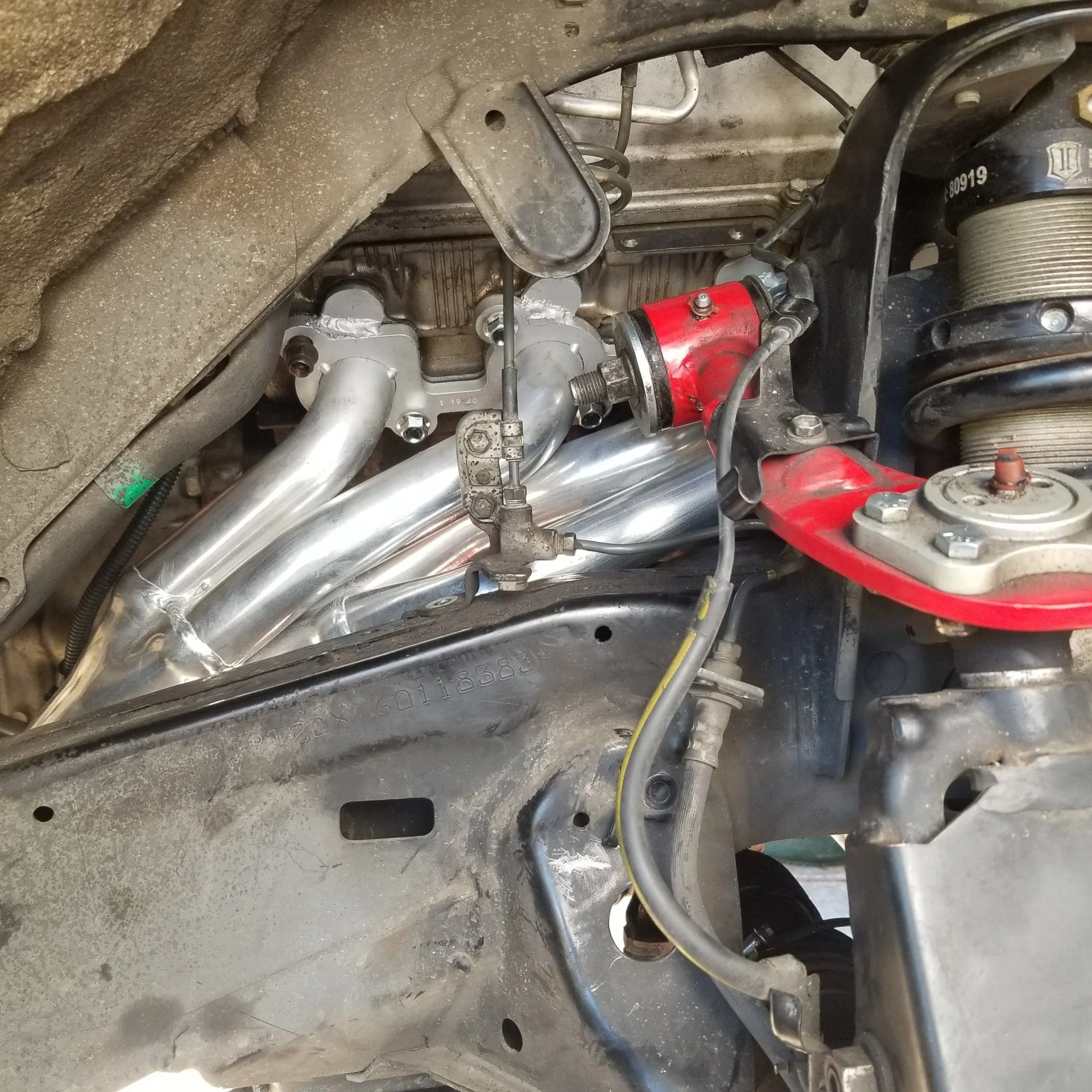

Welds complete. Steel tabs coated with high-temp primer and header paint in raw aluminum. Not a terrible color match.
The passanger side went in without too much struggle. A second pair of hands would have been nice to align the gasket, but it can be done solo.

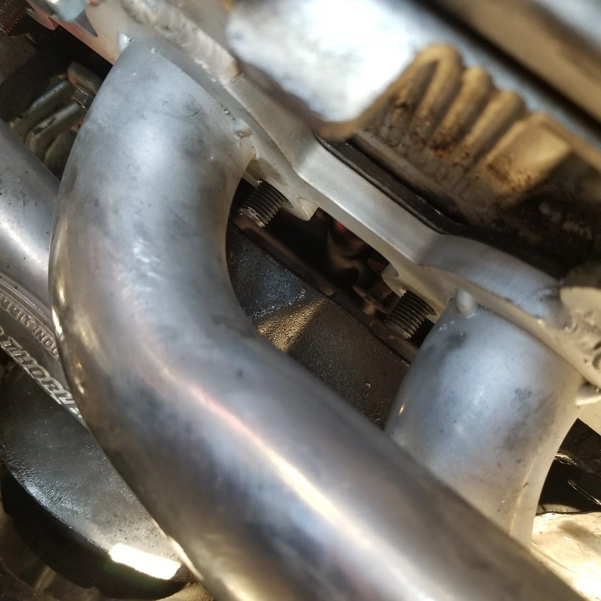

The passanger side is 90% on. I have 2 more nuts to thread on. Getting the header seated was an absolute bear! Another hour of wrestling with something that seems like it wasn't meant to fit in such a tiny space. Also, on the driver's side, it seems each header tube is place directly over the stud/nut. My guess is there isn't a lot of options. I'm absolutely not a header fabricator but if I was offering feedback, it would be align the pipe to allow access to the nut with something other than a Barbie wrench.
The last two pictures show a top down, then straight on view on 2 of the nuts. The farthest right is far worse but I cant fit a camera in there.

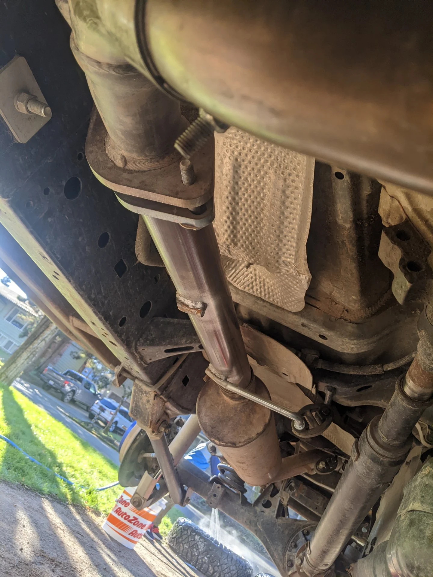

I didn't discuss it much, but you can see a cat back exhaust pictured in my original 2020 post. That's the magnaflow overland system. It's been on the GX since I originally started this process.
It's nice and has a decent rumble, but the quieter the better for me. I'm not looking for an American V8 sound, so I'd appreciate if it was a bit quieter. But it gets the factory duffle bag of a muffler out from under the truck and saves weight, which was a huge factor for me.
Regarding fuel economy, there's no way my set up would give a decent point of reference. I'm on 35's, I run 4.56 gears, I have front and rear steel bumpers, a fridge, drawers, armor, ECT so my MPG is atrocious, but not unexpected. That said, if you have the same set up and want to install headers, I average in the low 13's.

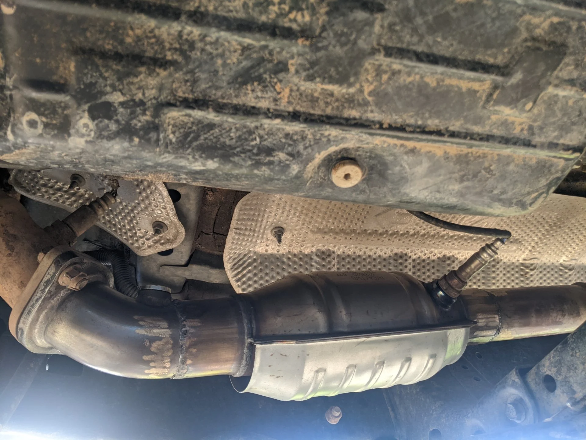

And before anyone points it out, I know the heat shield should be between the cat and the body. I had to install them this way for the clocking of the 02 sensor body.
