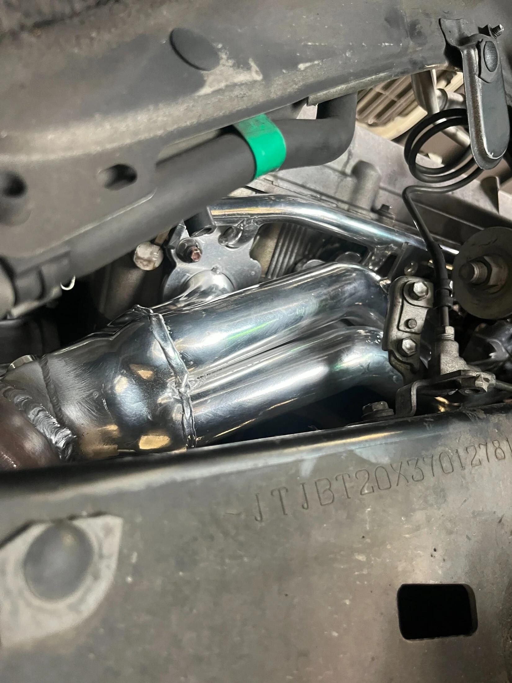

Hello all,
First time poster! I recently picked up my 2007 Lexus GX470 on March 8th and can't really seem to find anything regarding this issue here with the search so please forgive me if I missed a similar post. I've done some digging through general searches (google, not on this forum) about what could potentially cause a lean (P0174) code to be thrown. My buddies at the shop were generous to take on this install for me, they chopped the cats off OEM headers to weld and install the shorties onto my truck. The install went super well aside from finding that the passenger header had a minor leak by where the EGR tube was supposed to go.
They pulled the passenger side off and fixed the leak with more welding and reinstalled the header. Now the truck has no exhaust leak (thank God) yet it's still throwing the P0174 code. They replaced the o2 sensor and the problem persists, it's a very strange issue where the car will be driving perfectly fine (shrtft2 ~ 0% & longft2 ~ 0%) before it suddenly jumps to shrtft2 ~ 22% & longft2 ~ 30%. Not incrementally, just straight 0 -> ~20. We are stuck scratching our heads as we try to diagnose the issue but we feel the car just needs to have some sort of recalibration on the sensors now that they are seeing much more air than pre-install. Mind you, the OEM exhaust leak on my truck was horrendous, it made lawnmowers sound good. I live in California at the moment and so I need the shorties until I'm back in Alberta, where they laugh at anyone that has to deal with emissions testing, and can replace the headers with the DT long tube headers.
Sorry for this block of text but this is what we are dealing with. The owner of the shop is going to take the truck home today and do some longer drives to figure out what's going on. But I wanted to post here to see if anyone else has experienced this before (or know why it's being funky). (Bonus, I'm eagerly waiting to install the Magnaflow Overland exhaust when I get the truck back, it's currently sitting in the cargo area).
