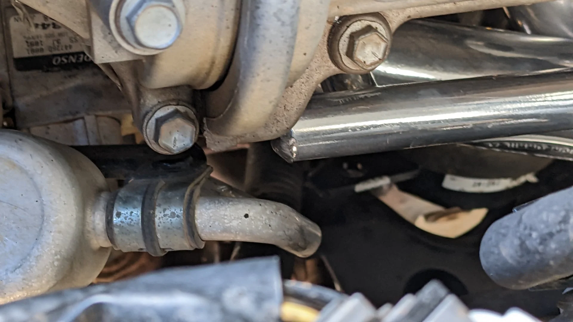

I didn't know you're running a mod on the secondary rails ... head holes plugged, what's the setup you're running to bypass this? Is this exhaust gas recirculation emissions stuff?

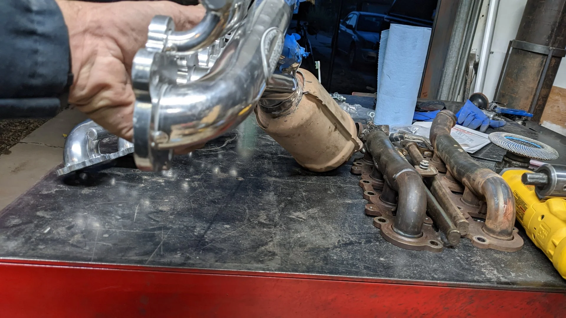

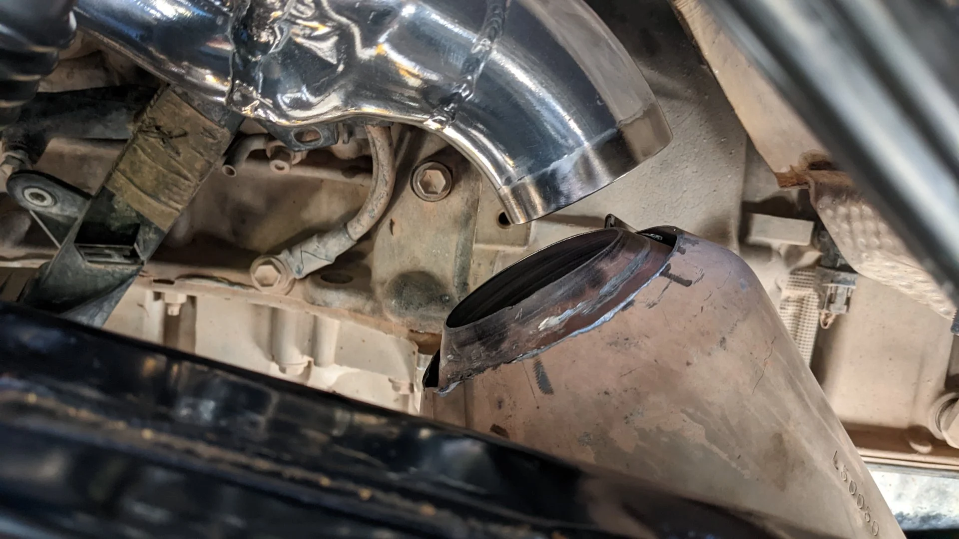

What was your process in aligning all the flanges and chasing leaks? I assume new. Dough it's @ flanges and. Conical doughnut @ Y-pipe...

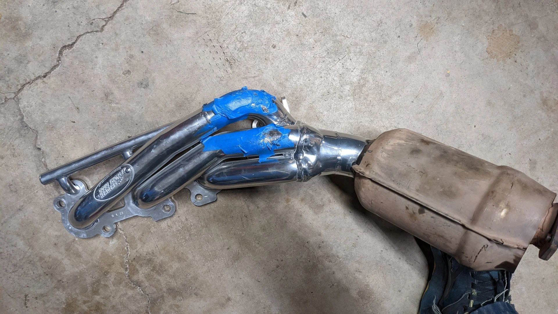

Ummm.. I'll probably have more questions, but I'm @ the step where I got both headers dry fitted, cats augered to sleeve on header outflow, bolted up y-pipe flanges and downstream all bolted and hung.
Tacked cats to headers and got it all back out on the bench for buddy's maad tig skillz.
