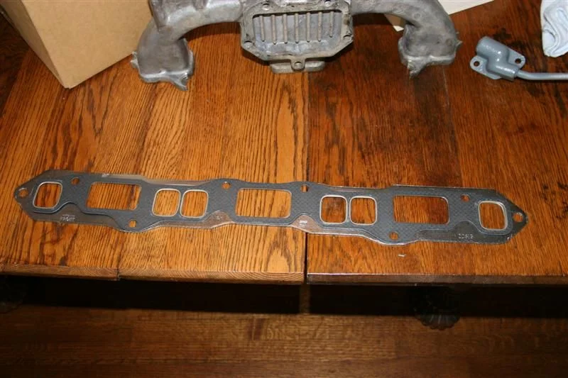

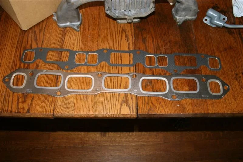

I second the Felpro gasket. I used two, but you'll probably be just fine with one. The MAF gasket is pretty weak when you compare it side by side with the Felpro.

double felpros...;)
