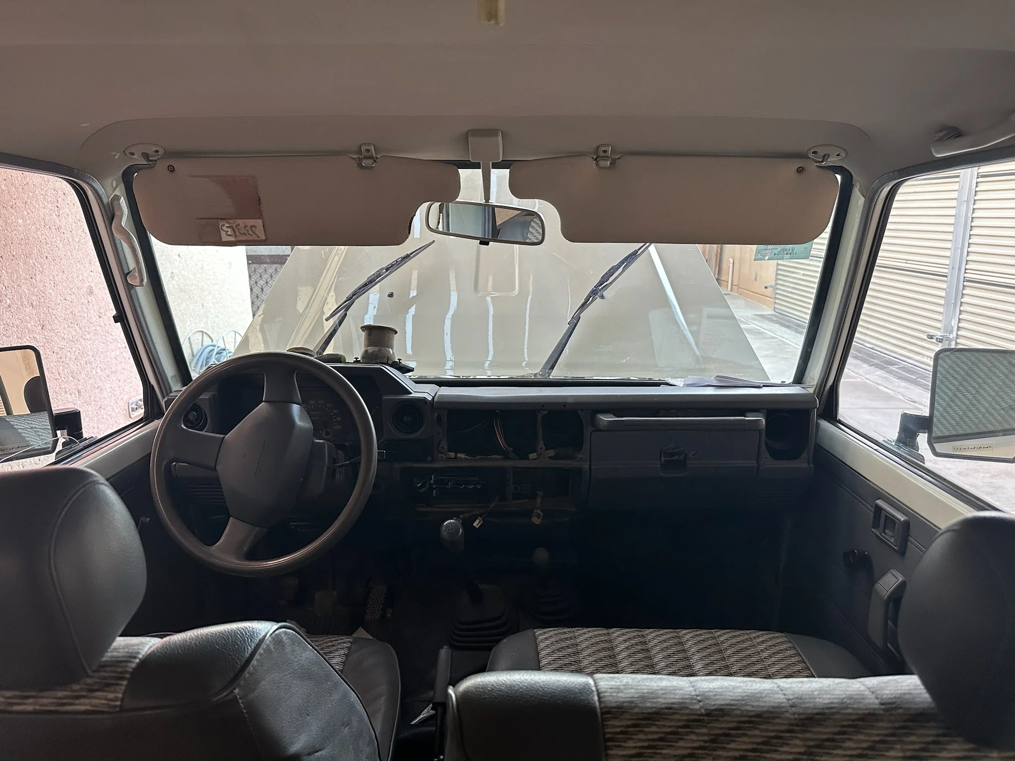

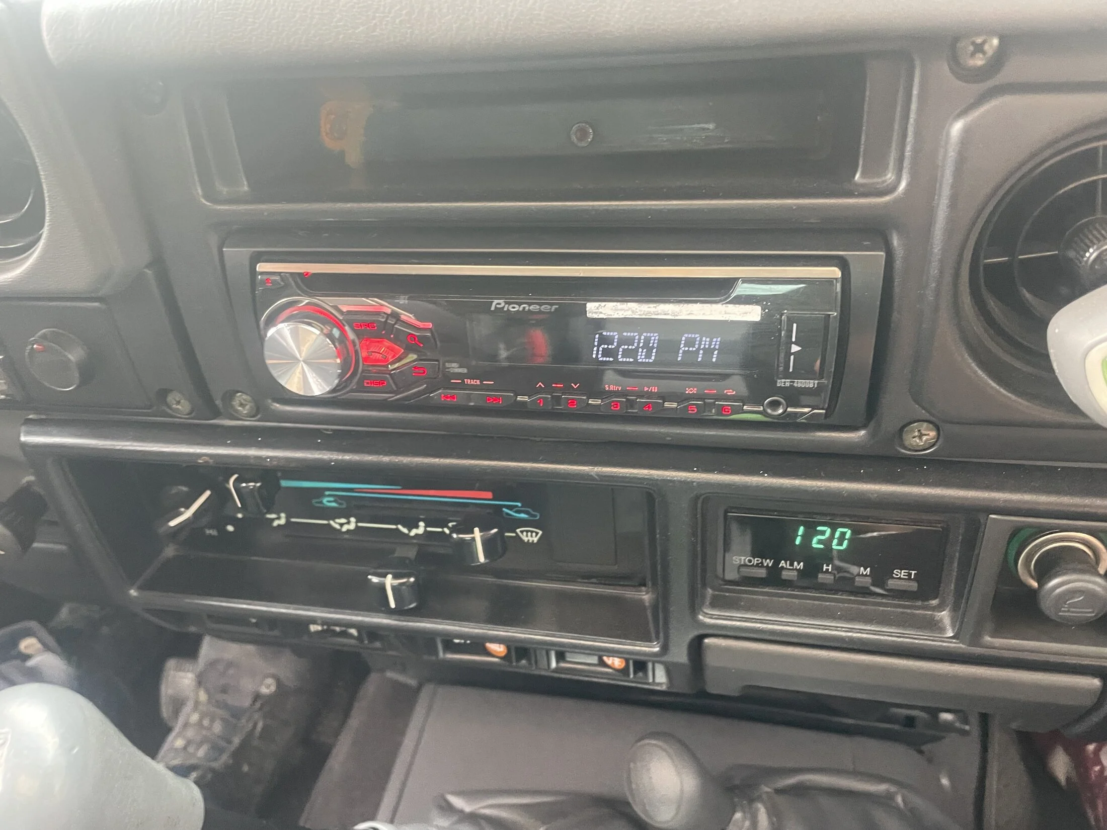

Do you have pictures of what’s in it now? I was able to use the factory stereo brackets that were in mine to mount a double din unit.
Here it is.

I have seen a few parts retailers after doing some digging on ih8mud that have the double din dash piece but it doesn’t show it’s compatible with the specific KZJ70 model, rather a few other LC models. Very new to LC ownership but I believe the dash should be the same on the KZJ70, 73,78 for that year. Are there any other models/years that would have an identical dash (and replacement parts) as the 96 KZJ70?

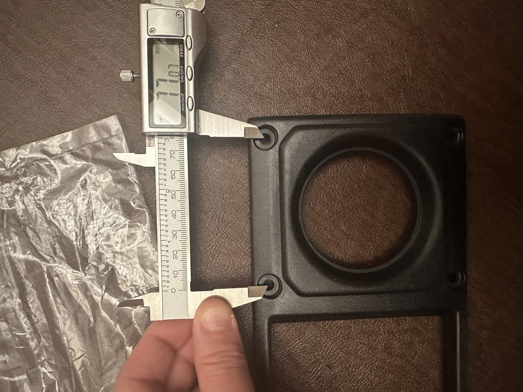

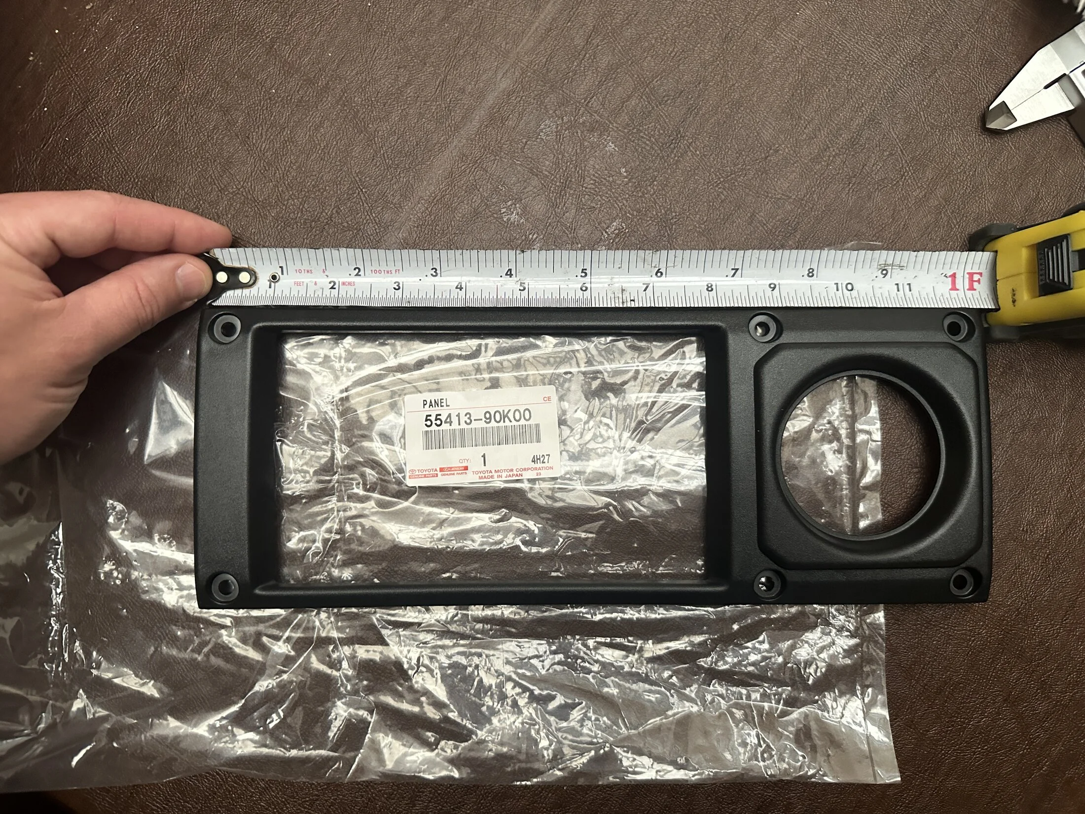

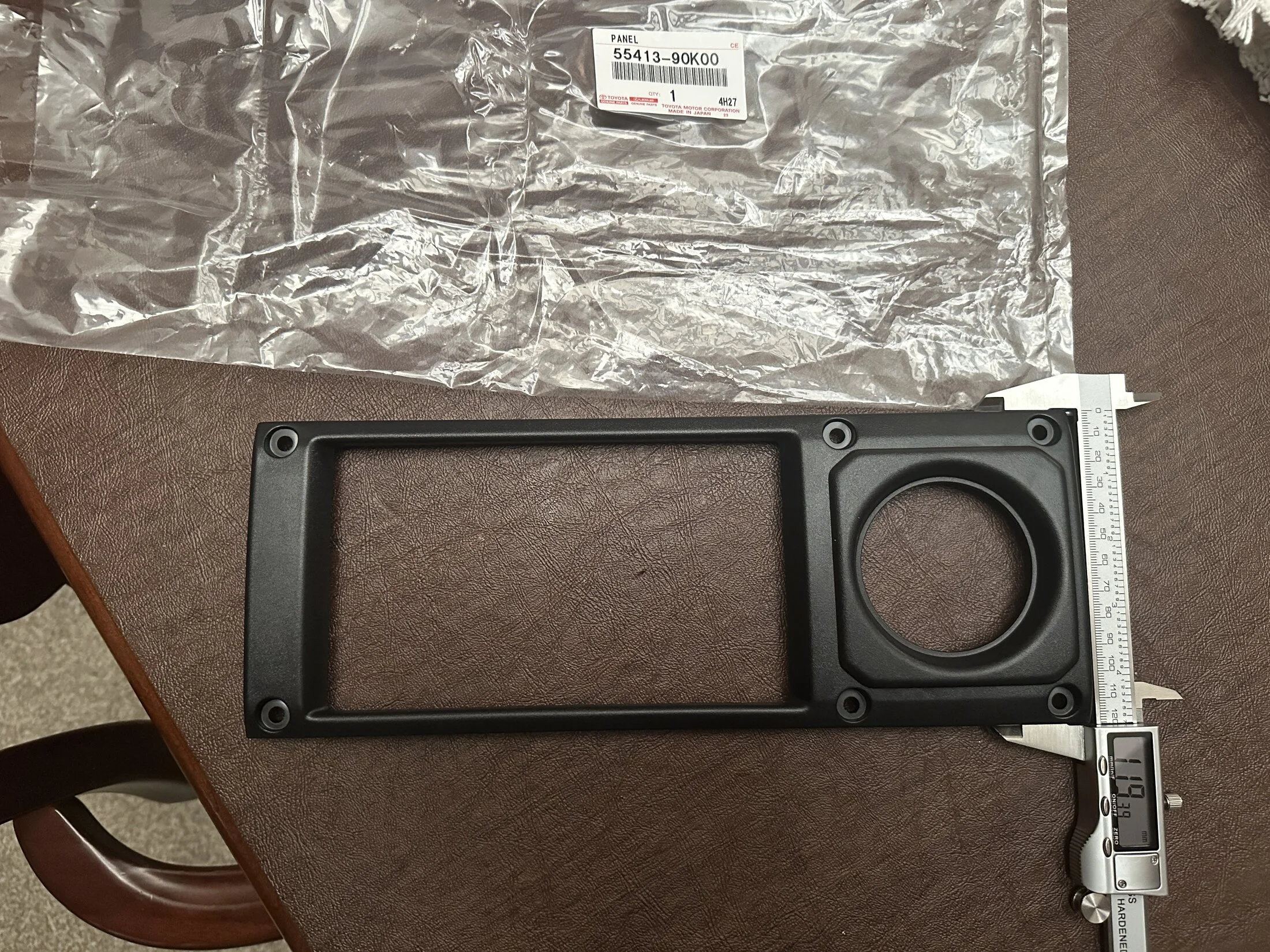

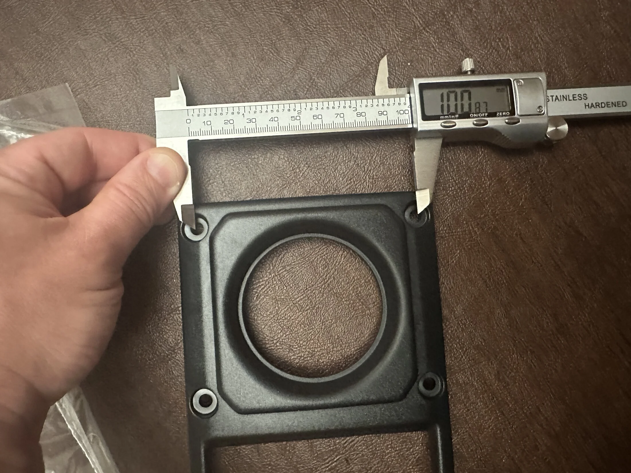

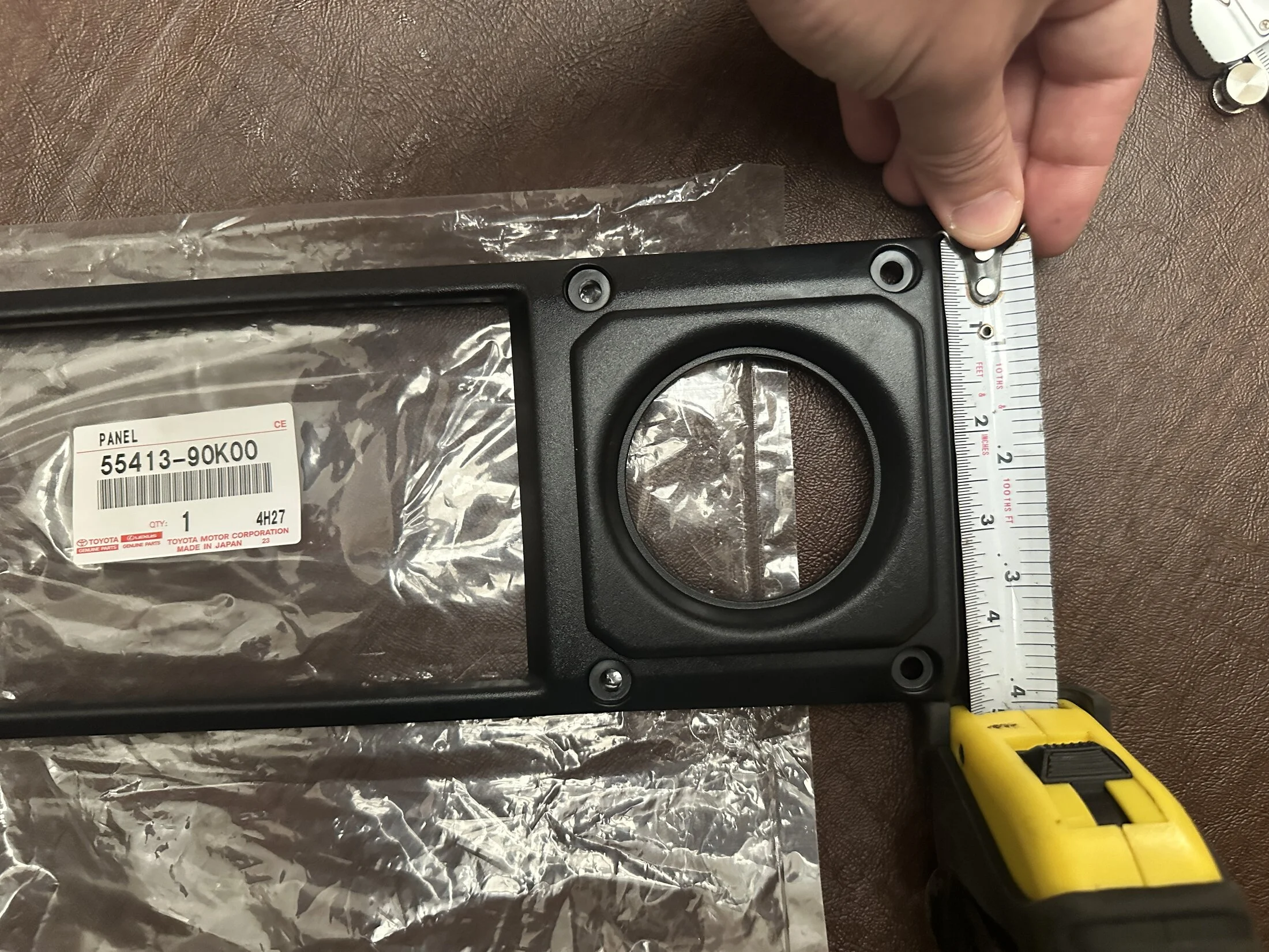

Your dash looks just like many (if not most all) pre-2006 70 series, not just the KZJs. Here is the double din piece for my dash, a 1998 FZJ70 (pic with part removed also included below), with measurements (ignore the tenths measurement on my tape measure). It is almost certain to fit yours, too.
PN is 55413-90K00, widely available new from places like yoshiparts, partsouq, megazip, amayama, etc. as well as I am sure others.

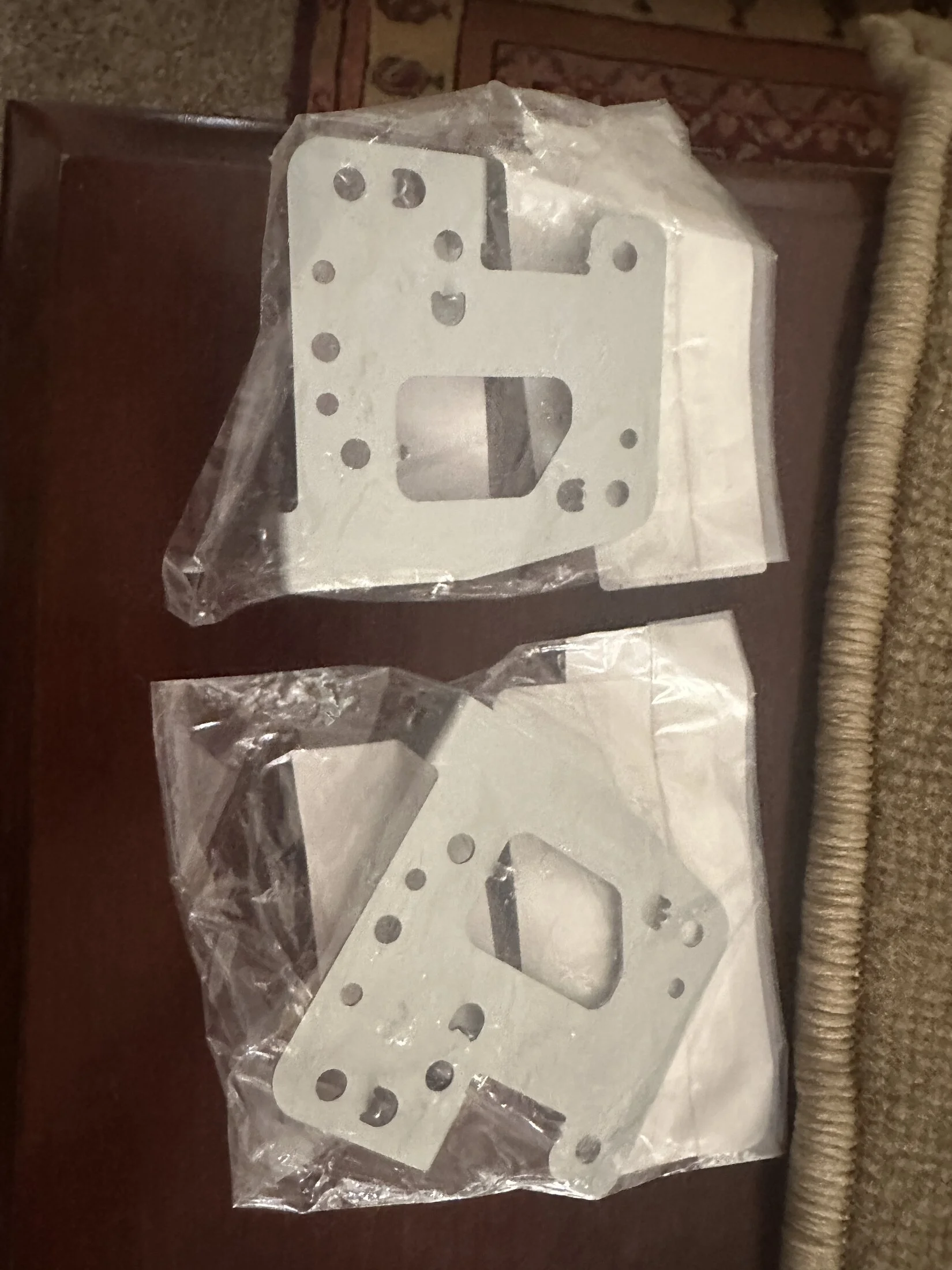

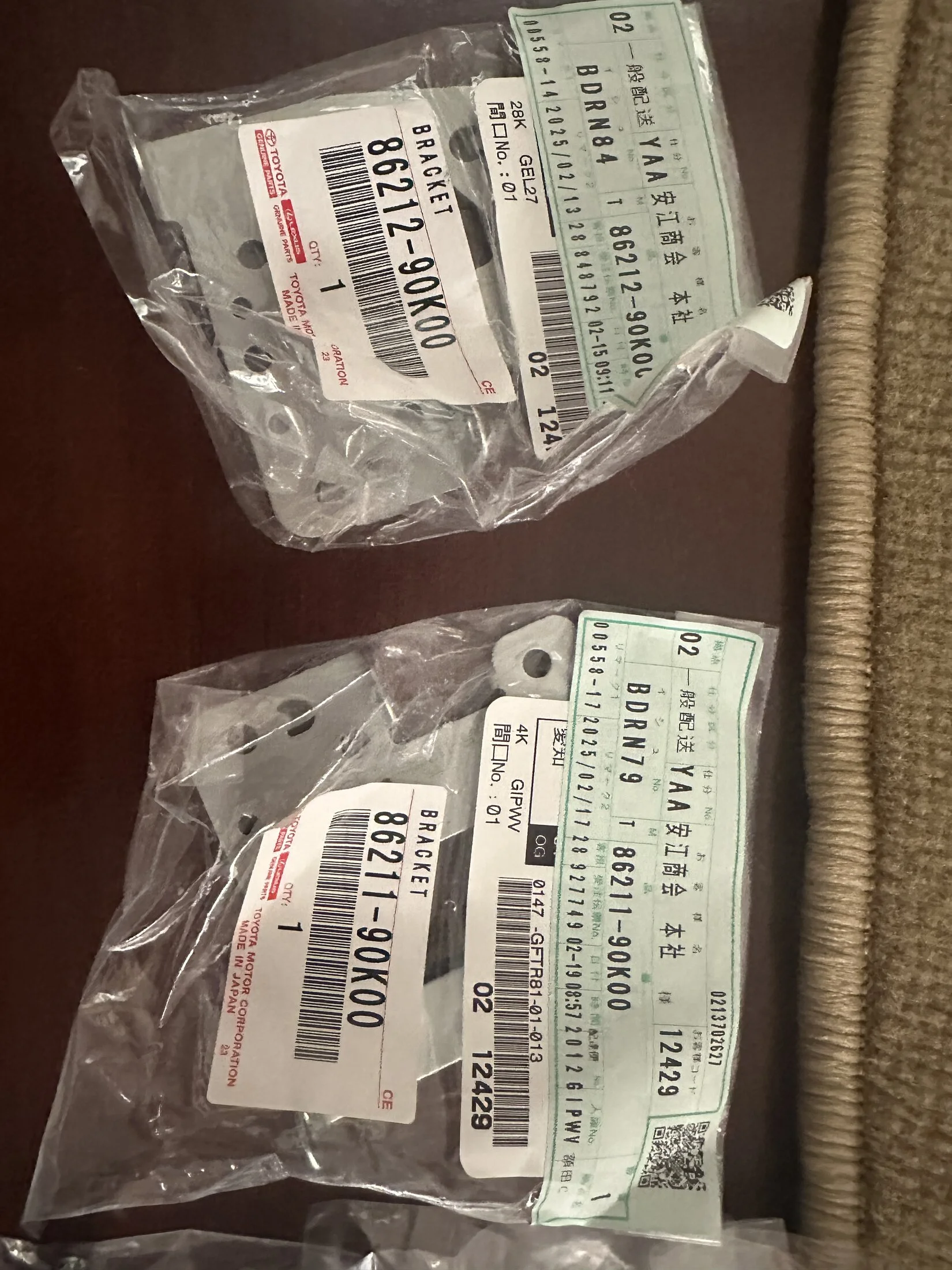

You may also want to check how your current radio is mounted in the double din bay, behind the plastic fascia. If you don't have them, you may also want to pick up the left and right radio brackets, which again, are almost certainly 86212-90K00 and 86211-90K00, and the screws 90149-50032.
Toyodiy.com has a very helpful feature where you can plug in a PN, and see what vehicles it was used on. You will find there is quite a lot of part commonality across land cruiser models, and even if something did not come from the factory on your particular frame number, it’s possible if not likely that other PNs will bolt right on. Just do your research.

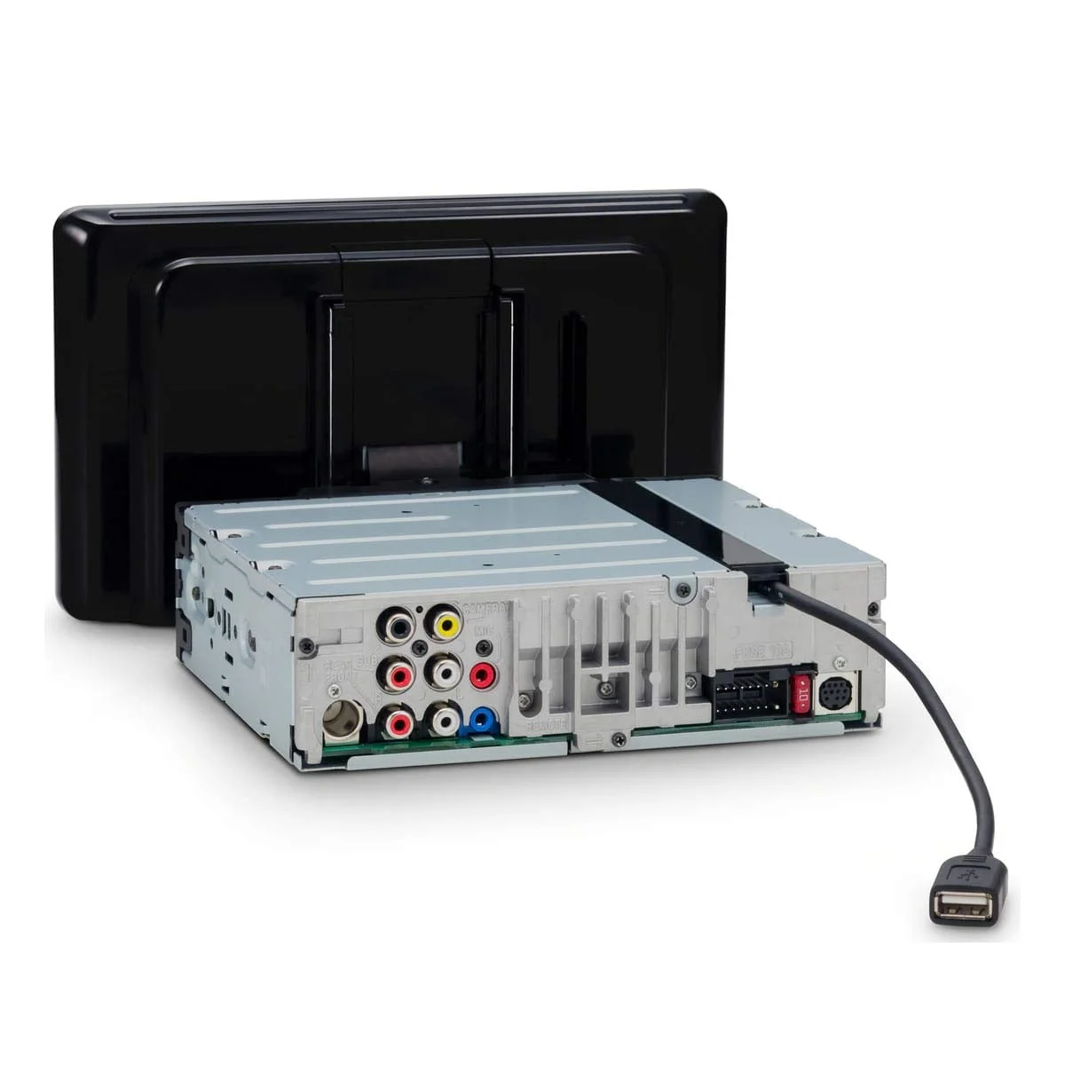

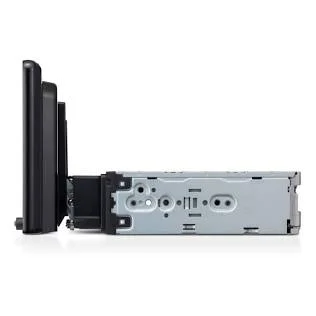

I have the flush mount Sony XAV -AX1000 and love it.
I really like that. Where did you purchase from? Did you need an antenna adapter? If so which one.
It’s in my 80. Don’t remember needing an antenna adapter. Don’t remember where I bought it either. Probably SonicElectonix though.
