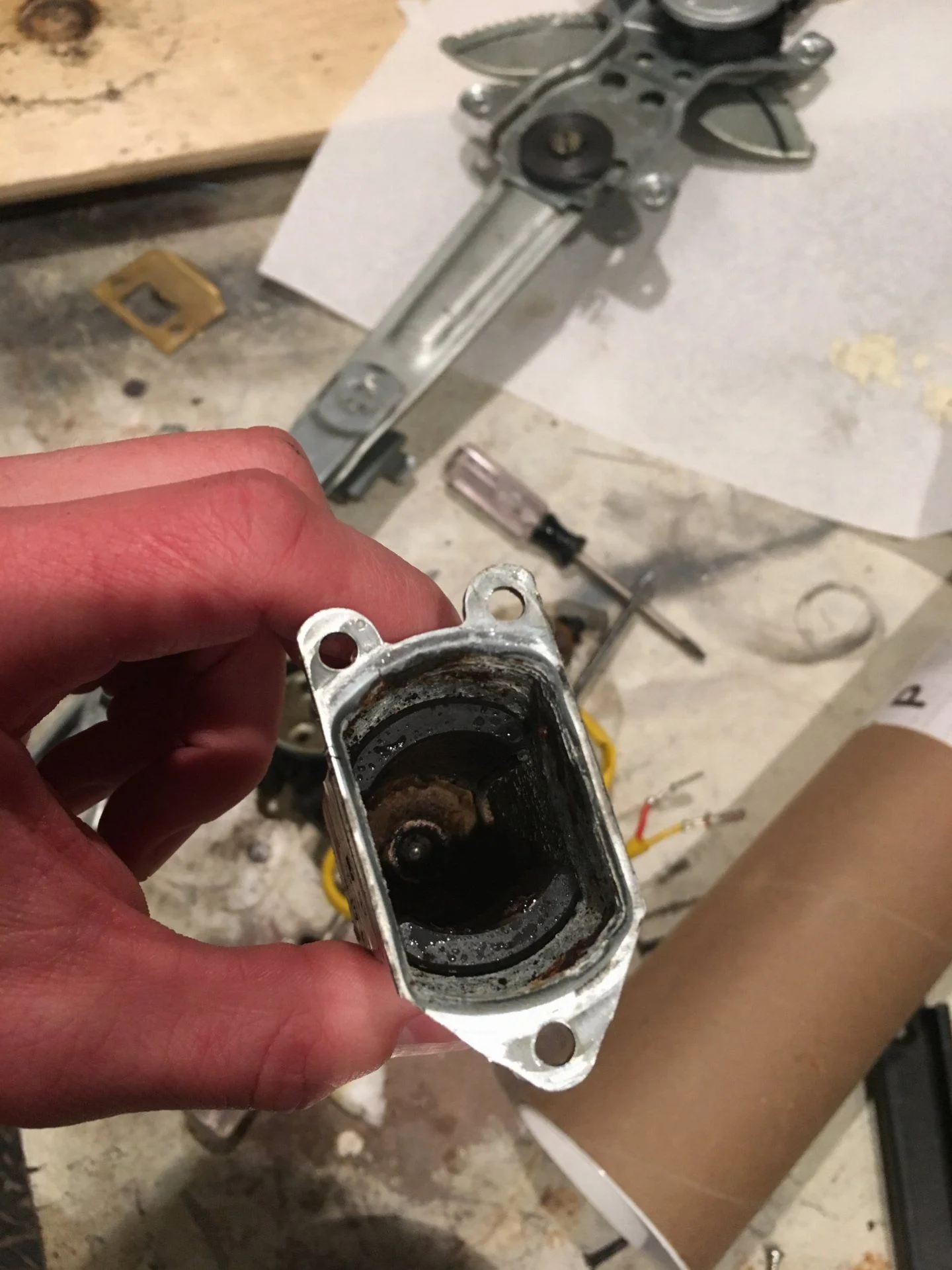

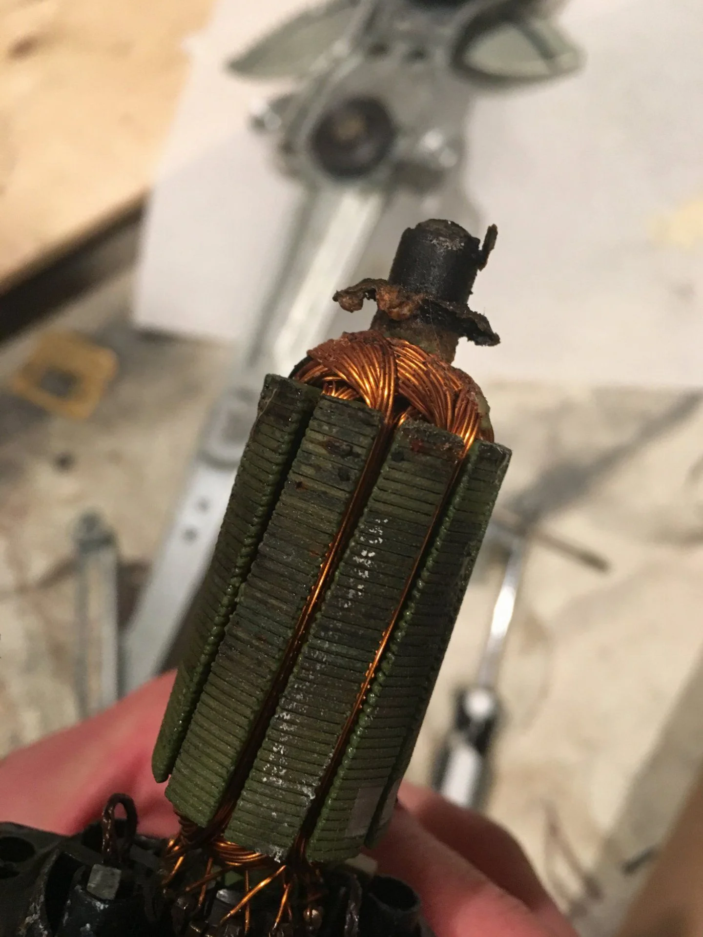

My front pass side crapped out after a year and a half. Looks like it got wet:
