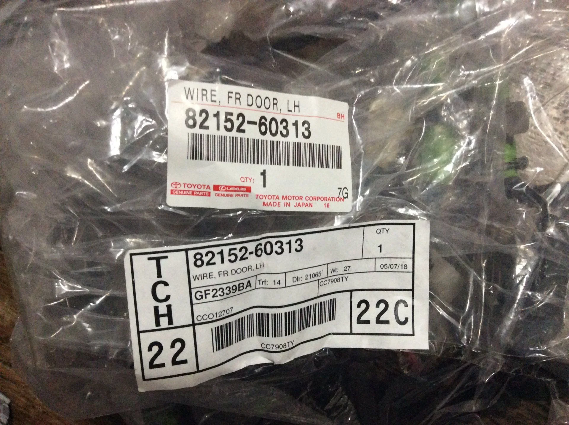

So replacing the driver door wire harness would fix this? Any idea how hard or expensive of a job this is?
I know exactly how hard and expensive this job is.
$275 for the harness.
Half a day to replace it in your driveway.
But before doing that, open the door grommet and look for broken wires. I cut mine open, found half a dozen broken wires. Spliced them. That got me through half the winter, late spring I replaced the wire harness.
But your first step is looking for a broken wire.
My truck is a 2004. Your part number might be different.

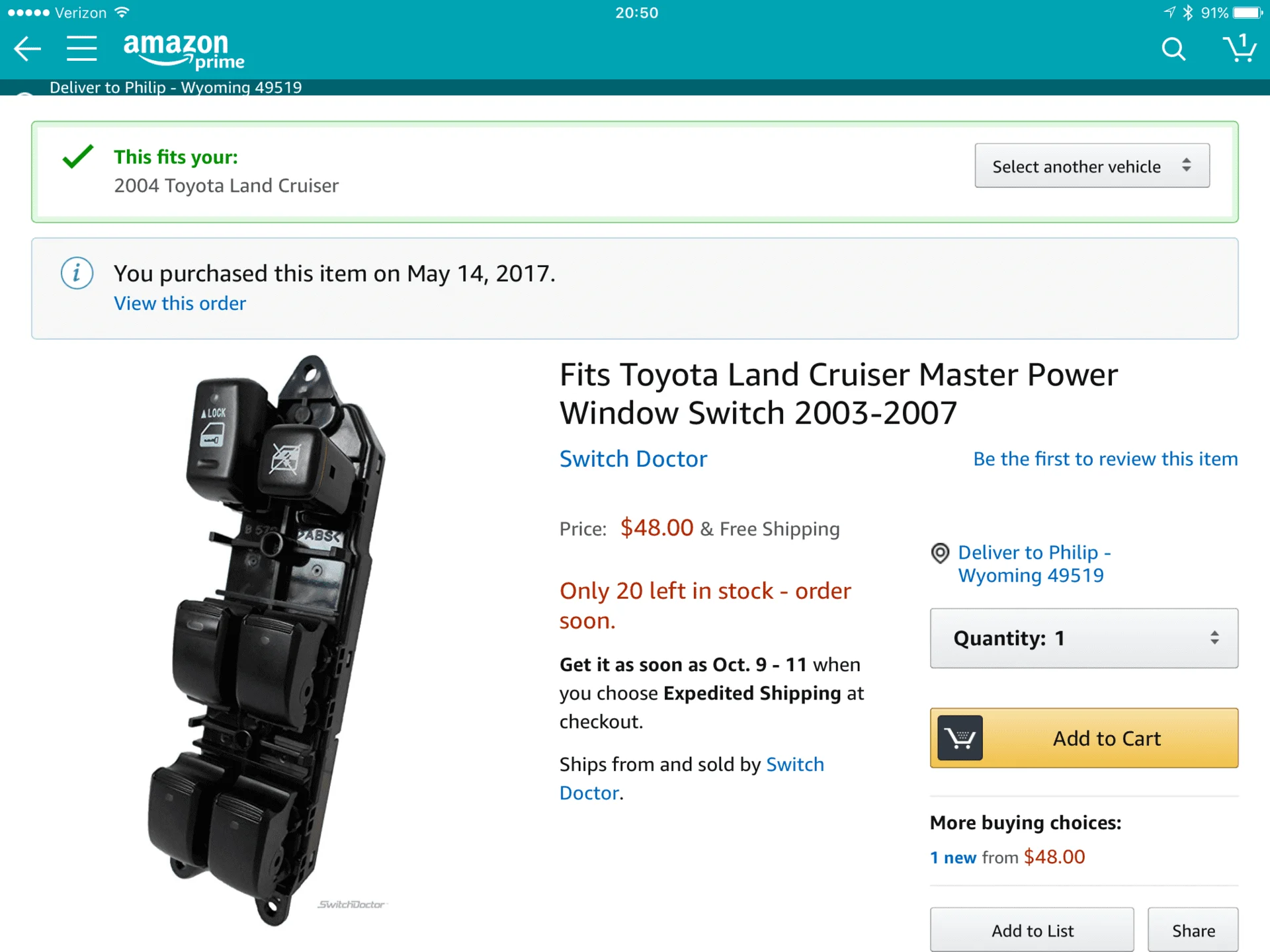

I'll try to get pics. I won't see the car until Thanksgiving, and will be doing new (rebuilt used) window switch assembly, Camry lock actuator, and new wiring harness, so I won't be able to tell you what actually fixed what. I'm shotgunning it all while I'm in there.
I hope all goes well with that project. Nice thing is, there is great help in this forum. Looking forward to your posts!
I also got my rebuild from Switch Doctor (straight from them, not Amazon). Mine is a 1998, cost was $88.
