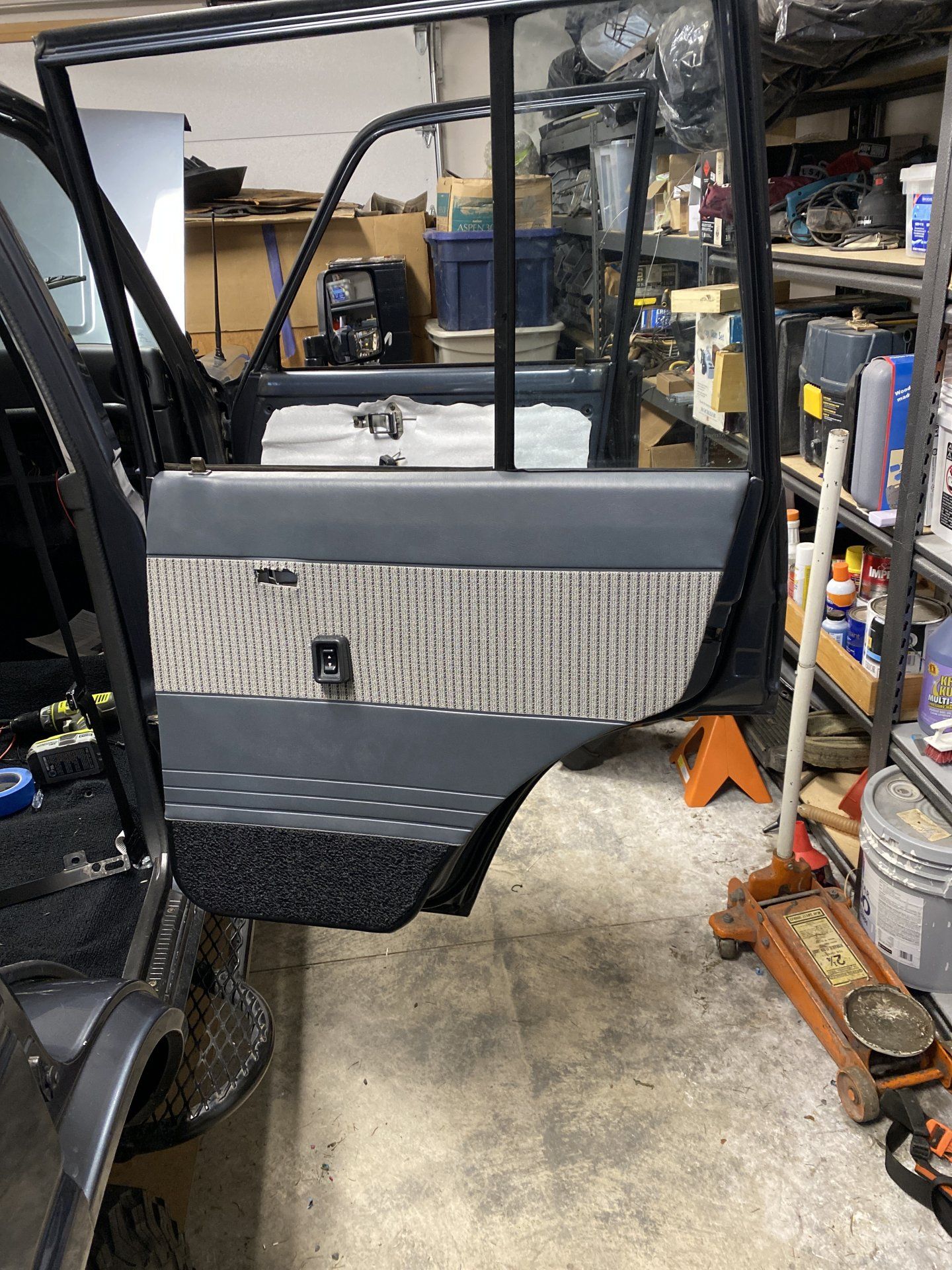

I’ve decided to rip out the 1/4” butyl seal and replace with 1/8”. Wish me luck. I’ll post results
That worked! More is not always better. Still have some trimming to do and the armrest, but I’d call it a win for today!
