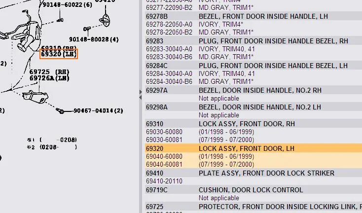

has anybody found a source for the whole actuator? I broke the plastic shell and the lock only locks, but doesn't unlock. I have found it here... but as part of the lock assembly # 69030-60081 $243.09 at website, ToyotaPartSales.com

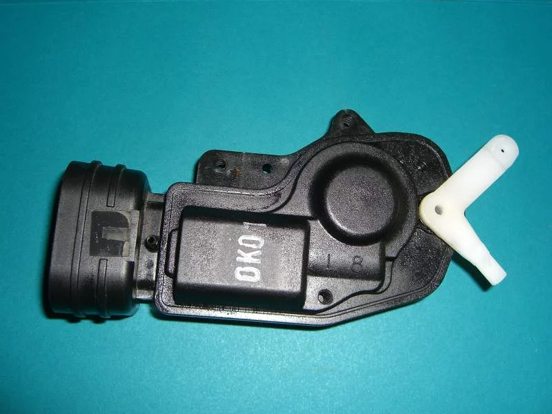

Has anyone found a source for just the actuator itself (see pictured....no part number I can find)
thanks for any help.
It's called out as the whole assembly, same part # you posted, on the parts diagram.
thanks, oh well, here goes $240 bucks for a $10 piece of plastic I need.....

just finished the driver's door, took about two hours. removing the brass connecting rods required gently releasing the pink and white plastic clips that act as guides.
as mentioned, you need to re-fasten the black bezel around the motor or the play will allow the motor to "freewheel". i just applied superglue.

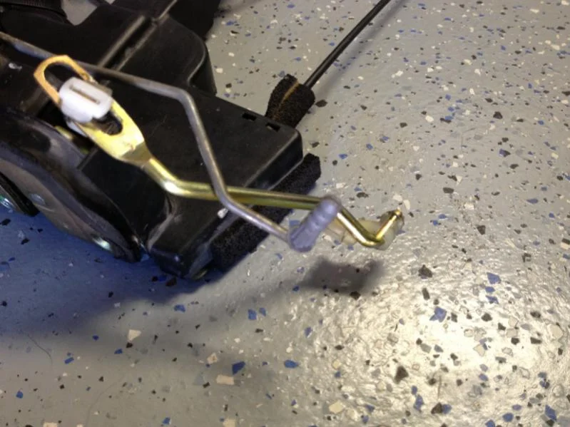

I tackled this today on drivers door. I broke the yellow clip, but was able to use an old wall anchor bolt to retain the metal. It clipped right into the hole.
Nice, always like when a fix like that is found.

This is a very good long thread and I used it as a guide & replaced the motor of the door lock actuator / driver's side (1999 LX470) at 132,000 miles for $5 (4 motors for $20 at eBay shipped)... I used hair dryer for 5 minutes to loosen up the old glue... then used 'superglue' to put them together... 30 minutes later after installing it on the door, actuator did not work... somehow, I unwittingly dropped a piece of the metal part (when I opened the actuator) that drives the white plastic wheels & found it in the tool bin... I was afraid I won't be able to pry out the actuator after using superglue and the hair dryer did its charm... I put back the metal part & door lock actuator is working fine now. thank you guys for all the postings!
I have read thru this thread. If I understand correct, the consensus is to use superglue to hold the black clamshell halves together after replacing the actuator motor. Has anyone tried small bolts and nuts? (Or did I miss it somewhere?)
Edit; I now see why. Best is to oven-cook the black thingy for 5-10 minutes at about 300. Pry it apart. Once the motor is re-installed, glue it back together w/ super glue. Mine went well until I broke one of the tabs that has a screw hole in it. DISASTER!!
Now the whole thing is fouled, because the relative position of the black thingy to the metal part that it is attached to is IMPORTANT!! I wrapped the whole mess with copper wire to hold it all together. I re-assmebled it all. What a Rube Goldberg operation! It looked goofy, but it works.
