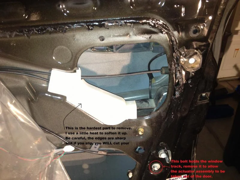

Since I've done this a few times on a few different 100's, I'll add some tricks that will make this easier.
-To keep track of all the different screws and bolts you have to remove, draw a picture of the door panel on a sheet of paper. When you remove a screw, mark on the paper where it came from and push the screw through the paper to hold it. EASY!
Typo in the pic, you get the idea.... don't cut your hand.

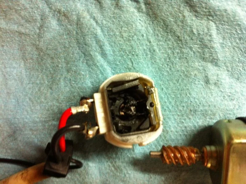

So I read through this entire 13 page thread. Buried a few pages back was a post by "ubiquityman" who had success by taking apart the small motor and cleaning it. Since I didn't have a new motor on hand and I'm not even sure which one to order for the 80 series and I'm not as talented as "cartercd" to weld a nail to the end of a motor shaft, I figured I would give it a shot.
It seems to have worked. After 2 years of classic symtoms, the lock is working great now. It appears that grease and crud had collected itself onto the commutators and brushes of the armature. With a little WD40, paper towel and a small screw driver I was able to clean it up substantially. Here are some before and after pictures to help you if you want to try it yourself. Note all the grease/crud on the paper towel in the background. I'm definitely gonna go this route on the other locks as they have issues. If I find one where the brushes are too wore out, then I'll try ordering another motor. I hope this info helps...

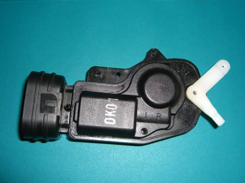

I had the normal symptoms of a door lock actuator gone bad (many threads on this) so I went about investigating this issue over the weekend. I was hoping I could find something that could be remedied by a little bit of cleaning / maintenance, but that wasn't the case.
Removal of the door trim wasn't bad, but getting the door lock assembly out was a bit of a pain (kept getting my arm hair stuck in the tar-like adhesive for the plastic sheeting). Once I got the lock assembly out, I detached the actuator (held on by 3 screws). The actuator itself is not a solenoid as some other threads state. I popped off the cover.....it is actually a small DC motor.
Actuator:
Actuator exploded:
I plugged in the actuator (without the cover and not attached to the lock assembly) to the electrical connector and operated the door lock switch. I could see the motor spinning strongly the first few presses of the switch, but then it would slowly die down. I tried cleaning all the contacts / moving parts, but nothing improved. Since I realized I had to replace the motor, I decided to take it apart and investigate. I immediately saw that the graphite brushes were almost completely disintegrated....not sure if this was the only problem.
So, in an ideal world I could just replace this little $8 hobby motor. The really unfortunate thing is that not even the actuator itself is sold by itself. I tried every avenue for parts searching and can only find the actuator sold with the entire lock assembly (lock mechanism, cables, actuator). This is really annoying since the actuator is a separate component and bolts (screws) on to the assembly. I didn't want to go the junk yard route since who knows how long the used actuator would last.
So I did find the lock assembly cheapest on CruiserParts.net for $169. I called my Lexus dealership to get a price on the assembly just for my own edification. They sell the assembly for $330 and would probably charge $500 total for them to do the job.
A few cents worth of graphite in the brushes of a motor results in a potential $500 repair.
If anyone ever finds a way of just buying the actuator and not the whole assembly, I would love to hear how you did it.
you can buy the motor from mabuchi motors for under $10 since you have it a part. you will have to do a few measurements to confirm the shaft length and case size.

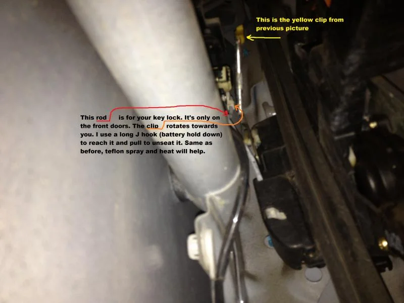

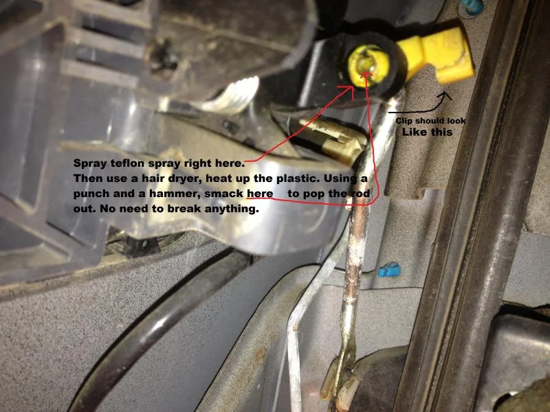

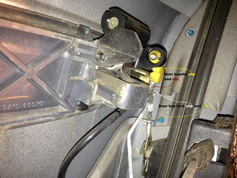

I just replaced all five actuators on my 100 and wanted to share a tip. The hardest part for me was getting the "door handle" rod to separate from the yellow connector. After using a hammer and punch on the first three with limited success, I tried a different approach.
I sprayed the plastic and rod with penetrating oil and let it sit for a few minutes. I then used a spring loaded punch instead of the hammer and punch. I placed the punch right on the end of the rod.
2Q==
On the passengers side it popped out on the first punch. It took two tries on the drivers side.
Thanks to everyone who contributed to this thread and especially JonHarris for supplying the motors.
I lassoed the yellow clip with fishing line and pulled it
