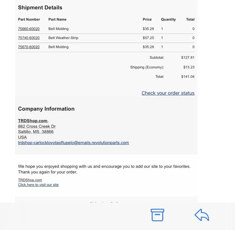

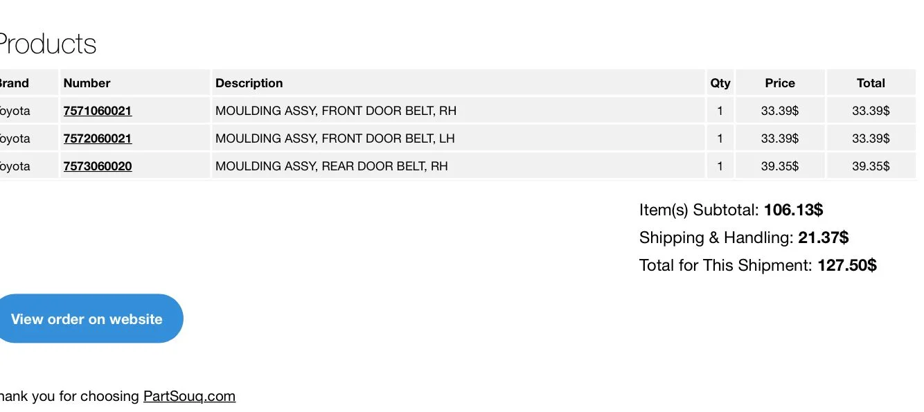

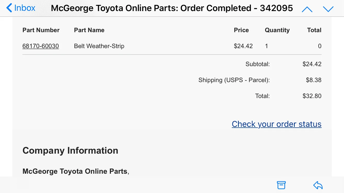

Mine's a 96 as well. This all comes to $661 at Norwalk. Anyone find a significantly better deal? Thanks
