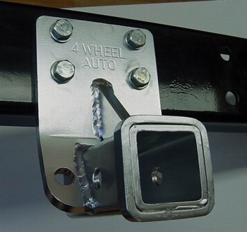

http://www.4wheelauto.com/shop/productdetail?id=125376
Fourwheel Auto is a Canadian Supplier of landcruiser items. Mostly services the JDM market - not affiliated
