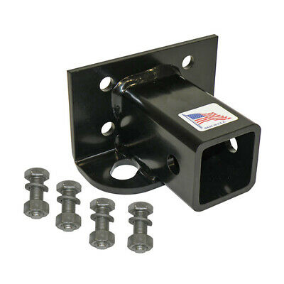

I got this one from Cruiser Outfitters. It's not listed on their website, I just called and asked if they had anything that might work for me. I have towed a dual axle trailer full of construction debris to the dump (probably near the 5,000 lb. tow limit for the 80), and a lighter camper many many miles. I have also bashed it on the rocks quite a bit. No issues :)

Wow that one looks great. I have been dragging my feet on figuring out a bike rack but this would be perfect.
@cruiseroutfit if you have these I definitely need one. Not for towing but needed for a bike rack. This is an awesome option and I bet a bunch of folks would jump on it.

Did you have to modify the mounting holes or rear X member?
The cross member holes on the LX are covered in plastic. I had already removed all of that in preparation for a Delta rear bumper. The hitch bolts right up with no mods to the LX.
Two of the cross member holes are threaded and two are not. You will need suitable hardware.
