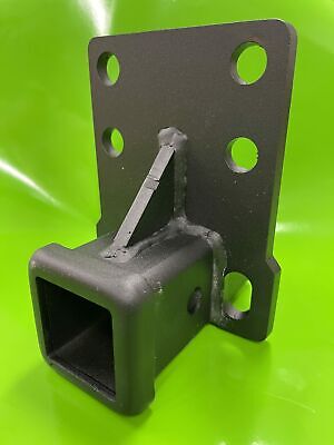

The hitch comes with traingulated reinforcement for under the truck. I would say it is plenty strong for anything someone would want to tow with an 80 series.
Does it interfere with the spare tire and what does the "triangulated reinforcement" look like? This is the exact solution I am looking for but not sure about the $195 price tag.
Does anyone know what size bolts (thread and length) goes in the threaded holes?
I bought Toyota ones for the 100 series. They use torx socket and are black for super stealth.
Out of the box no, you can not use the spare tire carrier. I know of at least one person who modified it where he could though.
I could post a pic or two tonight. Try a search for user name "VanGo". I thick he posted pics of his modified version. What's funny is returned it back to "stock" and I bought it from him.

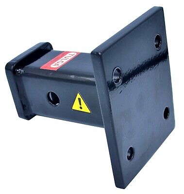

I see a few options for this:
Slee says that theirs is meant for their bumper.
Manafre says it's class 2 and meant for 2,000lbs. Is the rating definitely lower than the dedicated hitch? I'm just finding it very easy to drag. Not totally sure if these would be any higher. Ideally, maybe it could stick straight out from the bolted area.
Would this work?
Edit: Another option, for bumper mount: Curt Pintle Hook & 2" Ball Combo Trailer Hitch w Mounting Hardware 48190 | eBay - https://www.ebay.com/itm/164618184484?hash=item2654022724:g:PBcAAOSwJB1f7jNP
