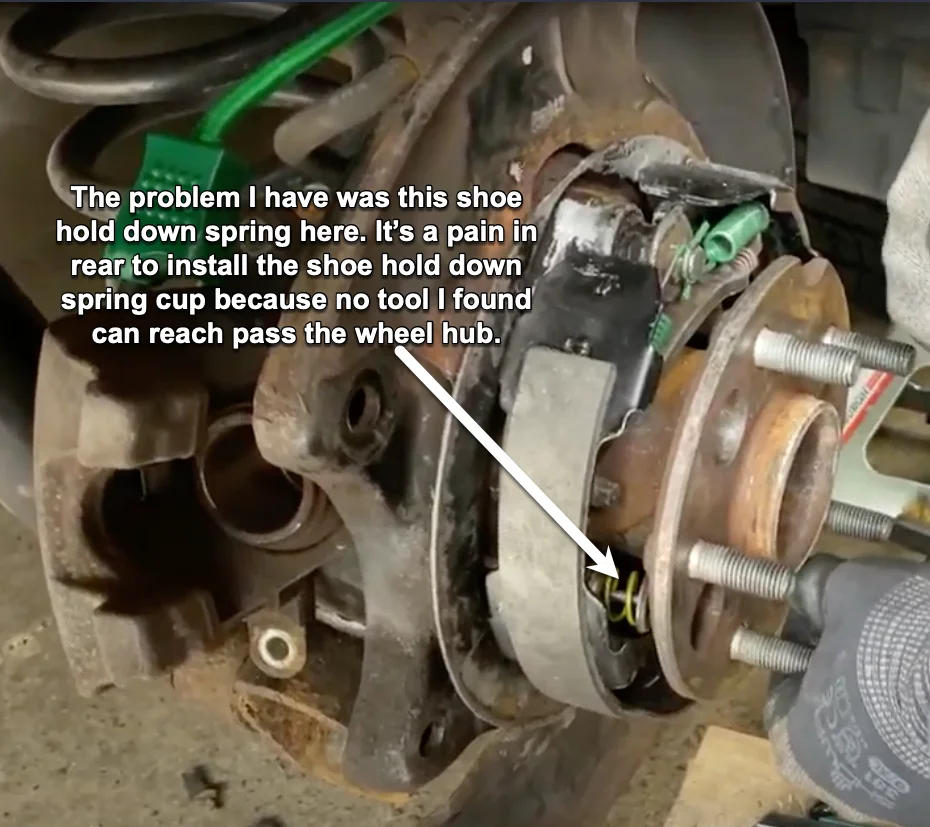

I have a 2014 LX 570. I may need to replace the rear rotors. I've replaced my 2007 Sienna van's rear rotors and replacing the rear shoe brake (e-brake) is a pain especially when it's my first time doing it. I wonder if the LX 570 have similar e-brake in the rear rotors.
yes, drum ebrakes on the rear
Does the LX 570 rear drum look similar to this? This is from my 2007 Sienna. Thank you.
Yes, and you can get a special tool made for removing and installing those cup washers from any Autozone or similar parts store. The one I have looks like a screwdriver with a circular attachment on the end.
I already have a tool like that with one end size small and the other end larger. The issue it's either too big to fit through the hole in the wheel hub or too small to cover the spring hold down cup.

Re: tool - get another tool. Right tool for the right job. Tools are cheap these days.

Also, had the same issue with the brake shoe retainer spring. I couldn't get me tool straight onto the spring hat b/c of the hub. My shoes weren't shot so I just opted to keep them and replace everything else.

@Charlielj the rear brakes on a 200 aren't nearly as compact as in the pictures. There is plenty of room to use the tool, in fact there isn't even a hole in the hub face for it, it can be accessed to the side of the hub face.
