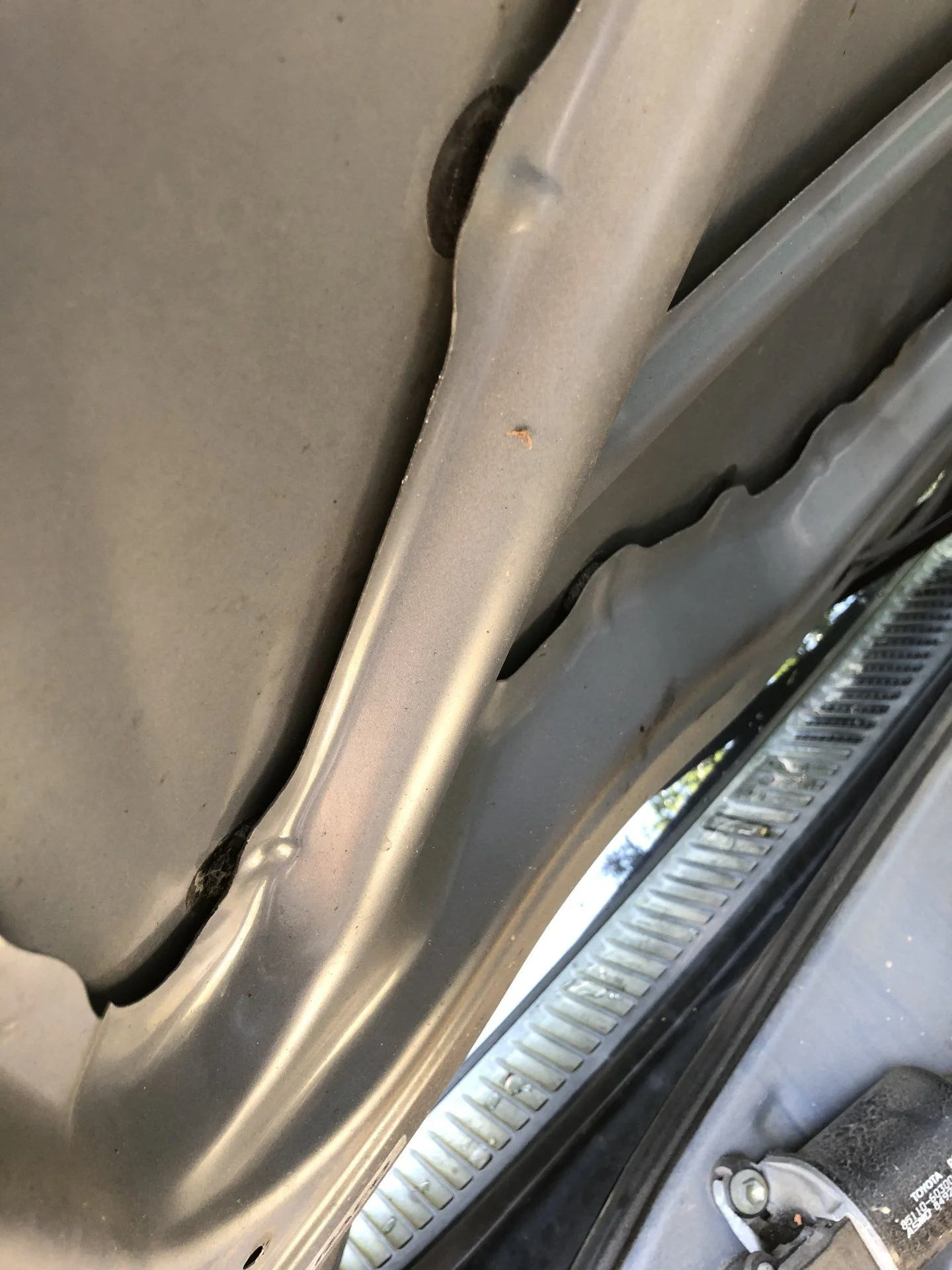

Does anyone else’s hood pop in and out like this?

This usually happens at interstate speeds when a storm is approaching and the pressure changes. FWIW it’s the original ARACO hood with the VIN stamp, not a cheap replacement like I suspected at first.

Nope, mine has never done that. Perhaps remove the hood insulation and see if the hood's skin has detached from the bracing?
It shouldn't Tin-Can like that.

I started to do that but was breaking every clip and gave up. Maybe I need to take another look....such a bizarre problem
My 80s hood did that. It was the bracing separating. There are some threads about it in 80s tech.
Was going to suggest adjusting the rubber bumpers under the hood then looked at the video again.
Yikes! I haven't seen it on mine but based on @ga12r1's comment, maybe try punching the skin from the underside to see if it moves much? Was that just some kind of mastic used to keep the skin on the crossbracing?
Y’all were right, once I removed the liner it was obvious that most of the adhesive “dots” have completely let go. I’m picking up some of the adhesive recommended in the 80 forum and will report back.
Yowza....! You definitely found the problem.
Yes, please report back when you are done. It will be interesting to see how you fix it. Write down any part numbers you might use as well...please (insulation clips, etc).

This is what I’m about to try. Similar to a product recommended in the 80 forum
