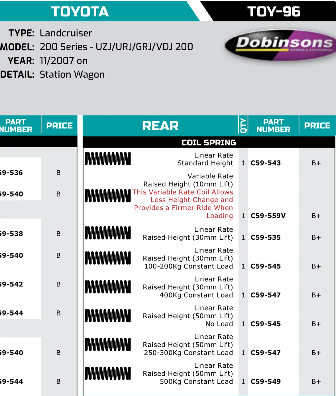

I have the C59-535 coils installed but gave me more lift than I was planning on. Would like to swap for the c59-559V if anyone is interested. Or purchase if anyone’s pulled any off. Located in Austin, TX.
I had to look up the info on these. I assume these are similar to OME 2723 coils and you want progressive springs. If you can find info on the spring rate, number of wraps, etc it might be possible to pick another spring from a different vendor as well, which would give you more swapping options. FWIW I have a set of tough dog rears sitting in my garage I’d be happy to send you… they’re 240#/in and were no more than a 2” lift.
Thanks. I’m not particularly fixated on progressive coils. Just need less rear lift to improve rake. This was the same spec sheet I used when ordering but the C59-535 ended up being a lot more than 30mm. The dobinsonusa website now has them at 75mm with stock load and 50mm with 100kg constant load.
