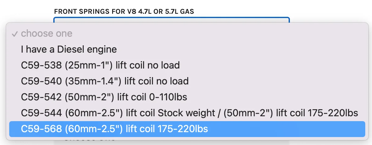

So here are the questions. 1st really just trying to figure out spring weight
Front spring options:
568's sound like the winner here with my heavy bullbar/winch up front. This is also what the shop doing the install suggested, as well as Ozark Overland Outfitters in a breif phone conversation.

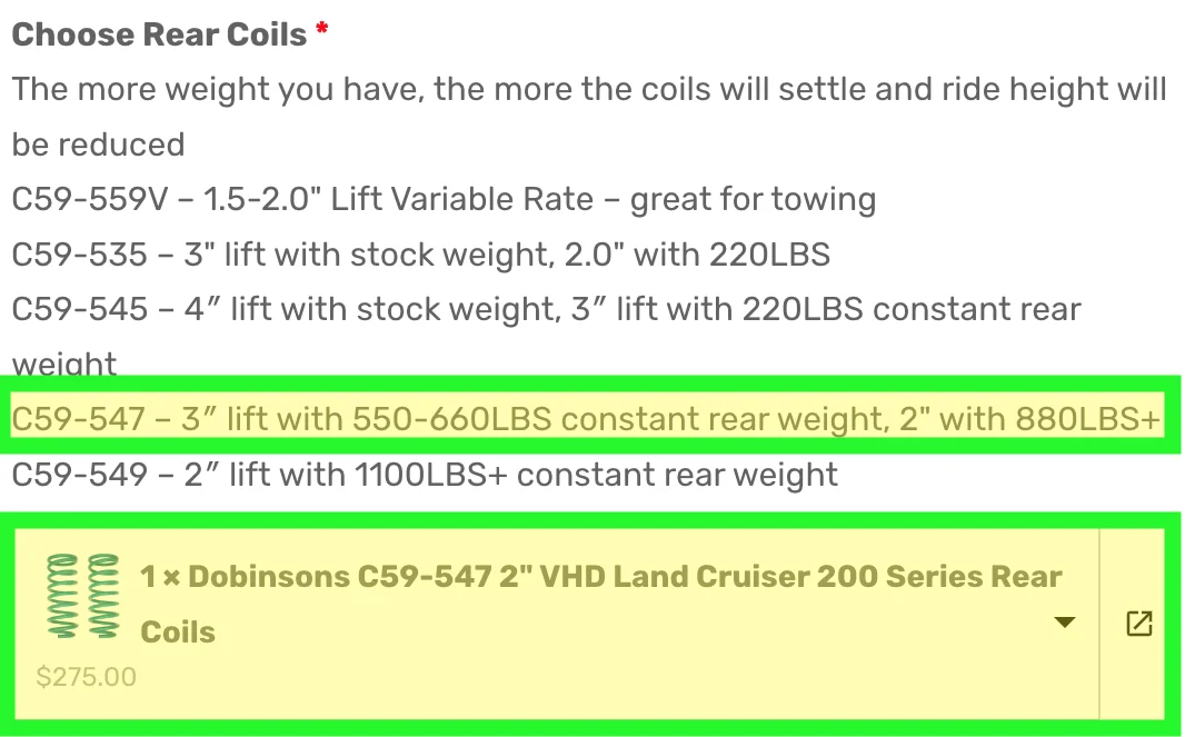

Rear spring options:
Unsure on this between the 547's and the 549's. 2 shops I asked, each gave a different answer. Steel Bumper, 3 jerry cans, very filled drawers, dog, fridge, Turtleback trailer, heavy tent/awning. Just not sure if the 1100lb 549's are gonna be too much around town. I do have Firestone airbags for towing. Thoughts? I'm leaning towards the heavier option.

Personally I'd lean towards the 547's, I'd rather make up for a few extra possible pounds with the bags then to be over sprung and have a crappier ride. I will go black springs when I order but I can see the appeal for some to get the teal, red wouldn't even be considered in my eyes.

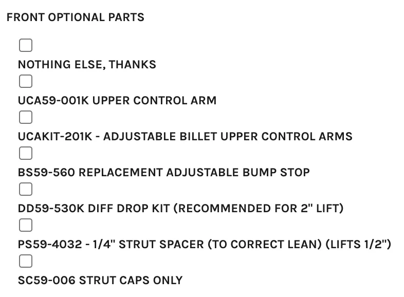

Front Optional Parts:
I still have stock front UCA's, so those def need an upgrade. The billet arms are out of stock for an undetermined amount of time. Both shops I asked said the regular (UCA59-001K UPPER CONTROL ARM) are a winner. Supposedly they come pre-adjusted for this lift, meaning they aren't adjustable like the Billet or something like SPC.
I wasn't planning to do anything else besides the SC59-006 STRUT CAPS.
Not sure if anybody has thoughts on the (PS59-4032 - 1/4" STRUT SPACER (TO CORRECT LEAN) (LIFTS 1/2")?
I have no lean currently....but is this an issue I should be concerned with?

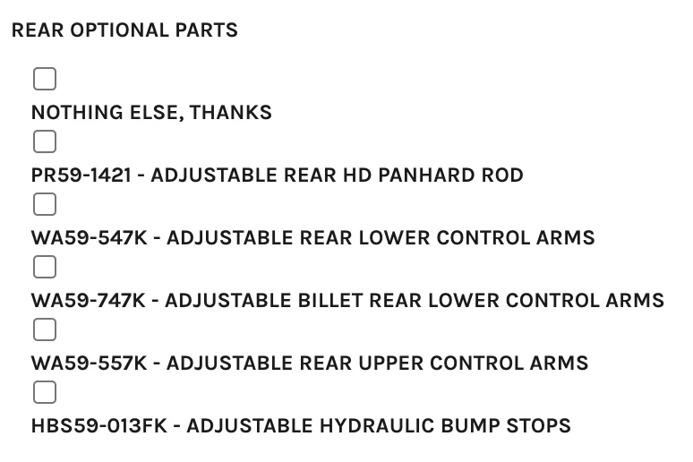

Rear Optional Parts:
My shop recommend the PR59-1421 - ADJUSTABLE REAR HD PANHARD ROD. I'm also planning to add new Firestone airbags because I think 1 of mine has a leak. Cheap enough to just replace and no extra labor while they are installing the springs anyways
Any winning argument or thoughts on the other optional parts here? They all add up $$$ so don't want to skimp, but also don't want unless I'll really benefit from any of this
WA59-547K - ADJUSTABLE REAR LOWER CONTROL ARMS
WA59-747K - ADJUSTABLE BILLET REAR LOWER CONTROL ARMS
WA59-557K - ADJUSTABLE REAR UPPER CONTROL ARMS
HBS59-013FK - ADJUSTABLE HYDRAULIC BUMP STOPS

Don't to a rear adjustable panhard. With all the recent threads on @eimkeith 's panhard relocation bracket, I'm surprised anyone is still considering an adjustable rod.
The rear UCAs/LCAs are overkill for a 2" lift. The main point of them is to be able to adjust the rear pinion angle if you have driveline vibes from a large lift, and/or push the rear axle further back. Not sure if the shops you are considering are giving you the best advice.
For tires, check out a 295/70/17. They are in between a 33 and 34, but pretty fat.
Skip the adjustable panhard and go with the EimKieth bracket, I wish it had been out before I bought the panhard bar or I would have skipped it.

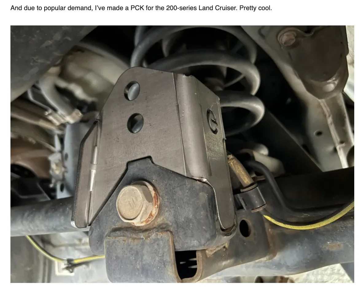

ok I skimmed through the 14 pages last night of the @eimkeith relocation thread:
Looks awesome, sold on that. So just to make sure I didn't miss anything here is the just I got from that thread.
• The eimkeith relocation bracket is INSTEAD of the adjustable rear HD panhard rod? This raises the panhard rod up to get closer to level angle.
. No real reason to ALSO do the adjustable rear HD panhard rod?
• Deciding which hole to mount on the bracket is based off the lift, ideally trying to achieve a 0-2% angle when the truck is flat on the ground?
• Re-use the factory bolt and nut? Or just re-use the factory bolt with the new supplied nut?
• 110lbs torque?
Am I missing anything? I didnt see any other 200 product offerings on the website but the Panhard Correction Kit sounds like a solid winner

That's pretty much it. Existing bolt uses captive nut and new nut is supplied so reuse existing bolt with new nut. For 2" lift, the middle hole is perfect (or lowest hole on new bracket). Install is easy, especially if you already have the rear coils out, which is necessary to access the rear of the bracket when welding.
Thanks, so this guy for a 2" lift right? And with that on flat ground the bar sits level, or angles up somewhere around 2%?

Front coils this is what I think I'll go with / C59-544:
Rear coils this is what I think I'll go with / C59-547: Should be better daily driver than the 549's, and my airbags can make up for the extra weight when towing like @Tex68w said

That's as far as I got today, so narrowing things down. Oh, I did order the @eimkeith 's panhard relocation bracket, And I will skip the Dobinsons Rear Adjustable Panhard Rod

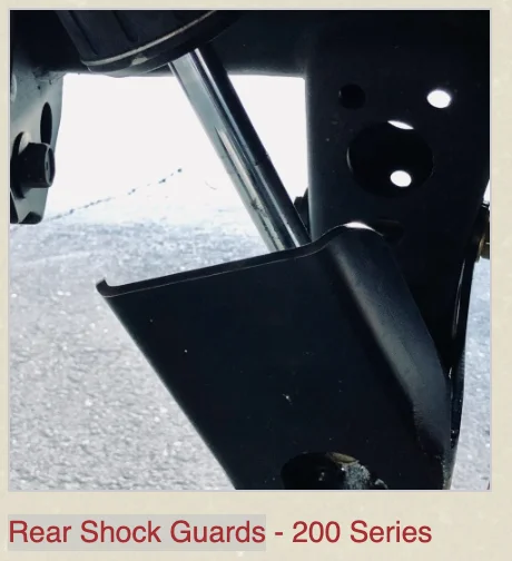

I already have Trail Tailor Rear Shock Guards installed:

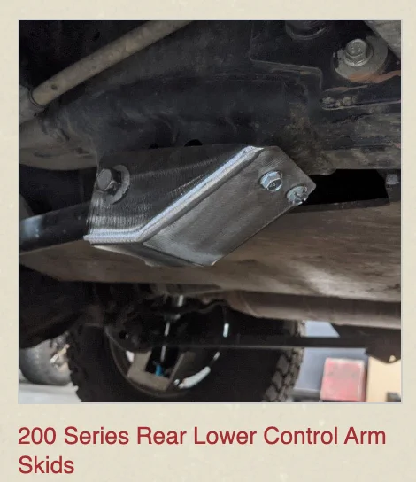

I held off buying the 200 Series Rear Lower Control Arm Skids, but was thinking now is the time:
Part of the reason I held out so long was I've been waiting for the no drill BudBuilt version to be available. I still don't see on their website.
Anybody have any info on these? @JohnJB , @Markuson @CharlieS have any
info?

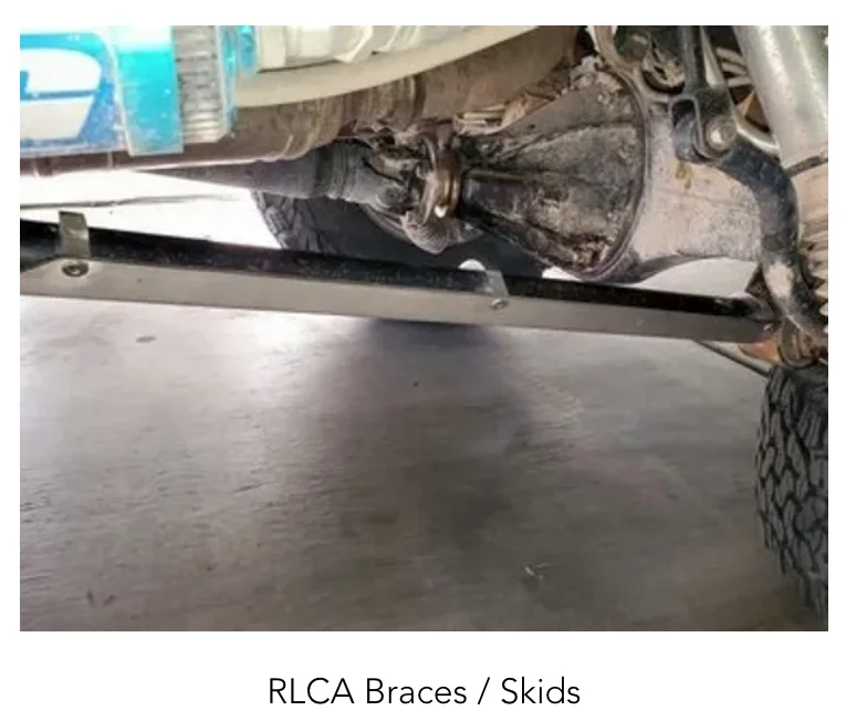

Then to toughen up the arms themselves I like the concept of the ee-offroading RLCA Braces / Skids

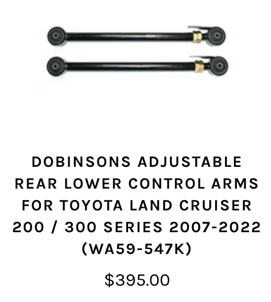

Or for $395 would I be better off going with the Dobinson Arms? Like would stock arms with the ee skid be tougher than the Dobinson arms alone?
Go with the braces from E-E over the aftermarket arms, better bushings and no noise with OEM. I still need to do shock and control arm guards from TT myself.
Yeah that was the option I was leaning towards. I like the idea of just armoring up the stock arms.
As far as the forward "Rear Lower Control Arm Skids"
You think I should go with the TT version....or try to hound BudBuilt if they ever made to production?
I tried to wait for Bud, but he never released them, so when Jason (Trail Tailor) offered his skids again, I snapped a set up immediately. They're great, just like all of his stuff. My only wish is that they were stainless steel, because rust is a major issue in my area. Budbuilt typically offers a stainless version of protection (with a slight upcharge).
I also have Budbuit lower shock guards (Stainless) and the @turbo8 /E-E RLCA skid. They both work well and provide needed protection. Thanks to the RLCA skids I'm not bending stock RLCAs anymore.
The only thing to watch out for is that the RLCA skids collect silt and dirt, I think mine is from going through mud several feet deep in sections. One more thing to keep clean as maintenance.
But... I'd probably only add this stuff if you play in the rocks and ledges. It comes with the territory wheeling any of the more challenging trails in VT/NH. They got good exercise on talus/scree fields in Colorado too.
I haven't had mine as long as @CharlieS so I haven't dealt with any sediment collection in the RLCA skids but I did drill some drain holes in front of the braces in order to help mitigate the issue.
