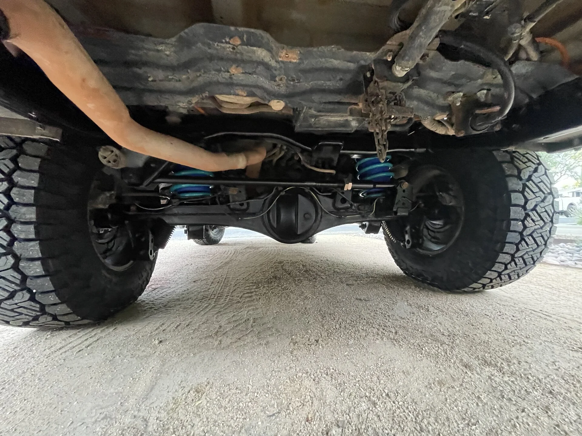

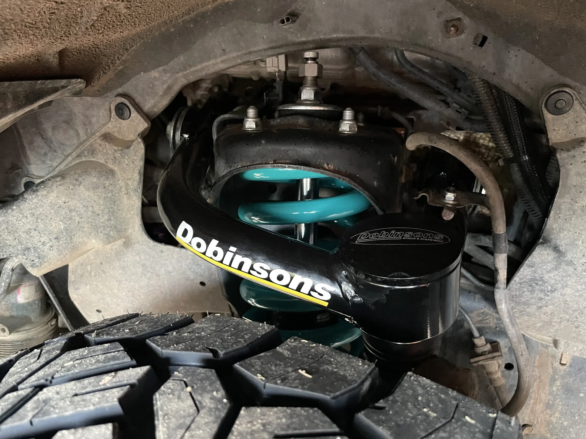

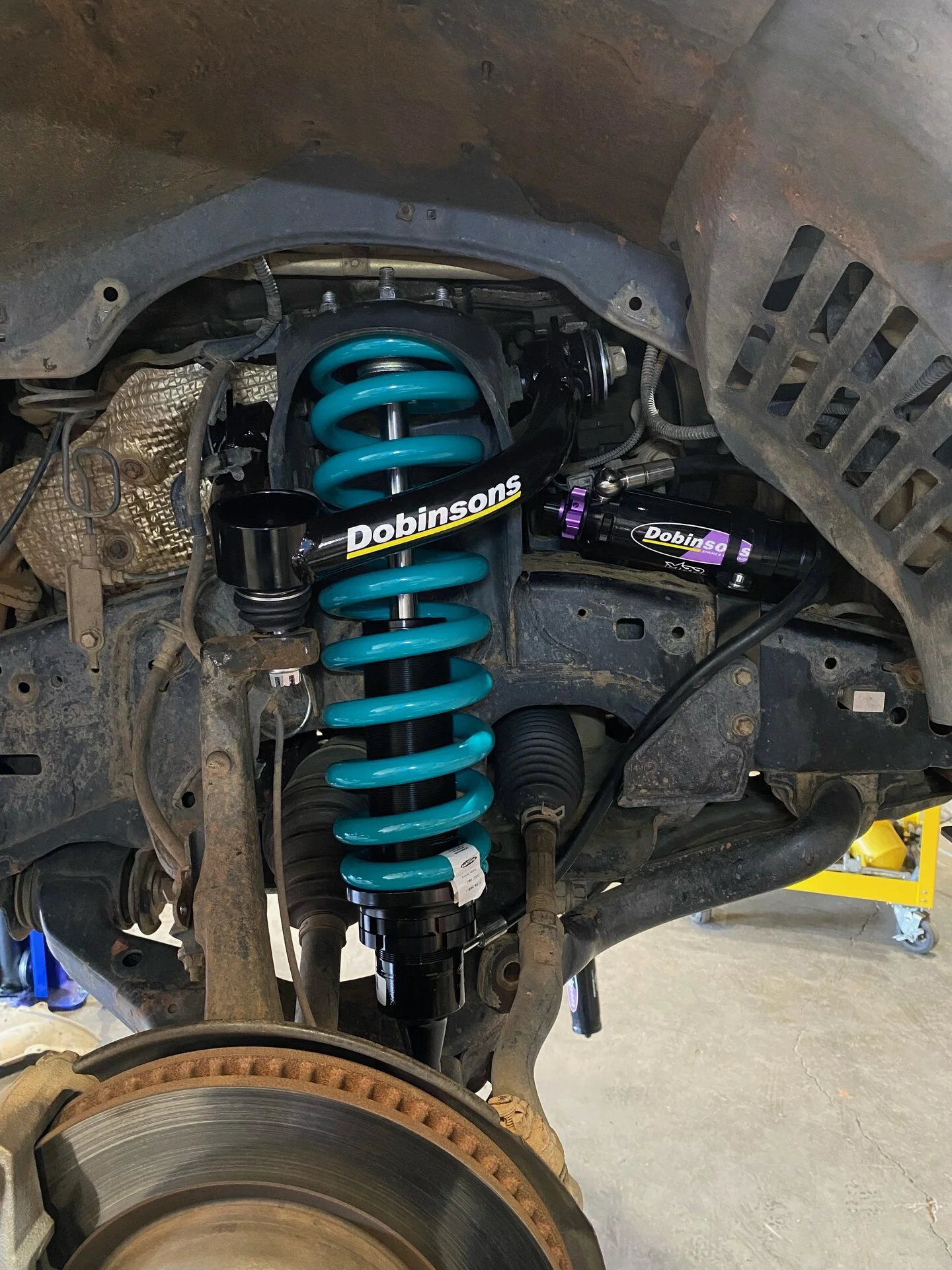

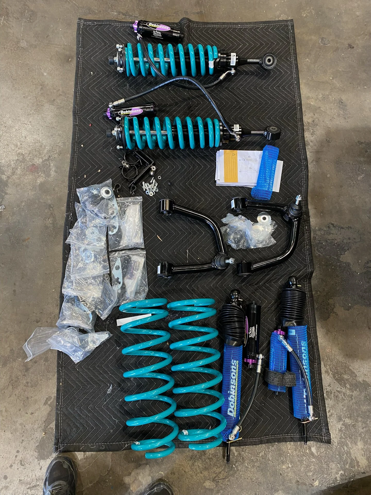

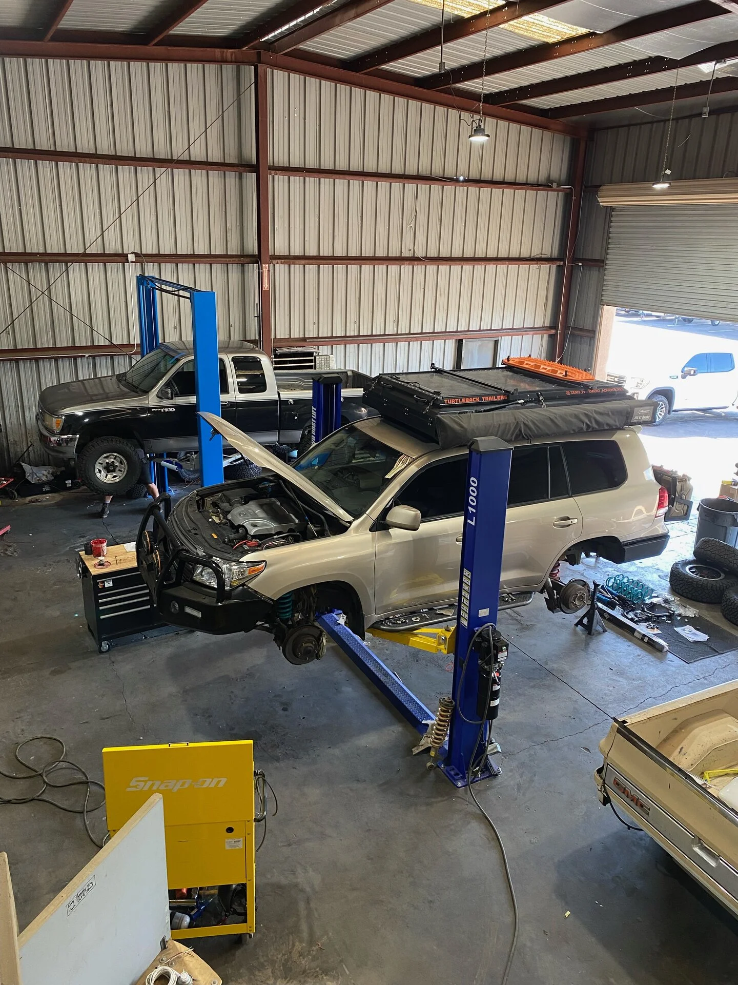

My truck is at the shop right now getting it all installed. I'm getting a few other things taken care of while its there, but hopefully end of this week or early next week I'll have it back. I'll post up pics and 1st impressions when i get it back. Here are a couple pics my tech sent today

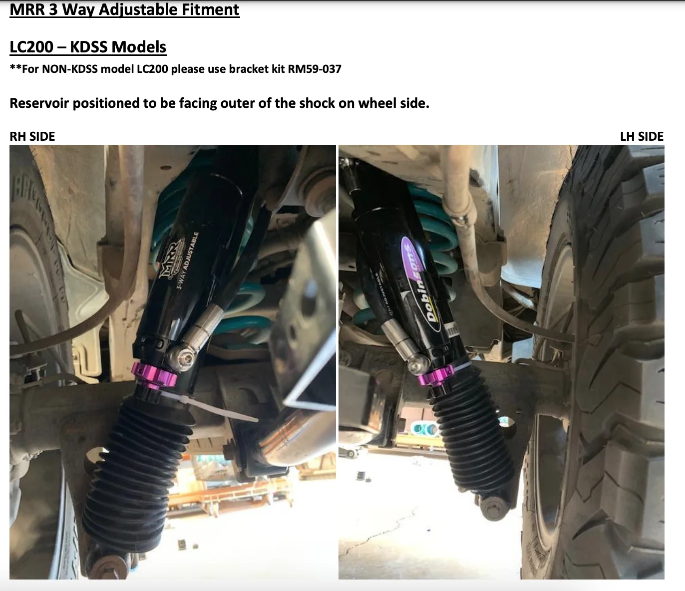

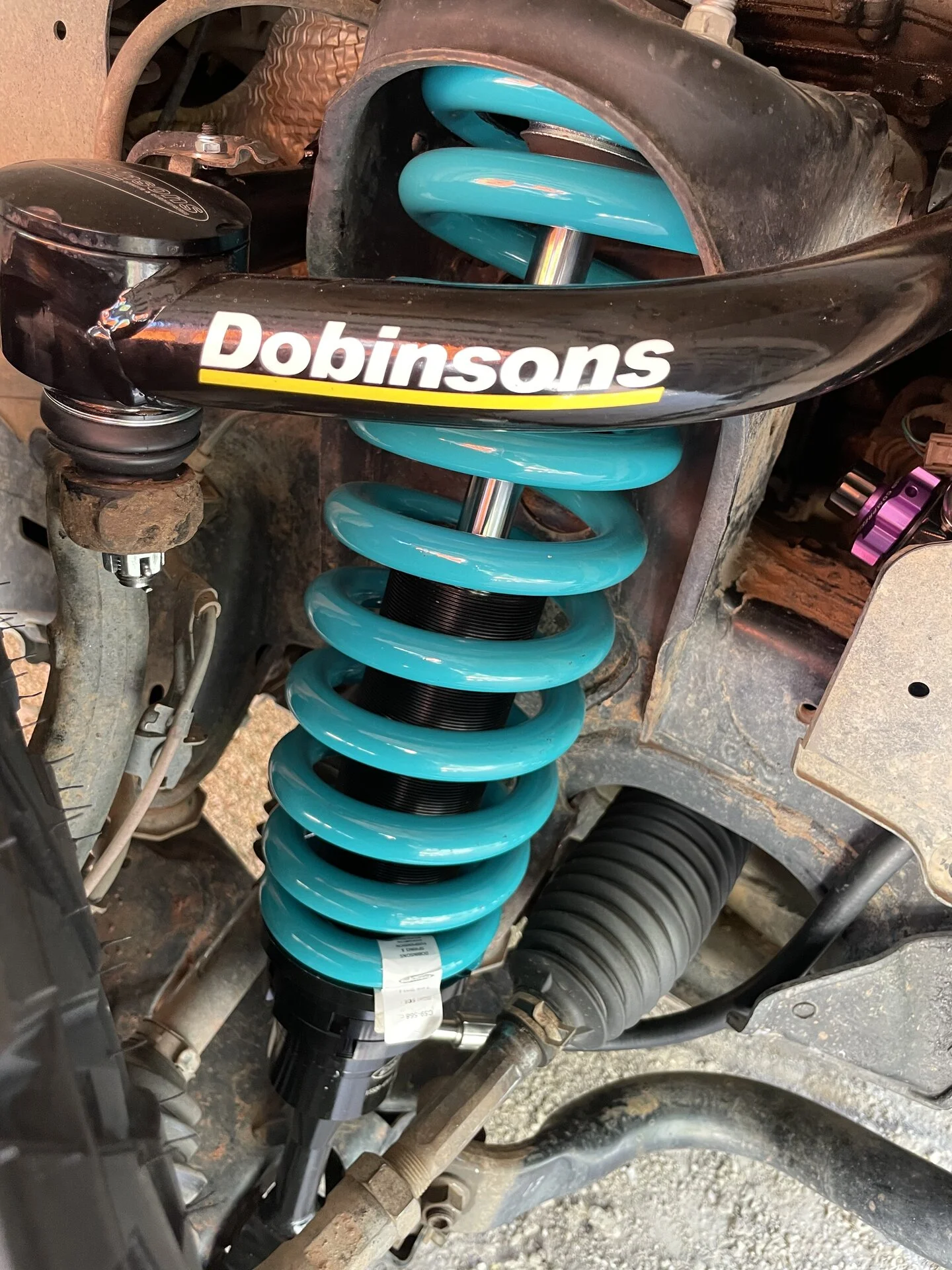

Anybody else with MRR suspension have lower shock guards? It looks like my Trail Tailor guards would not work with the Reservoir mounting spot.
Luckily the shop noticed the issue before trying to drive like this:
Here is a screen grab from the Dobinsons instruction manual:
Watching closely for future needs.
make sure the rebound adjustment screw is facing inward, it is a pain to adjust when it is between the shock and wheel.
Edit - for the rears
Where is the rebound adjuster on the rear? I haven't actually seen in person yet, these pics are just from my shop
Slightly above the bottom mount. The shock guard might be covering it too
Ah, I see. Thanks for the pic, that makes sense now. Nice it's just a screw adjustment. My tough dog's had some plastic adjustment knob which is a bad spot to have a delicate piece of plastic protruding. I like how this is flush/recessed
@crikeymike my install shop has since removed the shock guards completely. Sounds like 1 more reason the guards wouldn't work with my new suspension

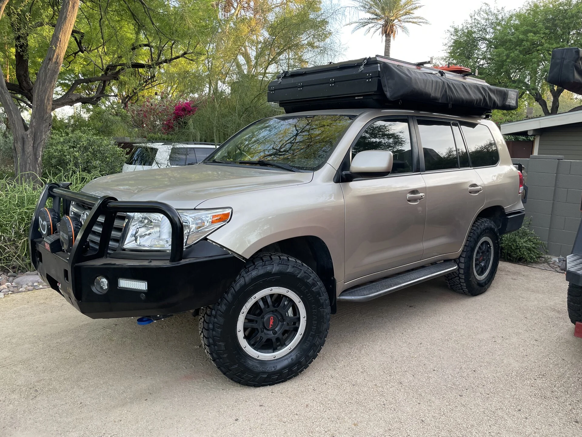

Got my truck back Friday and dropped it off at Discount Tire right after to get my new 34" Recon Grapplers. Haven't been on dirt, yet but just around town it feels like a V8 powered marshmallow. Massive change! So many creaks and shakes and rattles now just are no more. I'll update more when i get some miles on them but so far very happy. If anybody in AZ ever needs cruiser work done I can't say enough good things about Higgy's in Mesa. @Cruiserhiggs and his boys crushed it on the work!

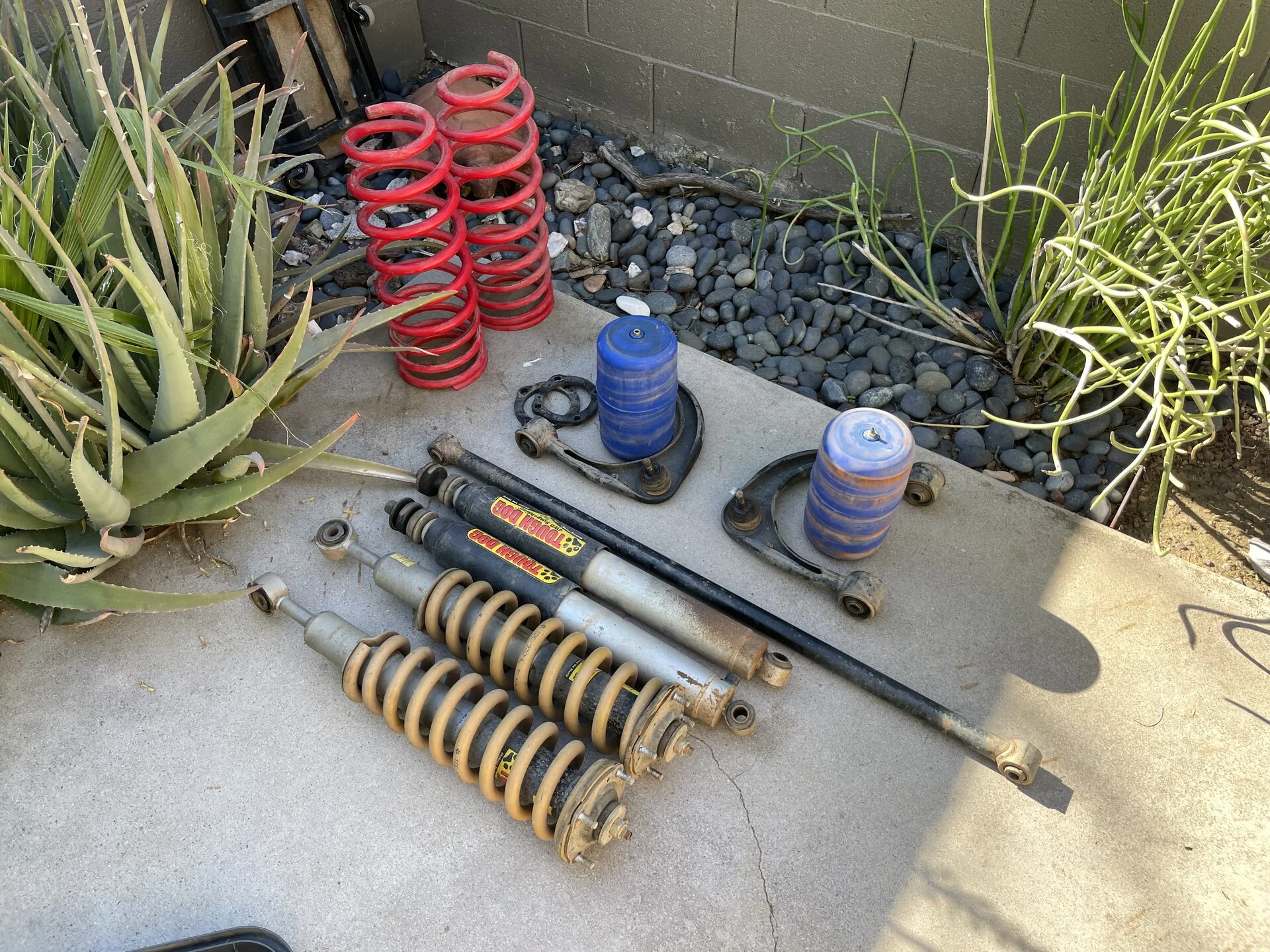

Day/night difference around town driving though, makes my 08 feel like a much newer truck. I was really surprised how much of the prior noise and rattling completely went away. My previous Tough Dog suspension was very good for years, but in its defense I was way over weight by the end of my build, so a lot of the poor performance was from that.

Nice, yeah I'd still recommend Tough Dog it held up great for years. My 1st quest was just to upgrade the front from a 41 to a 45, but that';s when I found out Jason can't get the anymore. So, figured that was a good excuse to upgrade everything. I've added a lotta weight since that initial lift. So off-road performance important to me, but man what a difference it made in my general enjoyment of the truck for the other 99% of the time Im driving pavement on DD duty. I did consider all the other options and the MRR def seamed like the best bang for my buck. Anyways, thx. Great looking color with the black accents on your 200.
