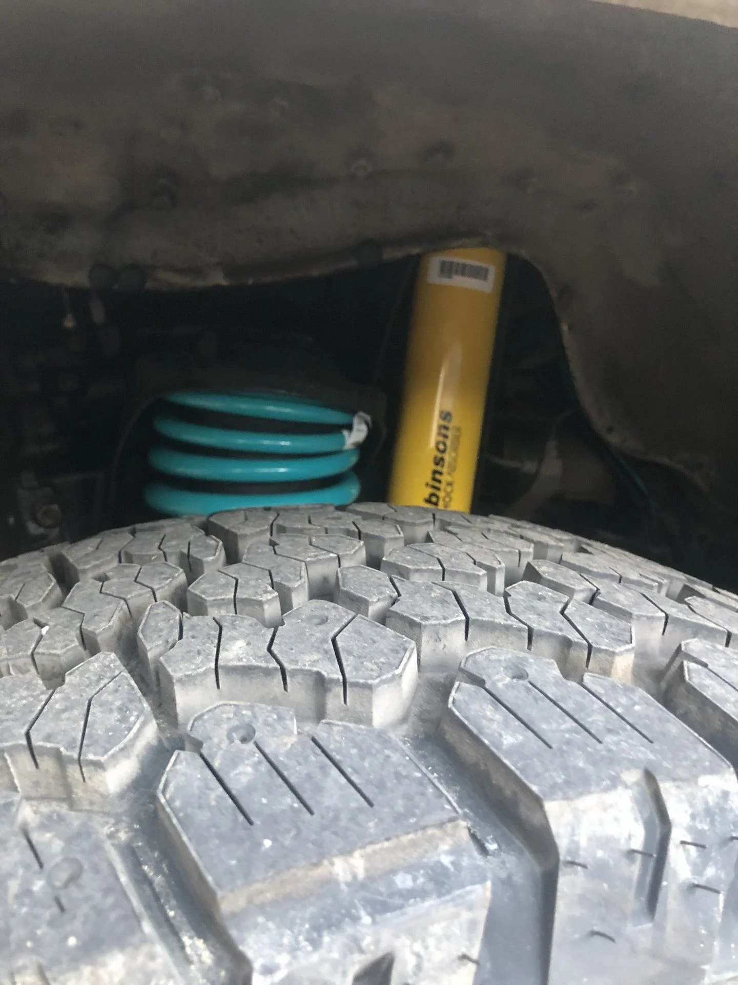

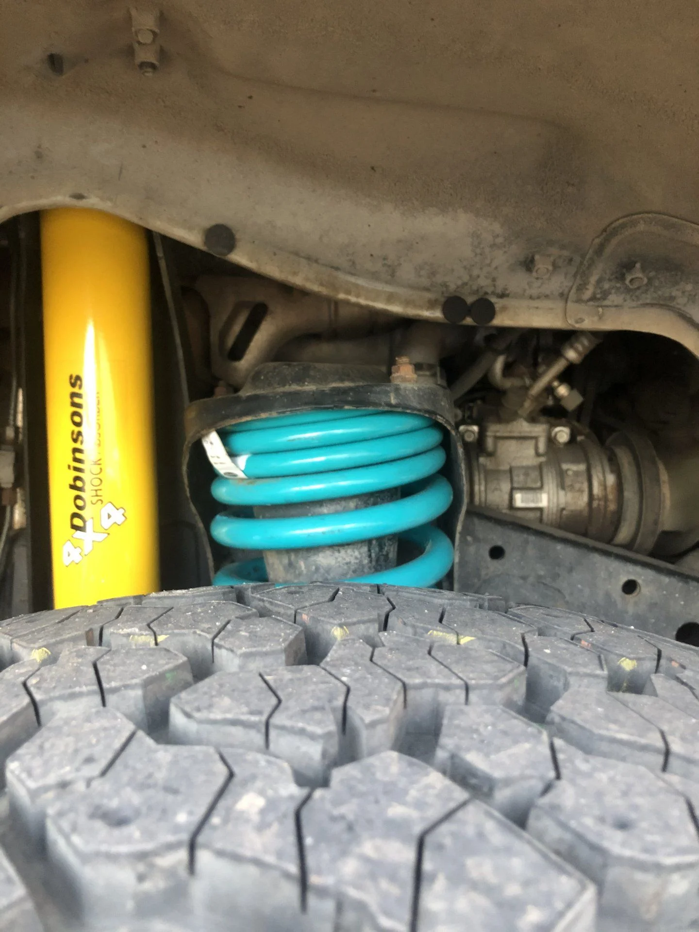

This is good to know. In your experience do these take a while to settle in? I measured this morning and I’m at about 4 1/4” of lift in the right front and about 3” of lift on the passenger. Also the initial rate on the right is completely compressed by the left side is not touching.
This is good to know. In your experience do these take a while to settle in? I measured this morning and I’m at about 4 1/4” of lift in the right front and about 3” of lift on the passenger. Also the initial rate on the right is completely compressed by the left side is not touching.View attachment 2515129View attachment 2515130
The driver side spring appears to be bowed much more that the passenger side. Given what you have there , it seems that your left side should be the side that’s taller. There should not be that much difference in lift from one side to the other. I’ve run OME heavies and Comp’s, Slee, and Dobinson springs and never had 1.25” of lean. If the taller two springs are on the left side you have a problem.
The left side is the bowed size and is 1.25” shorter than the right, which is why I’m so confused. I was going to switch the springs today and see if it tames the lean.

Springs are seated correctly in the lower perch? Strange they are bowed like that.
I just got home and double checked both sides, they’re in the bucket correctly. And the spring bowing doesn’t seem as bad in person as it does in the picture! I just doesn’t seem to be compressing the last winding of the initial rate
