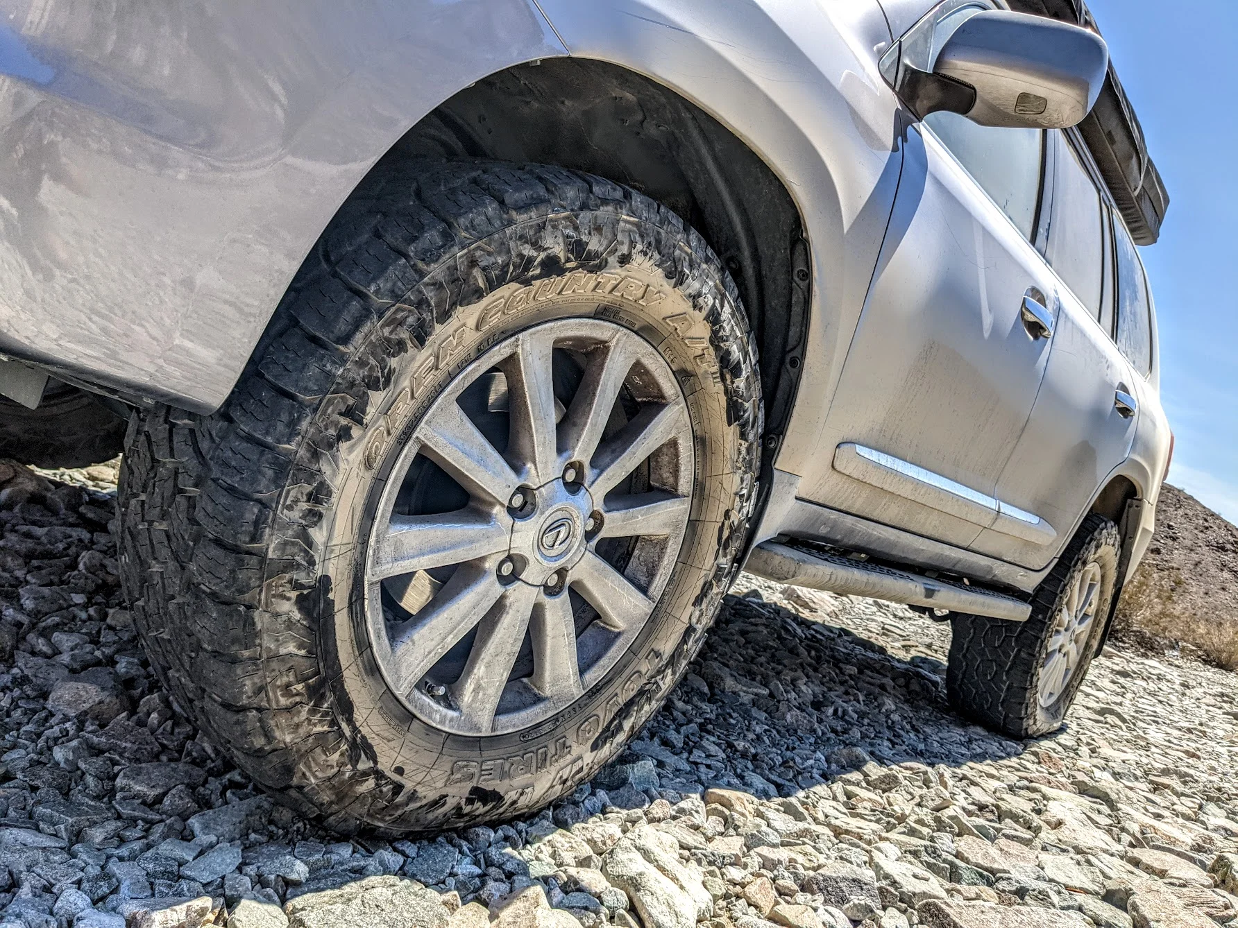

I was concerned too. But having driven Toyo ATIIIs many miles in areas filled with granite rocks and sharp edged quartz rocks around mines, they've proven durable and quite chip resistant. Perhaps a bit moreso than Falken AT3Ws in the same areas. My buddies with running KO2s also do great in environment.
Long story short, I have no qualms of ATIIIs holding their own against sharp rocks. Buddy running P-metric ATIIIs also did just fine.
Where I stopped here was probably the smoothest section of rocks in a wash near a mine, but you can see all the tire marks of rocks constantly working against the sidewall.
Those AT's have good side wall protection. What are you aired down to there?

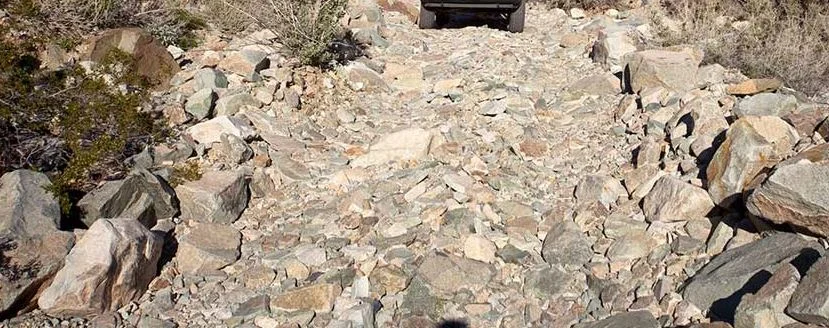

I meant when you get into the mountain trails.. and they look more like this.
Some AT's have good sidewall protection and some do not.

^I didn't get a picture of the really sharp mining roads we were on as we were too busy navigating. Rather was trying to show how all the loose rock wants to get at the sidewall.
