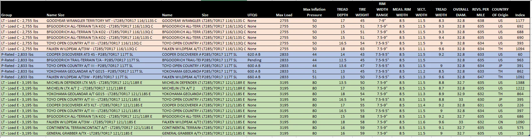

I pulled the following data from TireRack.com on tire specs for 285/70/17 options that I am considering. It's currently 21 items that fit into three groups:
  • LT C which has a load rating of 2,755 - I usually run 38-40 PSI
  • LT E which has a load rating of 3,195 - I think these would also be 38-40 psi
  • P Rated which has a load rating of 2,833 - I estimate these would be run at 33-36 psi?
Below is the data for each tire on my list, some are front runners, others are wild cards:
Spoken on this forum as gospel is that LT is "tougher" than P-rated and P-rated has no business off road. But the above data has me wondering if that is really so. The LT C group has the lowest max load of 2,755 and their speed rating is mostly Q (99 mph), compared to P rated which is 2,833 and T (118 MPH). Additionally, the Max PSI for LT C is 50, and a couple P-rated (Geolanders, Wildpeaks) beat that out with a 51 max PSI. It would seem by looking at this data, that the P-rated is tougher on the road side of the equation, while the LT C is tougher on the aired-down off-road side of the equation (inferred by the additional weight). Another consideration are compound and construction differences which can't be studied in the above data, but I have read here that the P-rated versions of many of the A/T above have more siping and better snow performing (due to more silica for example).

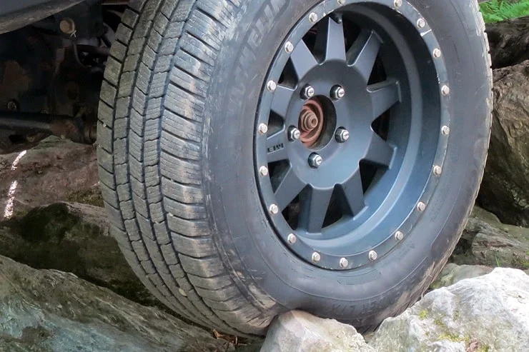

Easy!! Michelin Defender LT-E. 50 lbs per tire. Behind KO2, it probably has the strongest carcass of the other tires on your list. Great MPGs. Quiet. And did i say 50 lbs?! In LTE, it just 2-3 lbs more than your P-metrics above!
Can't argue with this analysis! It's up there on my list, I'm apprehensive about it's durabilty aired down and the load - e, will it ride like too firm?
I like where you are going with all this - nice compilation of data.
One note:
If you are evaluating based on published Load numbers, it is important to compare equivalent values; i.e. P-Metric Load values are not the same as LT-Metric Load numbers.
To make the numbers equivalent, it is your choice: either multiply the LT-Metric Load number by 1.1, or divide the P-Metric Load number by 1.1.
In the snip I took from your post above for example, if we make everything P-Metric equivalent Load numbers, then:
LT-C Max Load of 2,755 becomes (2755 x 1.1 = 3031) 3,031 P-Metric equivalent Max Load. This is higher than the 2,833 P-Metric Load you use as an example.
Conversely, if we make everything LT-Metric equivalent Load numbers, then:
P-Metric Max Load of 2,833 becomes (2833 / 1.1 = 2595) 2,595 LT-Metric equivalent Max Load. This is lower than the 2,755 LT-Metric Load used in your example.
So, bottom line, the examples you use show that LT-Metric has a higher Max Load than the P-Metric tires.

I did not know that, good stuff! But wow is that confusing for the laymen!
With some additional consideration, and input from you all, I think I'm sticking with LT rating and ruling out the P-rated option. The Yokohama Geolander was my top choice in that group, but I'm sticking with a LT.
