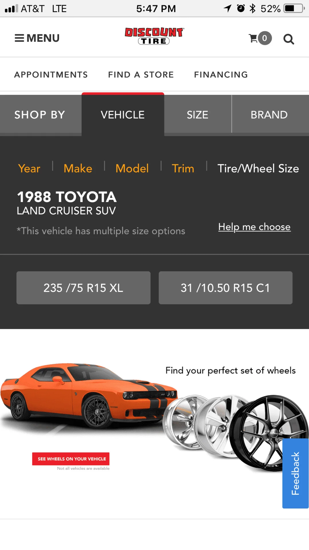

Yes. But a large tire chain (Discount Tire, Walmart etc.) will not install them as tire manufacturers recommend an 8” wide rim and yours are 6”.
A 10.5” wide tire is popular on OEM FJ-40 Land Cruiser wheels which are 5.5” wide.
Most small tire shops and/or 4x4 shops will install them for you.

Yes they do and discount tire mounted mine without any problems.
