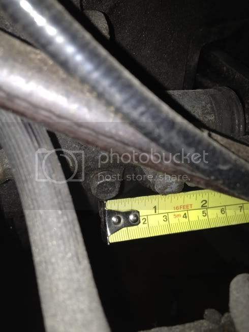

Here is what the slave cylinder looks like:
Looks to be about an inch and a quarter-ish center to center of the two 12mm's?
I hope it works out ok and I don't have to hunt for a rare bellhousing and slave cylinder!!

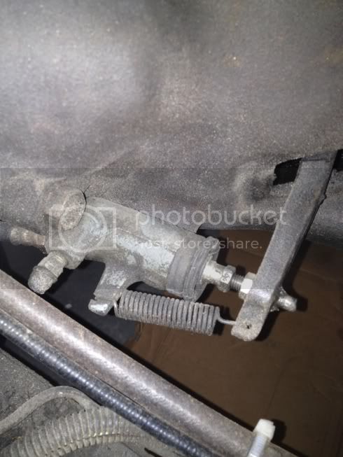

That looks like mine and I was told its for a 40
Sent from outer space via my mind
This is the BJ60 one that didn't fit mine
Yours looks exactly like mine, which is a BJ42. Looks like your going to have to weld your clutch fork or do what I did to prevent the push rod from extending too far out due to the puncture in the clutch fork. Based on another mud members fix I used an acorn nut on the end of the push rod where it cradled in the clutch fork hole. If you don't do this you'll end up unevenly wearing the slave cylinder, which will result in an early fail. I had to replace mine after only a few drives around the block.
hmmm - I am not sure I understand what you mean. Did you happen to take a picture of what you did?
I was told this 3B/Tranny/T-case setup came out of an 81 BJ60. Did the early BJ60's and 40's have the same bellhousing/slave?
Are you saying that when I push the clutch, as it is....the slave will extend too far? Thus - tack welding an acorn nut onto the end of the slave push-rod to get the same results without extending too far?
