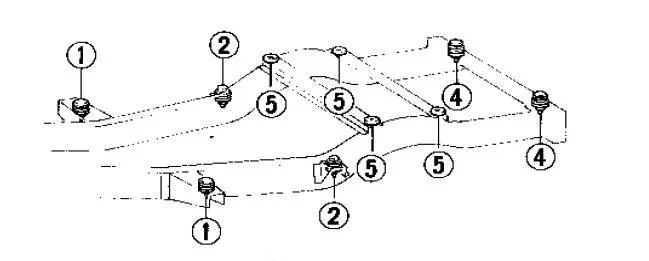

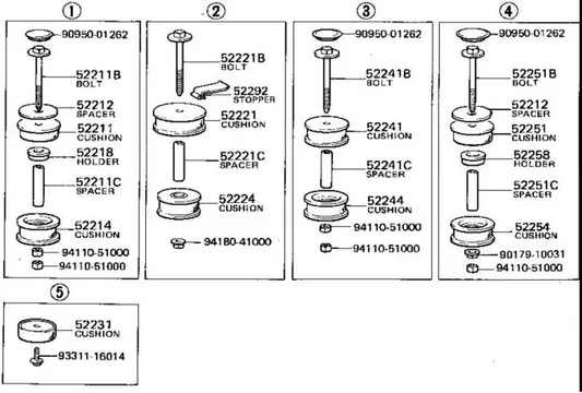

2. Are the body bolts all supposed to have double nuts on them?
5. This is the first late model cruiser I have worked on (79+) are there only 6 bolts holding the tub to the frame? Two in the rear channel and two at the bottom of each a-pillar with two about mid-way? Am I missing any others? ........
So now I'm at home, here goes.......
Some certainly have double nuts Dallas. And I think you missed the "tub-to-frame" mounts allocated the number 5 below. (At least my BJ40 has those 4 mounts in addition to the 6 you mention.)

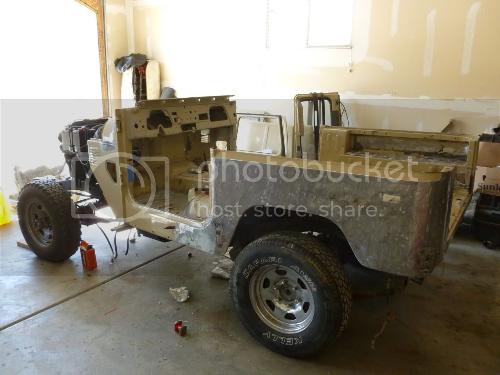

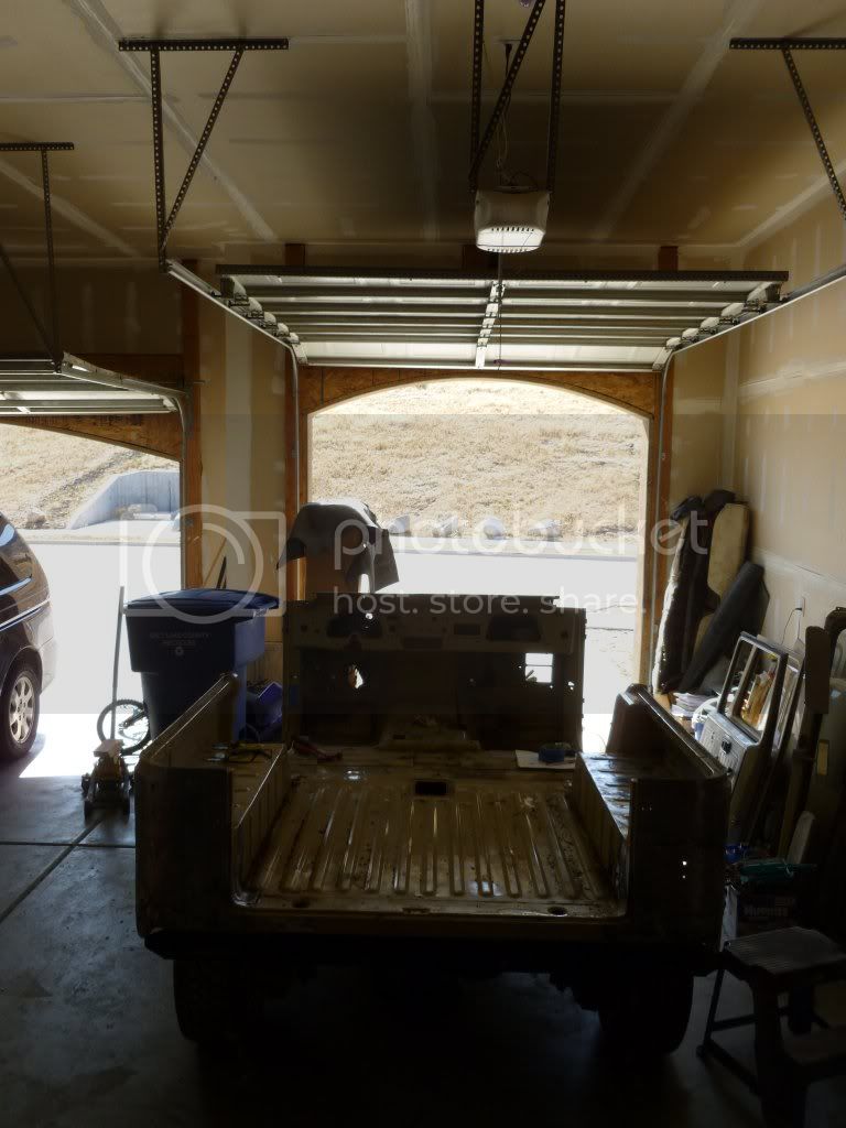

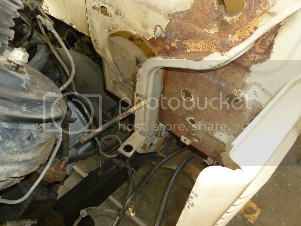

Tub is ready to come off.....I just have a few questions.

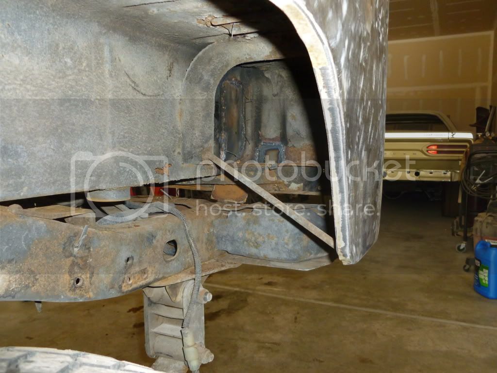

First, I "assume" these support rods are previous owner additions and NOT stock, correct? (Please tell me they are NOT supposed to be there. What an eyesore. They have tan paint on them, which makes me wonder if they are stock....alas....I don't know for sure.

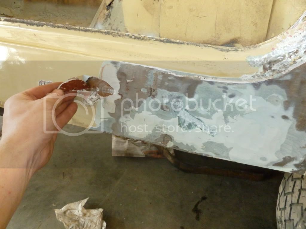

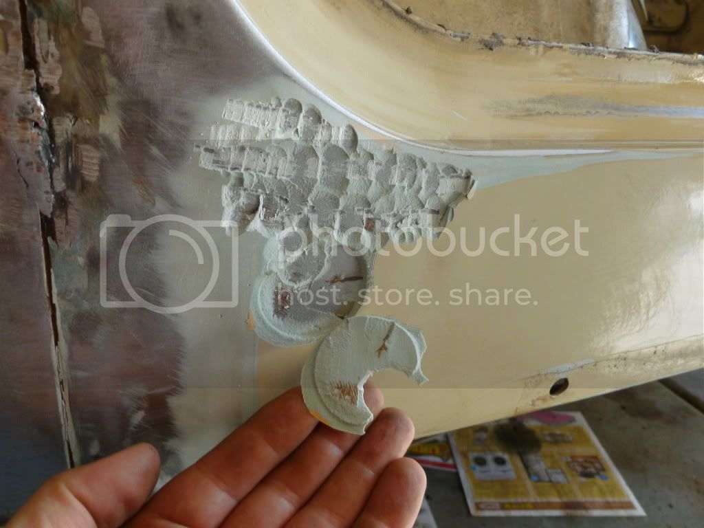

Until I can find help to remove the tub...I started to pick around....CHECK OUT how thick this bondo is....horrible.
Someone save me......
LOL...Dude that bondo is CRAZY. The guy had some mad bondo skills though....wow.
Those rods are not factory stock.

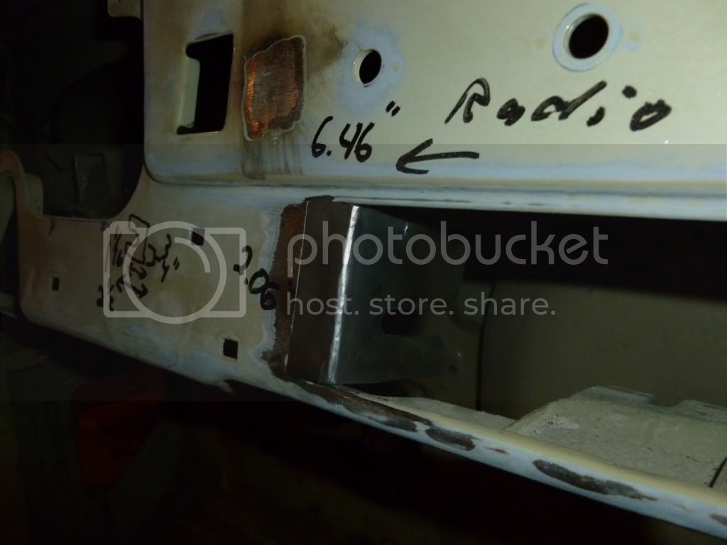

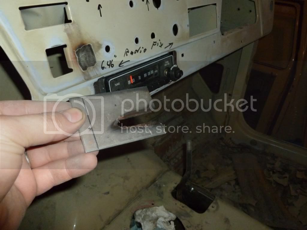

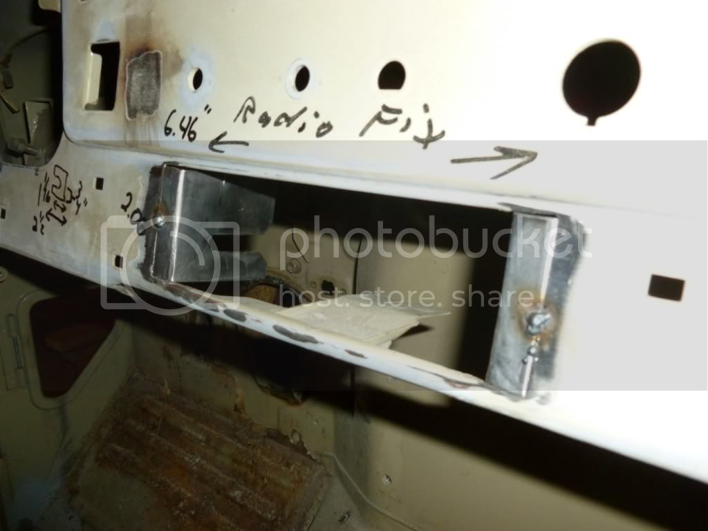

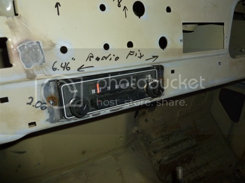

This evening I fixed the radio hole hack-job that a previous owner did to fit a cd-player.
First - I posted this thread to acquire the stock radio opening dimensions:
https://forum.ih8mud.com/40-55-series-tech/517051-stock-radio-opening-dimensions.html

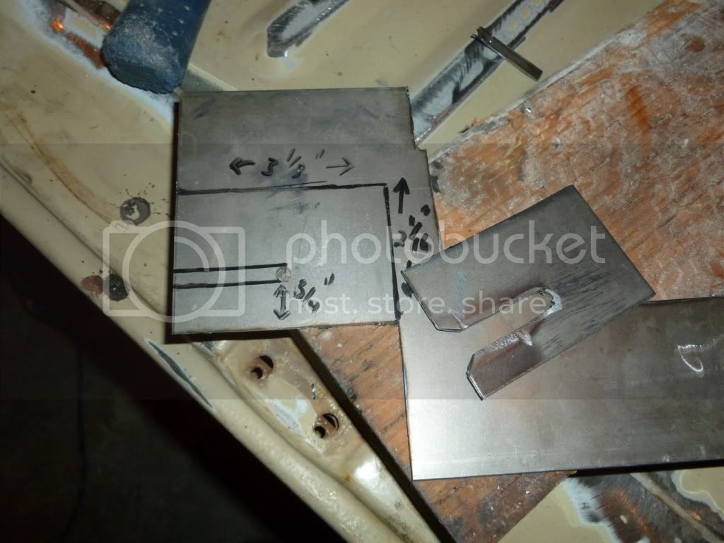

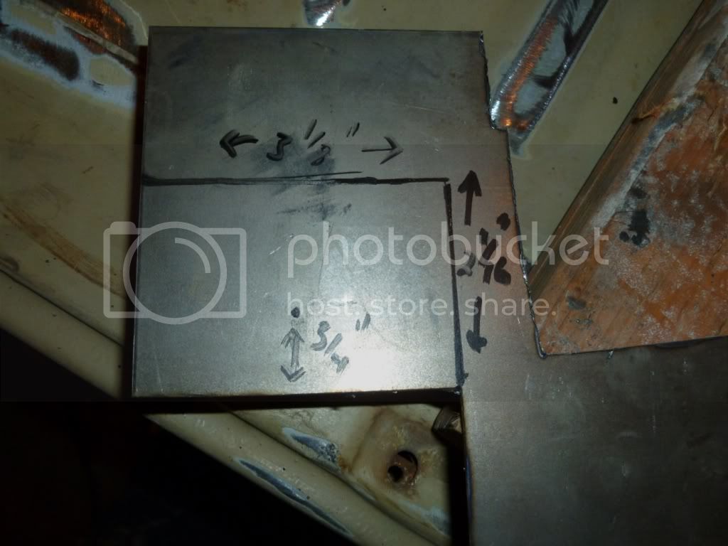

Then, with those measurements I centered the AM radio and measured the gap along with the support brackets for each side:

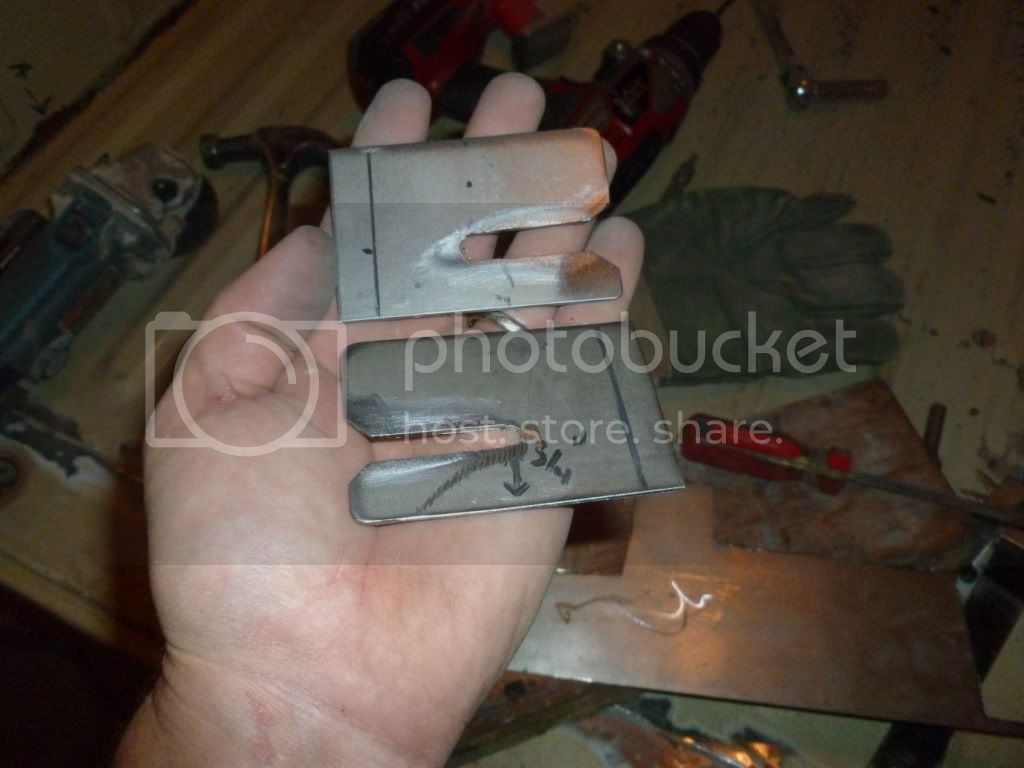

Since I don't have a router, I drilled a hole and then cut up to the hole:
Cut and ready for fitment: (the lines are the 3/8" (about 12.5mm) bend mark)
I can see here I cut them just a bit too wide:

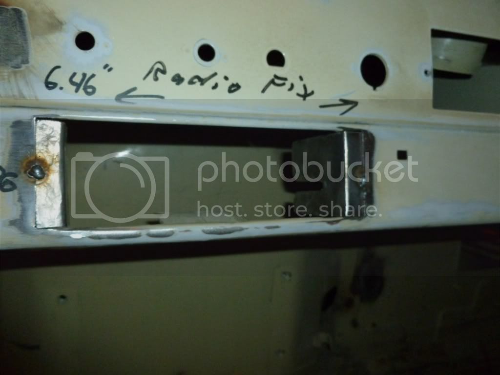

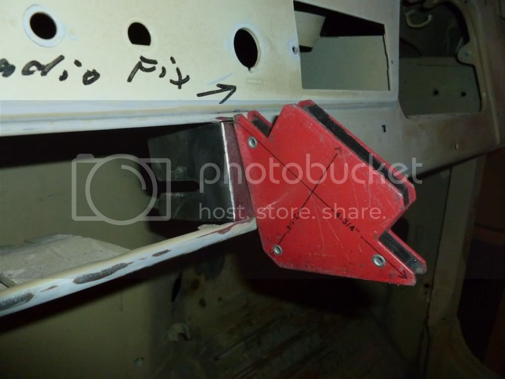

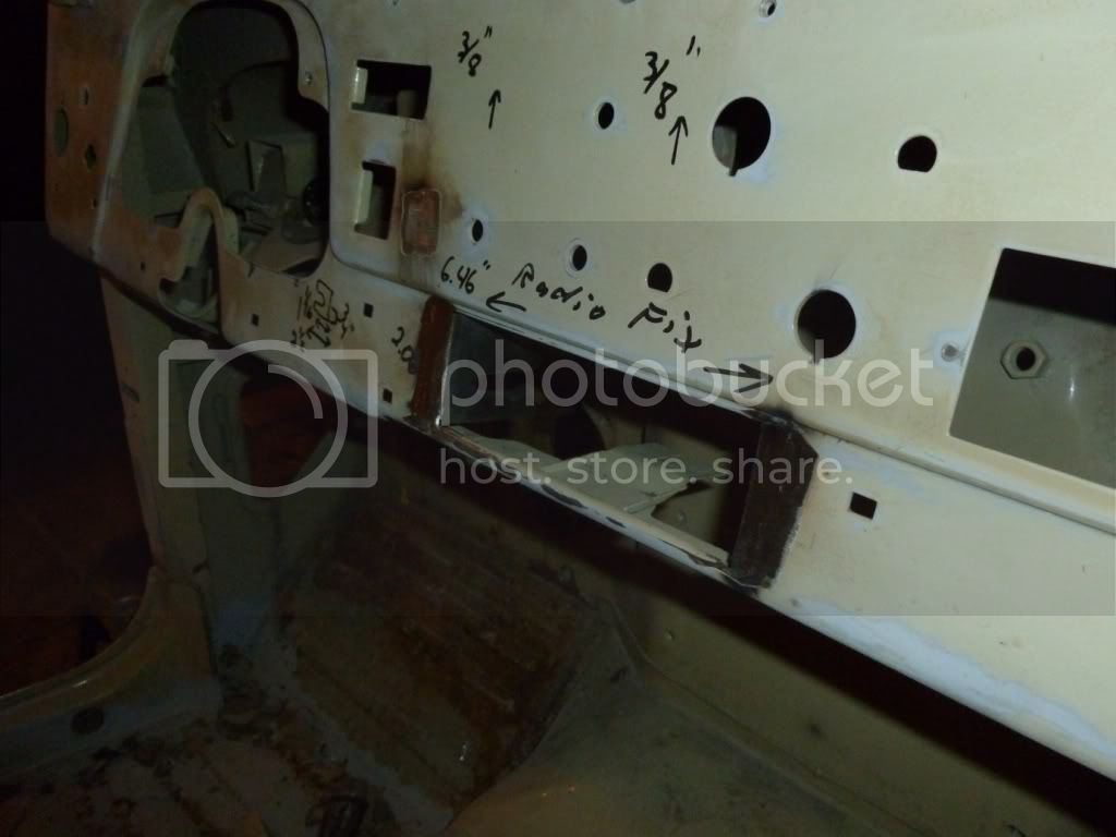

So, I trimmed them up and tacked in place to test fit:
and fitting again
Getting closer:

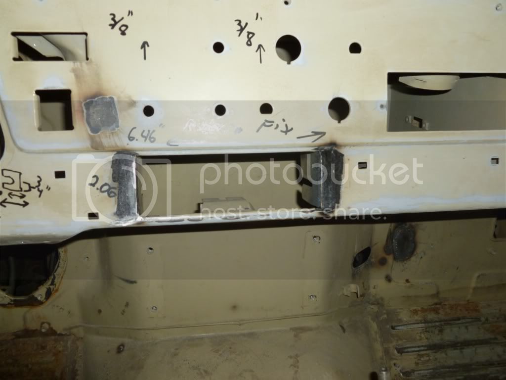

BAM! Spot on! As you can see here it fits the slots in the rear as well as the bottom and other side:
Welded in and ready for metal glaze and paint:
have a good night :-)
Dude those cuts and welds look pretty clean......im blown away by your fab skills sometimes man. That looks pretty darn good.
