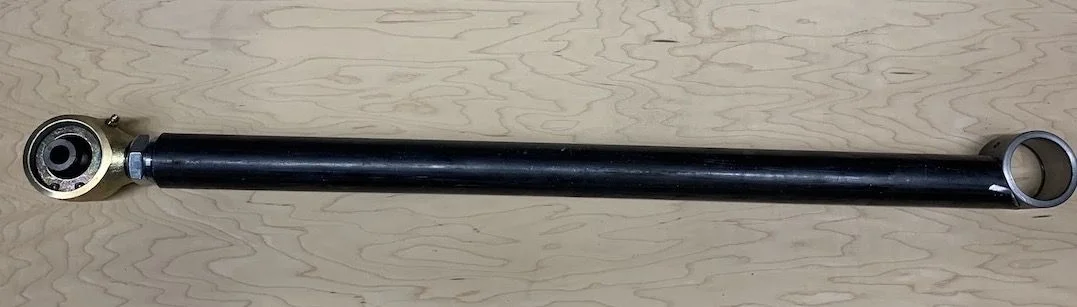

I thought I would start a separate thread on this. I don't know if anyone else has ventured to make their own RLCA's but I hope those that have, will share.

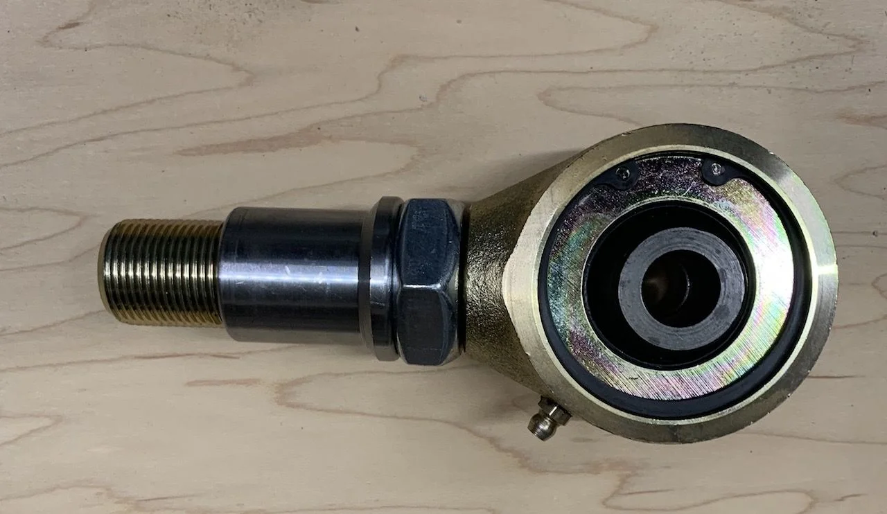

I am using Currie Johnny Joints 2.5" narrow body's with 2.365 wide balls and 9/16" bolts. Tubing is 1.75" x 0.250" DOM. The axle joint is a welded version offset to allow for more clearance of the axle housing and smoother sliding. This is apparently necessary as I tend to slide/bend them :( By my measure, the stock links are 685mm (~27") center to center. I will construct mine to be 680mm (26 7/8") at it's most compressed length.
Please ask questions, comment, and share. Even if you didnt make your own, please share things that you wish your RLCA's had or didn't have. Please do not bash other's products though.
As full disclosure, I am not a fabricator. I am just a hack with a variety of tools that is too broke to be able to pay for the good stuff.

This is what i would probably do. I don't have long or even extended travel rear shock so the arm should not bottom out to the axle housing yet.
@CarolinaGX why are you making your RLLs a tad shorter than stock? Oh because you can extend them about 1”?
I've been strongly considering doing this myself as well. What did you use to cut the circular shape on the axle end of the tube?
I use a tube notcher from Harbor Freight and a 2.5" Lennox hole saw from Lowes. I use a hand drill on the slowest speed instead of my drill press.

Mostly because I don't completely trust my measurement because my eyes are getting older. I want to be sure that I can accomplish the stock length should the need arise. MT suggests 1/8-3/16" longer for lifted trucks to correct pinion angle. So, that would mean that I would have ~1/4" threaded out of the tube + 3/8" the jam nut to achieve proper alignment which I think is within an acceptable range.

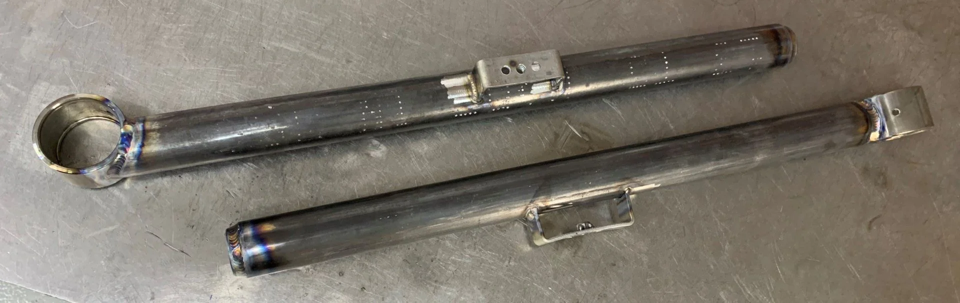

All welded up by my buddy (My welds aren't this pretty). Now to prep for paint
Nice work.
Any idea on wall thickness of stock arms?
I don't have any idea. Perhaps I will cut up my bent one to measure after I install these.

Only suggestion is roset welding the insert into the rod body. Drill two holes into the DOM about 3/8" from the edge. Slide the threarded insert in then roset weld the holes closed, then run a bead along the outter lip.
It gives the insert more surface area to weld to. Might not be necessary, but I didn't want my joint weld failing and coming undone after being dragged or dropped on.
my coworker and I were talking about this yesterday! Glad someone is doing it... all you need is DOM + Johnny joints/Heim + bushing housing + Bushing in terms of material or you can go double Heims
Check out this video, i watched it yesterday and he does an additional rosette weld on the bung for additional safety factor. Very cool!
@ArBrnSnpr Thank you for the reminder. I meant to do it and it somehow escaped me. Thankfully, it isnt too late to do it.
