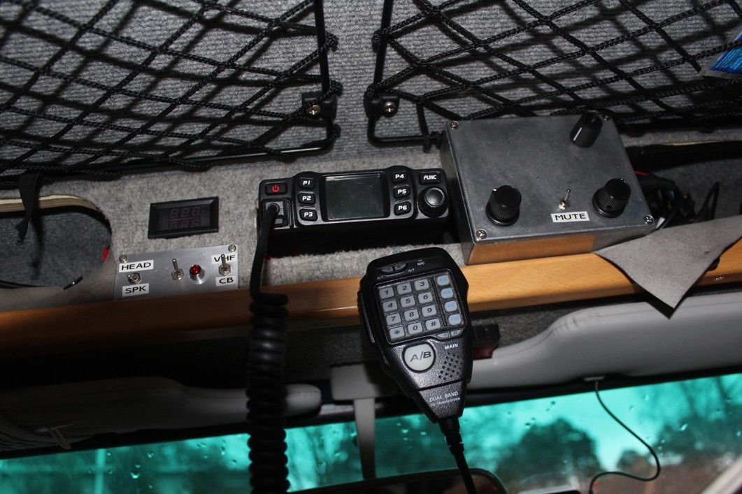

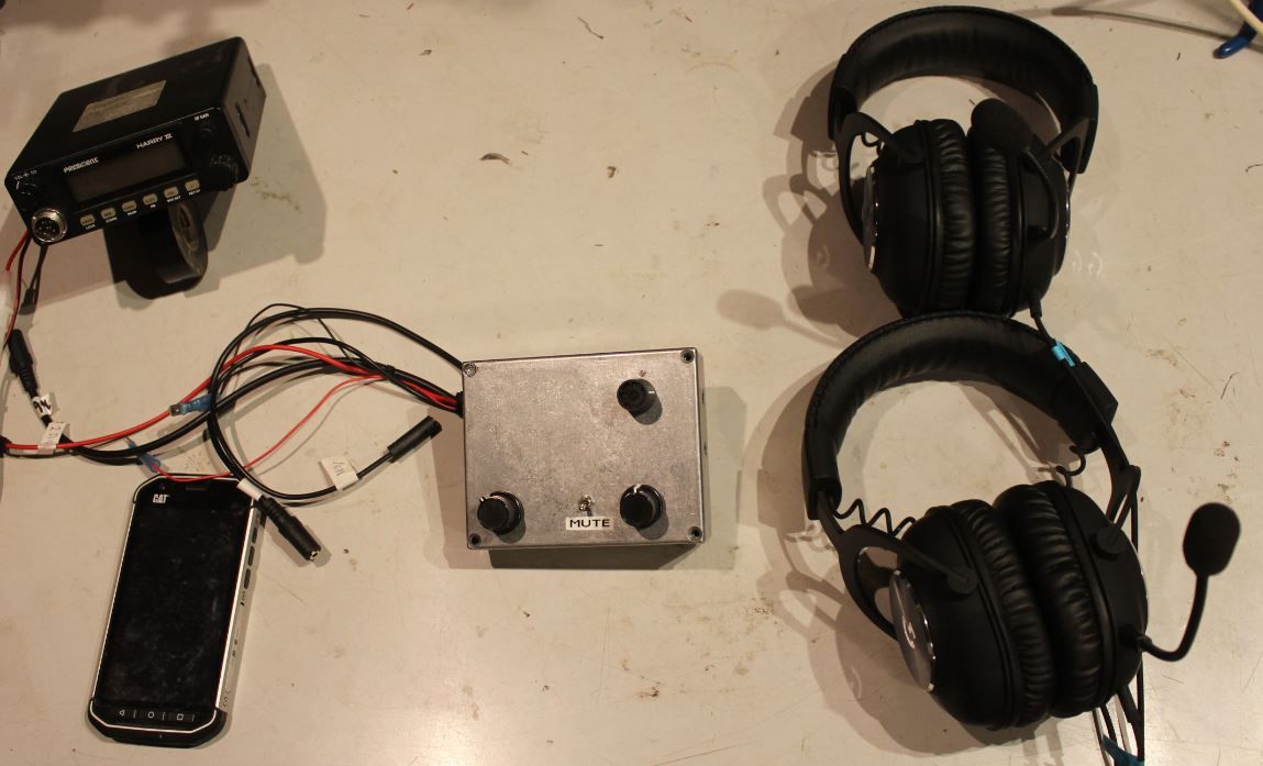

There is a lot of noise in a Land Cruiser. And when driving on bad roads or off-road, it is very noisy. When you also hear a little bad like I do, it becomes a problem to talk to the sidekick, or hear what is being said over the radio. This gave birth to the idea of an intercom system. It consists of two headsets with microphones, of the same type that gamers use, and an amplifier box with inputs for CB and VHF radio, mobile phone and music / radio.
It works so that we can talk to each other via the headsets, listen to music or talk to other cars using a radio or mobile phone. The signals can be mixed together so we can, for example, listen to music and talk together at the same time, or use the headsets as hands-free for mobile and VHF / CB radios.
I have a blog and you can read more there, plus diagram if you will build yourself: Intercom - Inditravel.org
