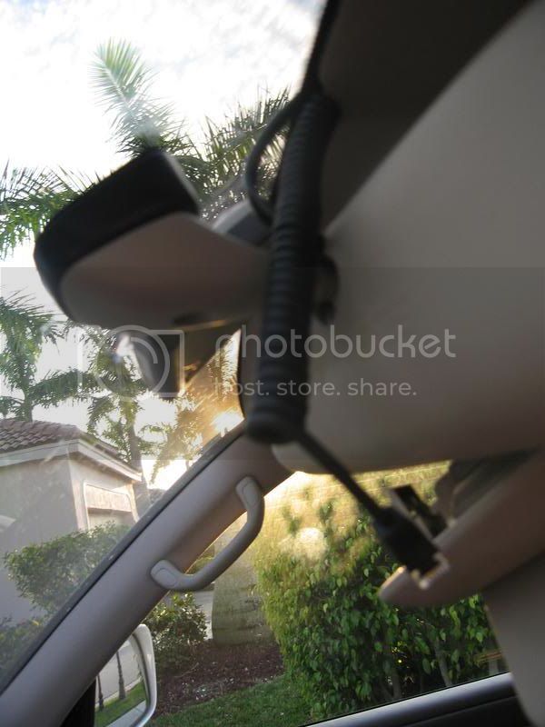

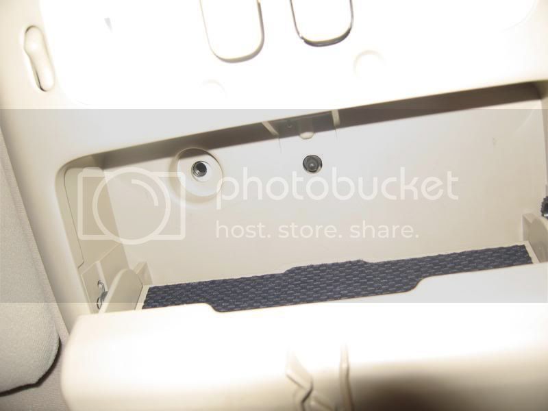

I know its the lazy way to do this as it's a constant hot feed...But I only use the dector on the highway so I'm manually turning it on and off any way.It's about a ten min, install this way and even I can do it.This is for an 03 LC with overhead consul First remove the screw that is up inside the sunglass compartment.
then just unclip unit buy gently pulling down (4 clips)

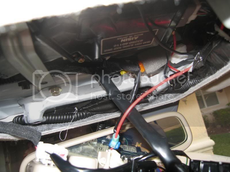

I tapped the positive wire going to the auto dim mirror with the supplied quick splicer clamp (red wire) then attached the neg (black) to a ground.

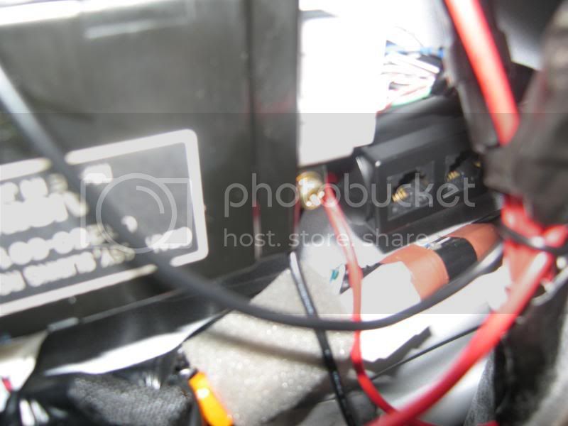

Attach the dirct wire power adapter (telephone jack looking thing) to an out of the way place and plug in powwer cord.
Fish wire through where the auto dim wire is.

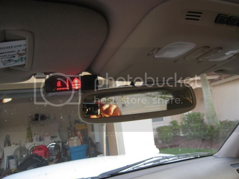

Find a good place for the unit and hook up wire....tuck every thing back into place, reclip consul and screw back in.
This was so simple that a dork like me can do it in ten min......If I go get some longer wire and pull of the a pillar and dash I could tap into another spot ... but untill I need to wire a more complicated project this will do fine.Valentine puts together a great kit.....Just for laughs I called Best Buy and they want $89.00 to wire it!!!!

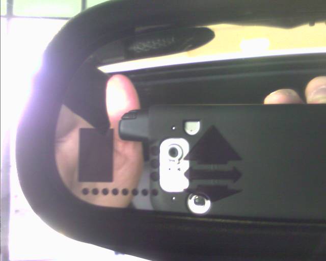

fender, to fix the stolen valentine problem...get it put INSIDE the mirror! The shop that did my rear camera and speakers and subwoofer does custom V1 installs inside the mirror. He just sand blasts off a template off the backing on the mirror to expose it, and mounts the LEDs to it. Its a sick install, ive personally watched him go through all the steps to do it. Here is a close up picture of it mounted in a new Porsche 911(997) Turbo mirror.
