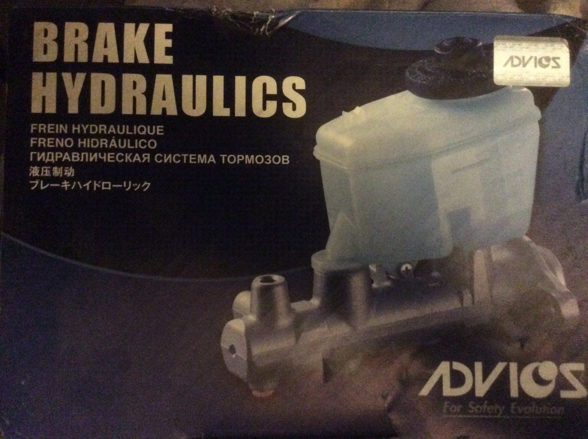

I'm having somewhat the same problem with my stock booster push rod being to long by approximately 3/8" even when push rod is adjusted in as far as it can go. I have 4 wheel disk brake conversion with new master. Have you seen this issue before? I'm thinking I may have to cut down push rod.? 1/73 fj40 here is a pic of my master. Any advice would be a big help. I did completely remove adjusting nut just to see where booster would sit without the acorn adjustment nut on push rod and I still need approximately another 1/16 of a inch.

Personally I wouldn't grind down the push rod if my life depended on it. :cautious:
Is your pedal side adjusted per FSM? There shouldn't be any residual resistance when you release the brake pedal.
I think the real issue is that your stock booster is a drum brake booster and it's coupled to a disc brake MC. You can bet the two engineers never talked because the two pieces are from different generations.
I did adjust pedal per FSM. And I also know the correct procedure to adjust push rod. I did not know I had to change booster. Thank you!!! That makes the most sense why things are not meshing well.
I know I have the ability to modify push rod, the part that's inside booster but not positive it will work. I may try just for fun but most likely I will be ordering a booster from ya.
Thanks again.
BTBUILD
If your booster is still good you shouldn't need to order a new one.
It was good when I took it off. Push rod at this time is way to long. And won't allow me to get even close enough to mount master cylyder. Even when adjustment nut on master is dialed all the way in. I'm baffled!
Something isn't fitting right. Have you tried pushing the rod in further? Is the brake pedal partially depressed?
The rod will pull out and go back in. How far does it stick out?
Yes I adjusted pedal height per FSM. I have pulled it out and tried pushing rod in further, dead stop. I will have to measure how far rod sticks past booster. When I try to put master on booster mounting bolts I'm left with approx 3/8" between booster and master. When I get home I'll check in mm.
