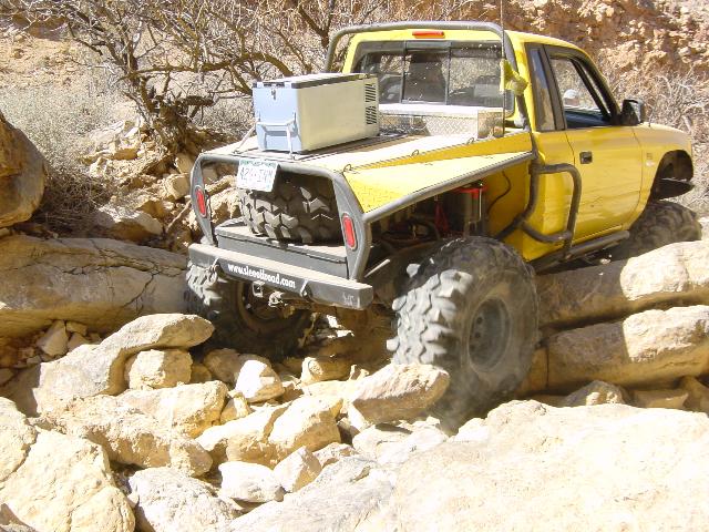

Here are some examples of where the brackets would or did get me stuck. Again, this is not to know the MAF kit, but we have to keep Ty busy until Cruise Moab next year.
Naaaa, looks like you just needed to give it a bit more gas... :D
TY, one thing to remember is that even with the perfect vehicle you might not make it up a trail, a rock could just be in the wrong spot for you, you might be hitting the gas at the wrong time, something like that. And after you admit defeat, someone else with a different vehicle, that you totally outclass, might come up and cruise through it with no problems...different vehicle, different driver...that's what makes wheeling fun... :)

here is a little real world expereince...
My rear control arms are custom and were bent when they were built to help avoid this. i still get caught on the frame mount but thats life.
first.. rear control arm
second.. i made that ledge no problem...
third.. i could get up on it but couldnt even get winched over i was hung up super bad..
