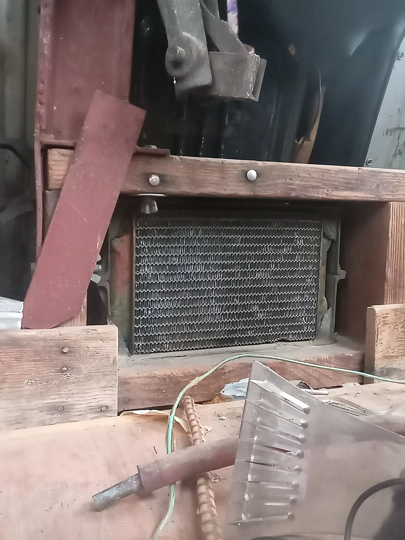

Go to a junk yard. Score a subaru radiator with the electric fan and bracket. Build a wood box for behind the front seats that holds the radiator/fan assembly. Plump into the coolant system and wire in a switch for the fan. Add a flow valve to shut it off when heat isn't needed. Boom heat. You could do some ducts to move some warm air up front by your feet.
Couple hundred bucks for everything ought to do it. Several hours. I ring shanked my wood box assembly except to the top which is screwed on so I could easily service the unit easily. I have storage bins on both side of the heater. It was like one 2"x6"x8' and some scrap pieces of 1x4 or 6. Mine is wall to wall between the wheel wells and fits in the floor recess.
