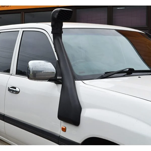

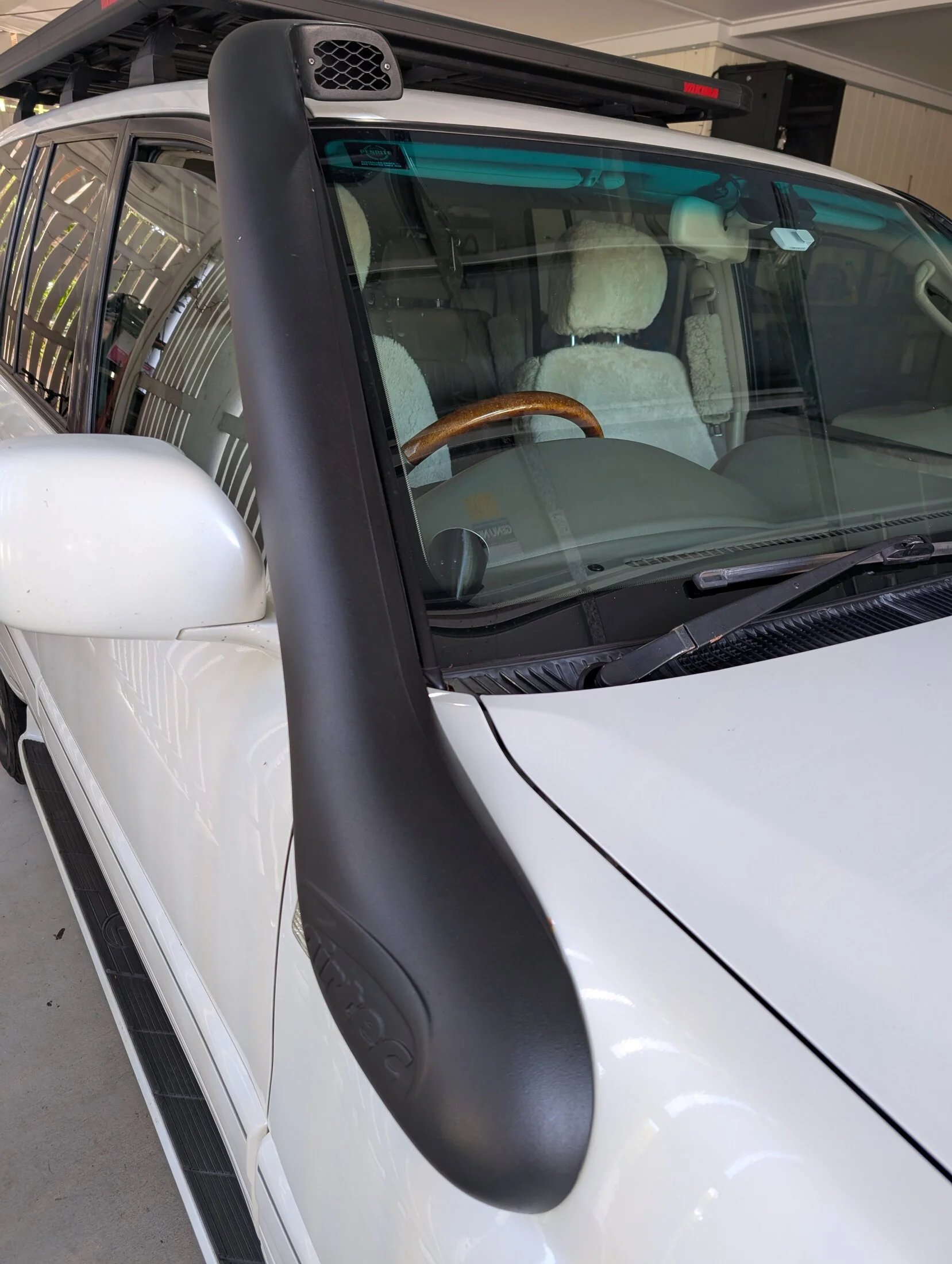

What would be the pros and cons of each of the snorkel types on the market for the 100 series Landcruiser?
Type 1
Type 2
I briefly looked at the In House Fabrication snorkel. I believe the Type 2 that you have shown has an interference with the antenna. People were discussing heating the snorkel to route it around the antenna but I'm not sure if there has been a more favorable fix yet.
I'm not sure there is much difference except for where you drill the 4" hole. I have the Type 2 and it's been pretty flawless. However, I would never recommend a "stock" snorkel. I installed the "Sy-Klone Series 9001r Air Precleaner" and removed the silly top piece. My Air filter stays extremely clean since the precleaner removes most of the dust, etc... (9001R Sy-Klone Series 9000 Engine Precleaner - https://store.sy-klone.com/9001r-sy-klone-series-9000-engine-precleaner) (No, I don't get anything for recommending them)
It's costly, but well worth it. I've literally had folks in parking lots checking out the precleaner.
The Type 1 (Safari Brand) was the old style.... and I believe the CFM rating was low for the 2UZ. Safari came out with an improved flow version called the Armax. Careful when ordering any snorkels. There are like 4-5 different air boxes.
It used to be that you'd have to make a dent in the plastic to clear the US antenna on top of the fender, but most of that style now have the divot. It's the first style that fully ran into where the US antenna motor is in the fender, you'd have to go to a fixed antenna to use that one.
