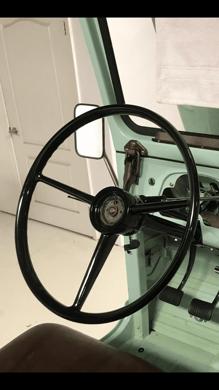

So, today, I was trying to install a “restored” steering wheel I bought and I just couldn’t get it to seat over the splines. @Rock40 & I were discussing. Can anyone tell us if the steering wheels were different over the years. The steering wheel I bought was restored as I sold my oringinal “shot/cracked ‘66”. Are the internal splines different over the years. @Rock40 restored my original steering box and shaft. The wheel I purchased “ restored”, but not sure what year it is. It won’t go on the splines (on the shaft) and seat. Any suggestions....

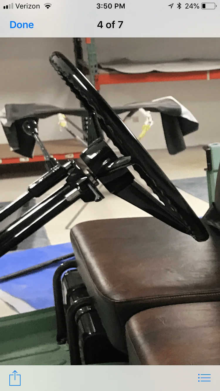

This was a little confusing, do the splines engage at all or not?
It looks like the wheel is engaged but not fully seated.
I am lucky to remember my anniversary but on my deathbed I will likely remember the spline count change on a 40 steering wheel at 7/69!
Yeah, it’s just barely sitting on the splines. No go.....
