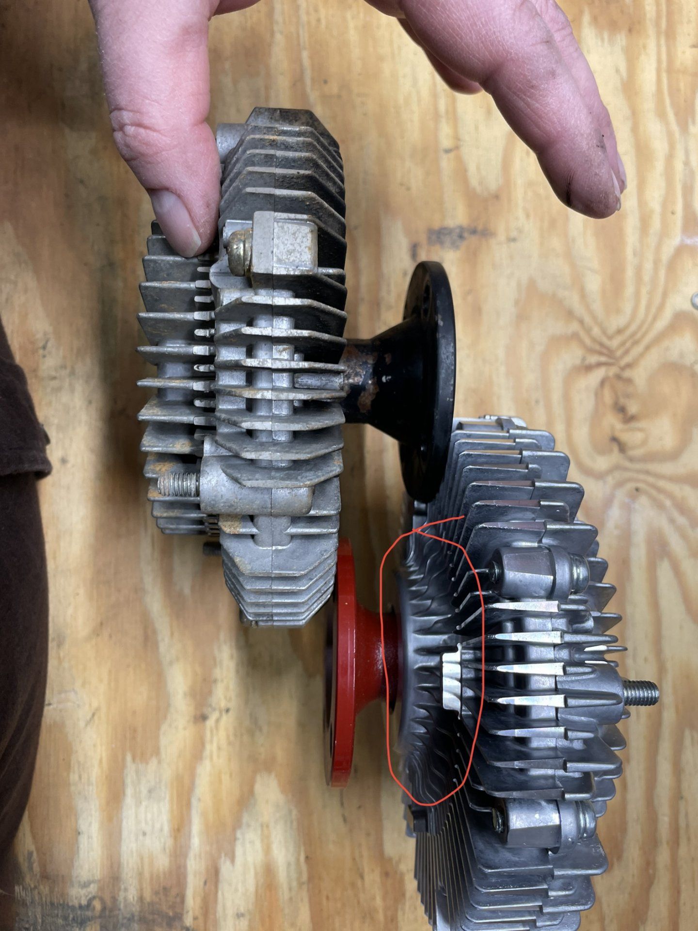

Here is a comparison of the new 79’ OEM fan clutch w/cooler (lower in the image) and the one I removed.
Can anyone verify if the one removed is a Toyota part or aftermarket?

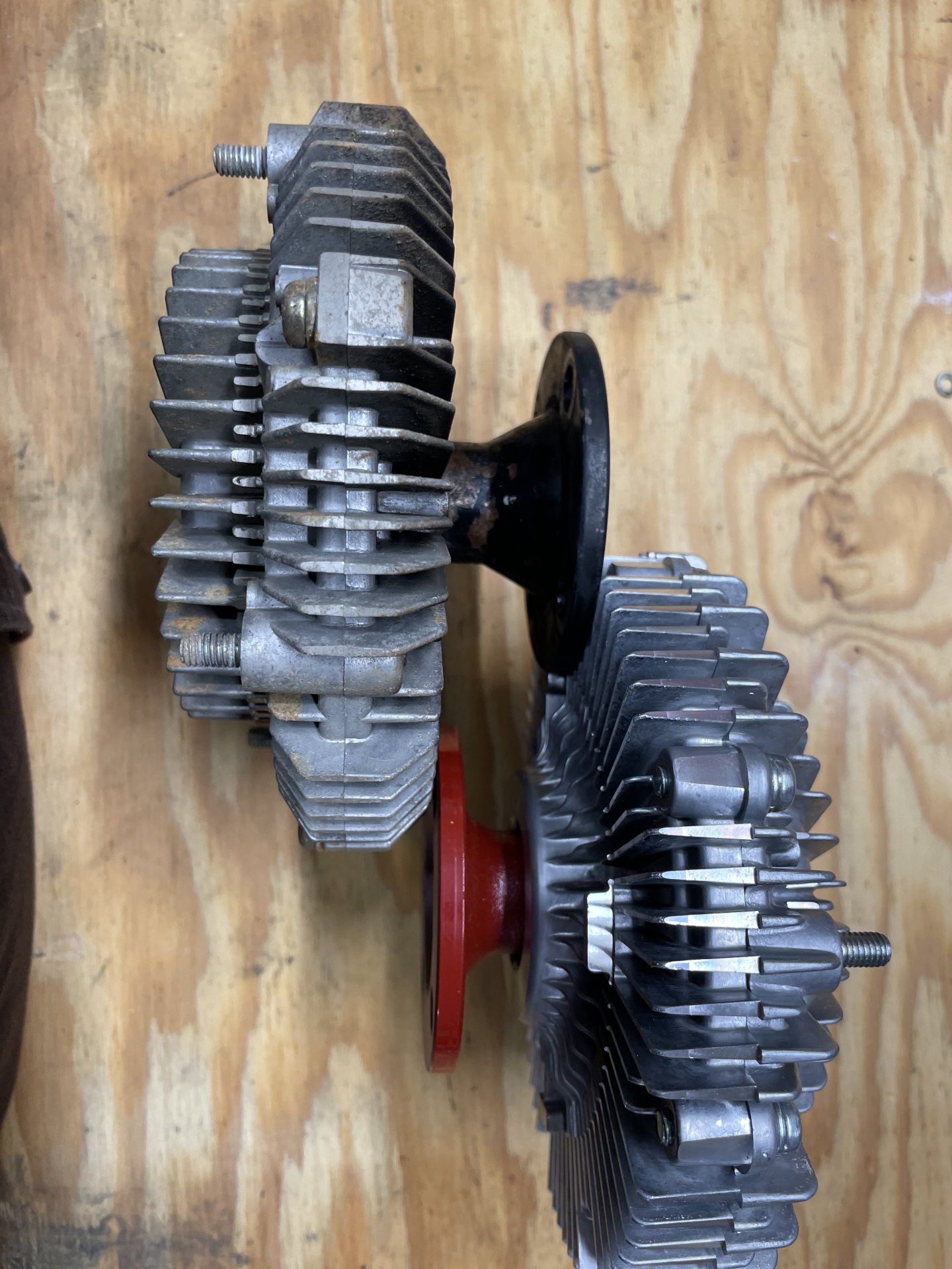

Don't quote me on this, but my recollection of the AC vs. non-AC fan clutch was just that the AC one pulled the fan in closer to the clutch to make room for the condenser. So the one above with the red fan mount would be an AC version.
Thanks, that could be true and it seems I also read that the factory radiator for the factory A/C equipped trucks was thicker.
However, when I compared the 2 dimensionally, I didn’t find any size differences, just a couple of design variations.

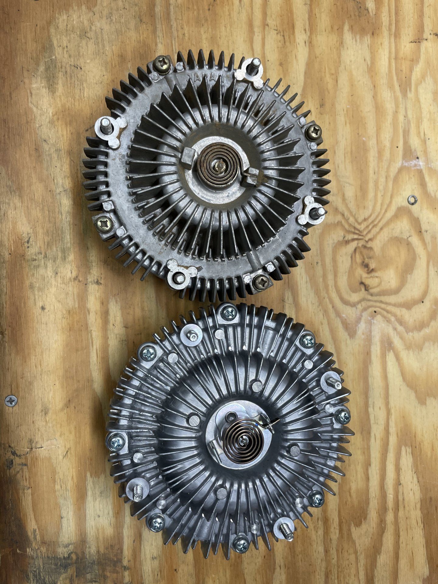

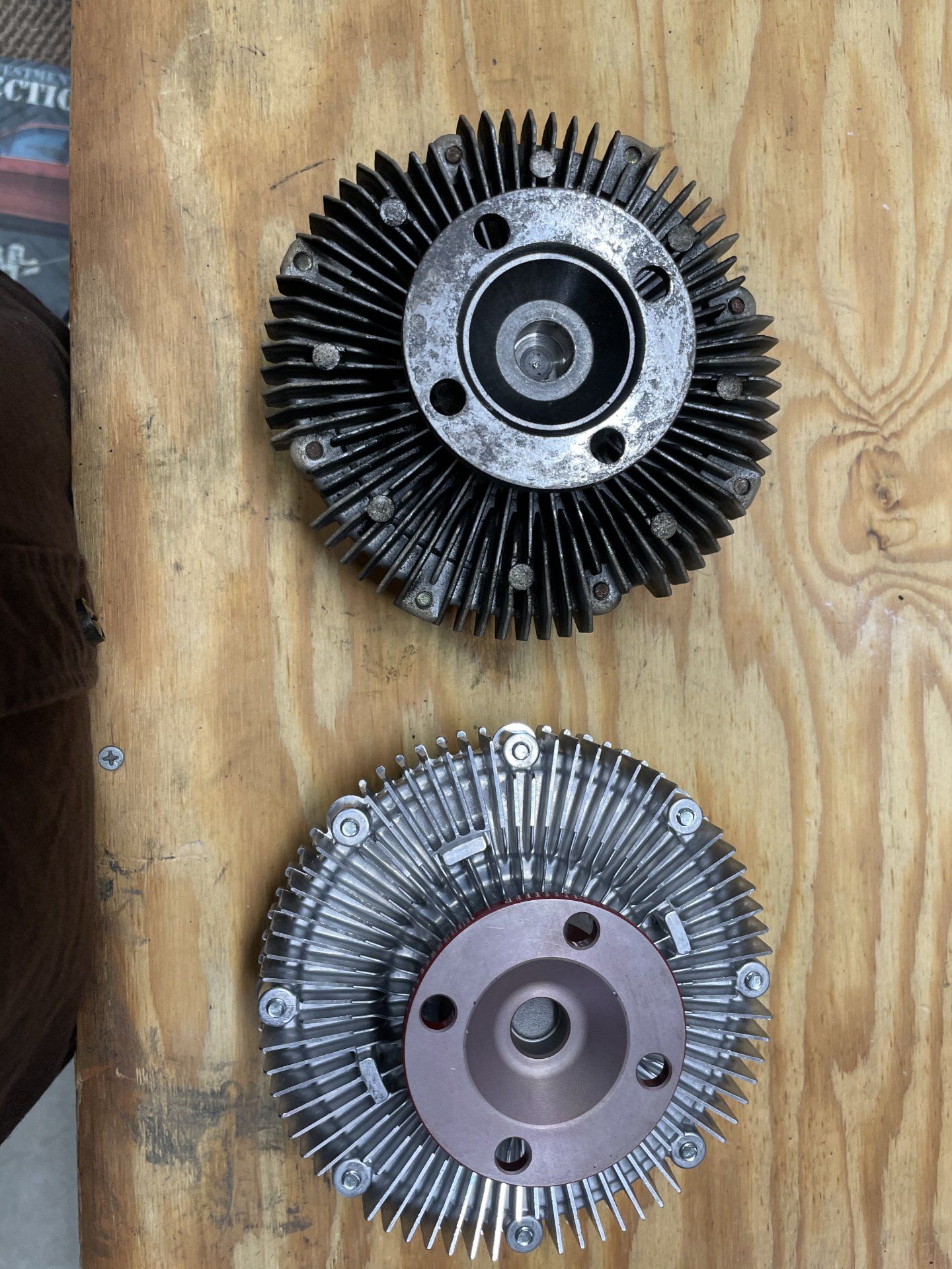

Maybe someone can post another picture of a factory non A/C fan clutch to verify the one I removed was the original factory non A/C type?
I am Uncertain if the one I removed was the factory original due to the fact I could get a box end wrench onto the bolts without issue to remove and that was counter to most threads I read prior.
On the new one added, there is a shoulder (circled in red) that made it too tight to fit a box end wrench (without grinding thinner) to tighten which was consistent for a factory version with most threads that I read as I was determining the best way to remove with the radiator still installed.

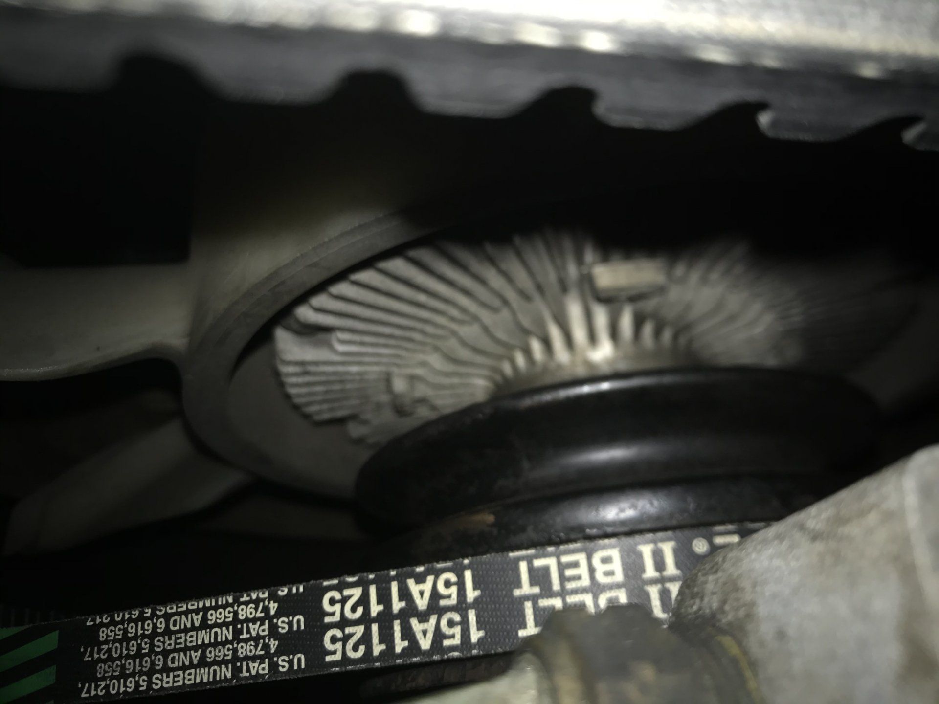

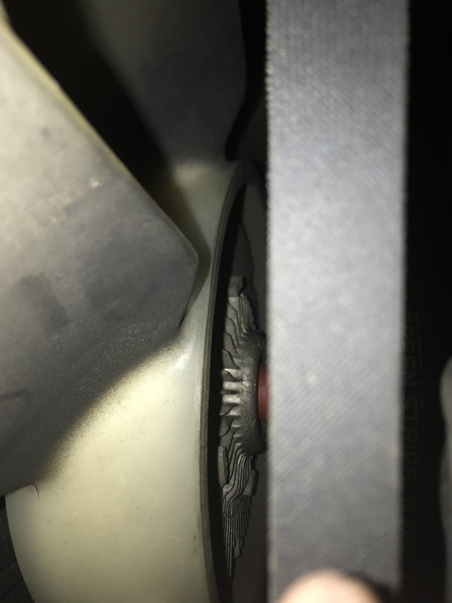

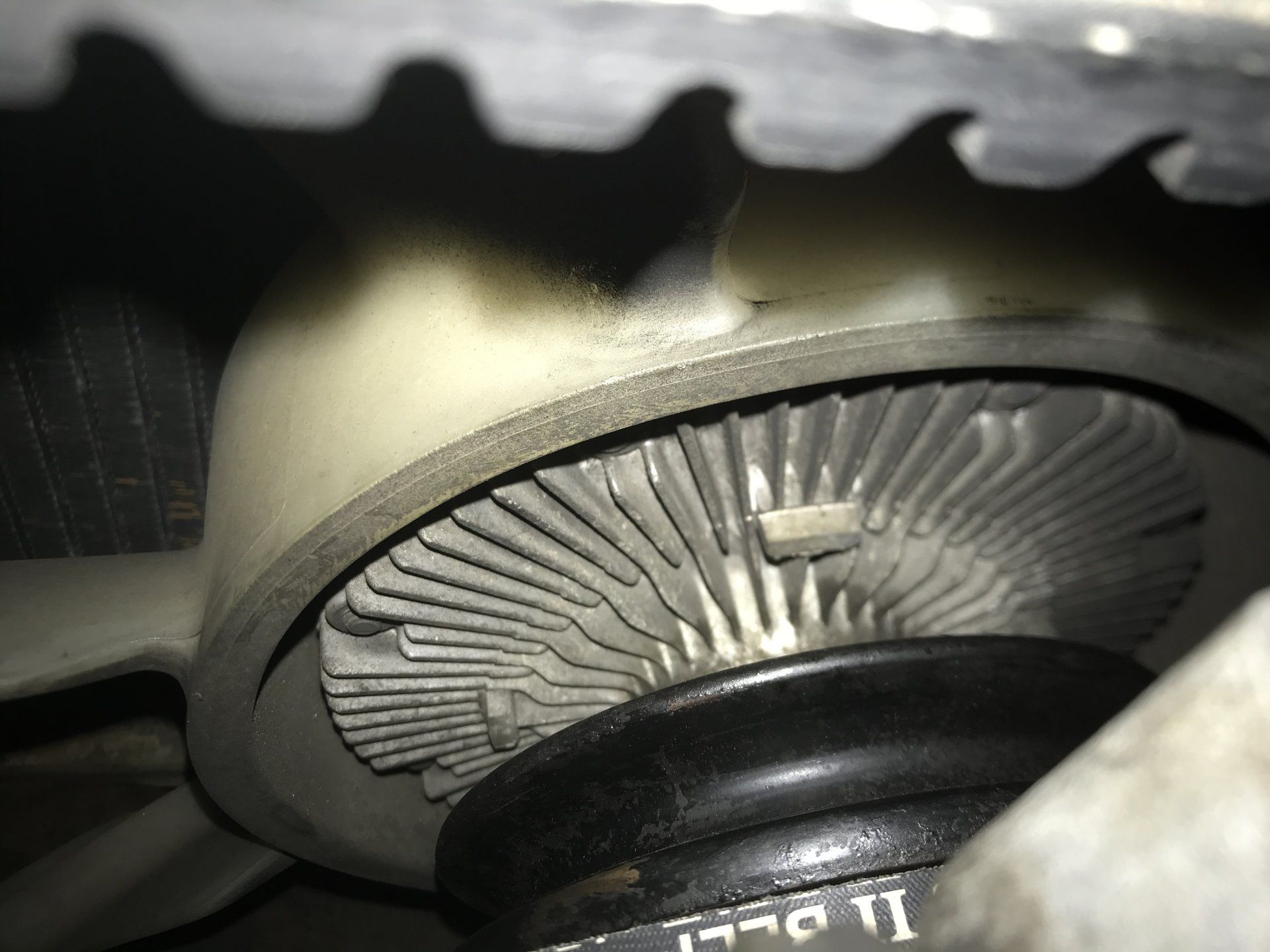

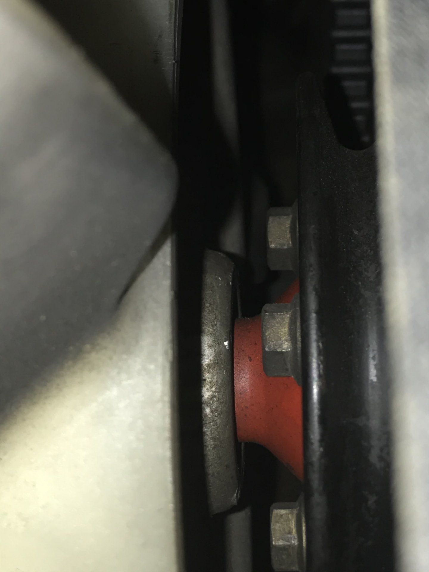

Thanks, yes it helps and does appear to be the same clutch!
If you have a chance and could snap a picture from directly above the fan shroud that indicates the amount of blade I and out of the shroud?
I am trying to make certain mine has the same/correct amount of space between blade and radiator and there weren’t any other differences inline, spacers, pulley offset Etc.
Will do but it won't be until tomorrow morning
