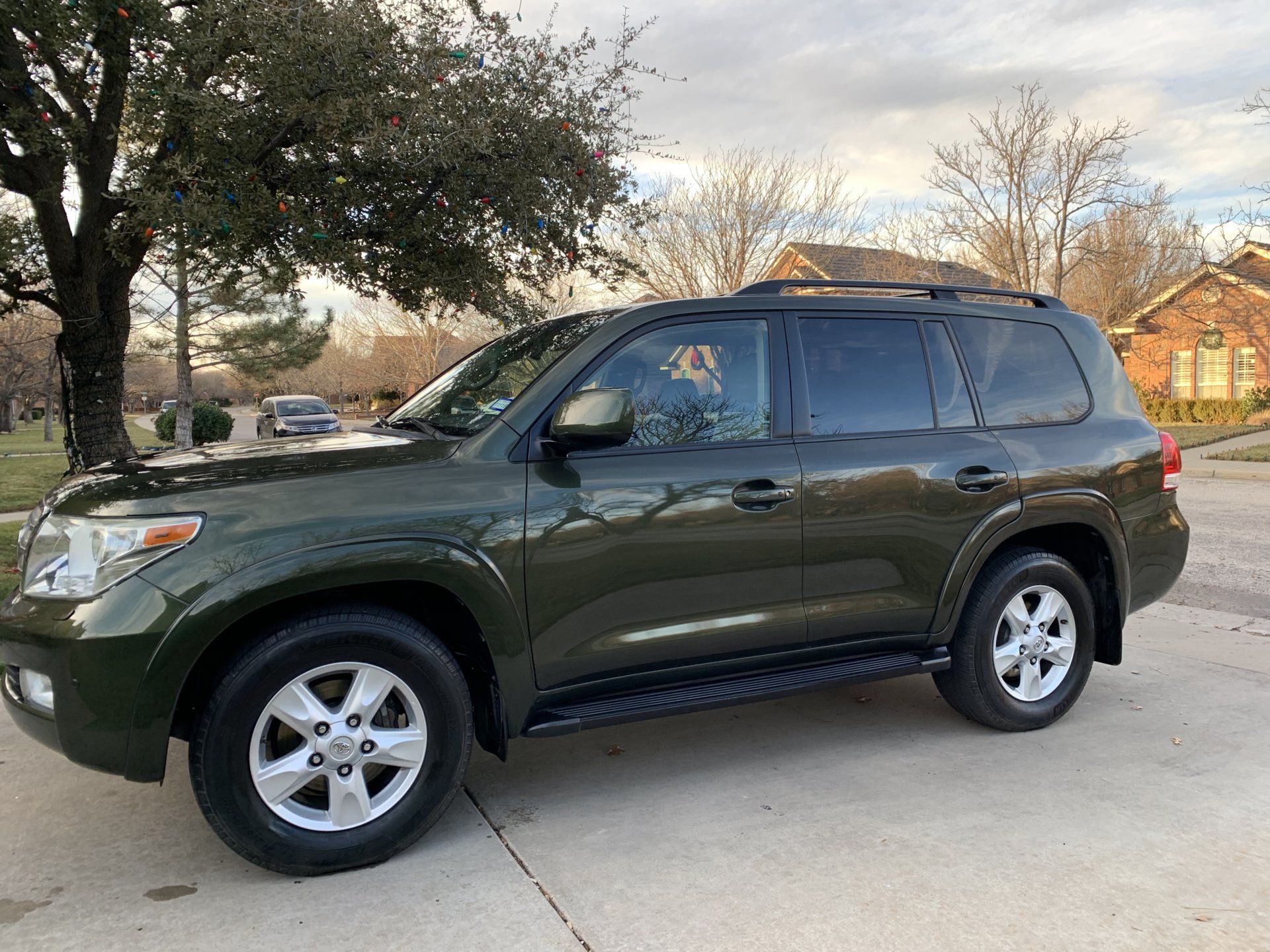

Show me a 2010 Sequoia that stands this tall:
