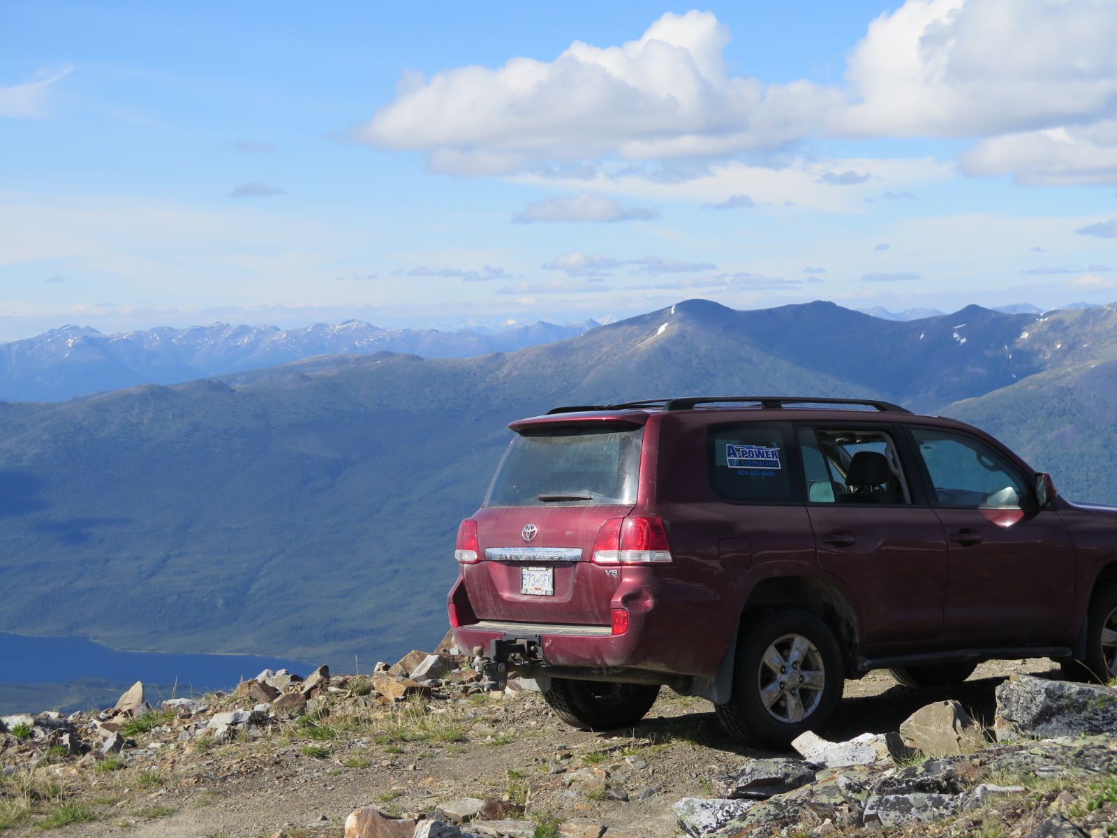

. (No LCs in Canada.)
I hate it when people say that. That’s a B.C. plate on mine.

View attachment 2150367I hate it when people say that. That’s a B.C. plate on mine.
You know perfectly well that my "(No LCs in Canada)" comment was in relation to what's available for sale at the dealership. Given enough money and effort you can import just about anything - that's not relevant to what was being discussed.
