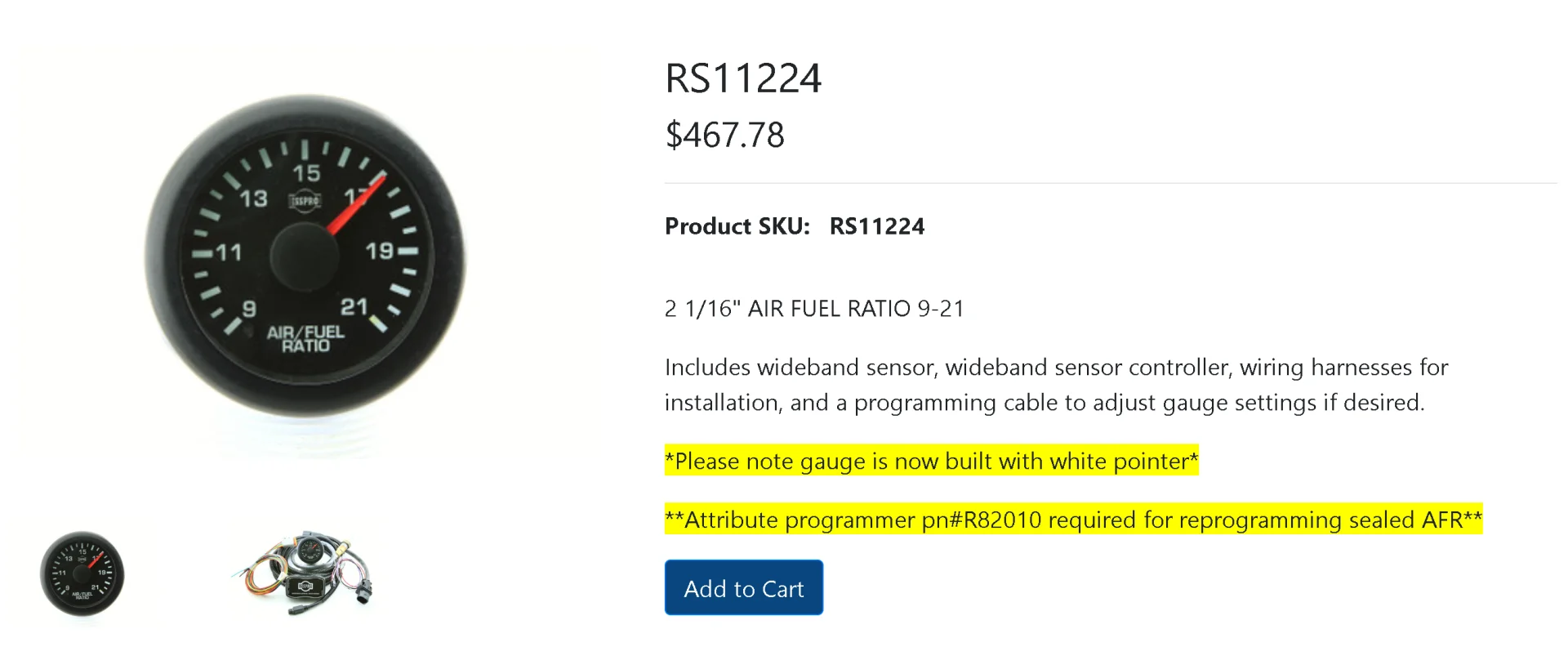

I'm working on sourcing a diesel AFR gage. Seems that most gages top out at 22 AFR. This 1HZ will hit 100 AFR at idle. Do you have an AFR gage you like?
' ISSPRO : auto / marine / diesel gauges, sensors, kits and instrumentation - https://www.isspro.com/products.php?productid=3597

The issue is scaling. A wideband sensor is 0-5v
So for a gauge with a wide spectrum you lose fidelity.
The wideband in my lightning is 10-17 and is highly accurate because of it.
The latest Wideband O2 sensors available in diesel AFR gauges are very accurate and can read up to and over 120:1 depending on brand.
I'm having a tough time finding some. Could you hit me with a few brands?
I didn't say they were inaccurate. I said they lack fidelity.
I'm using an Innovate AFR gauge as I can source them easily. Unsure what's available in your area? But with the digital display is very easy to see any AFR from 0-120:1. My FT actually idles leaner than 120:1 so goes off the scale but when A/C kicks in it drops back down to around 110:1. It's so responsive and accurate in displaying the AFR that I can easily see what effect small changes to the compensator pin profile has during spool as the pin moves through its travel.
