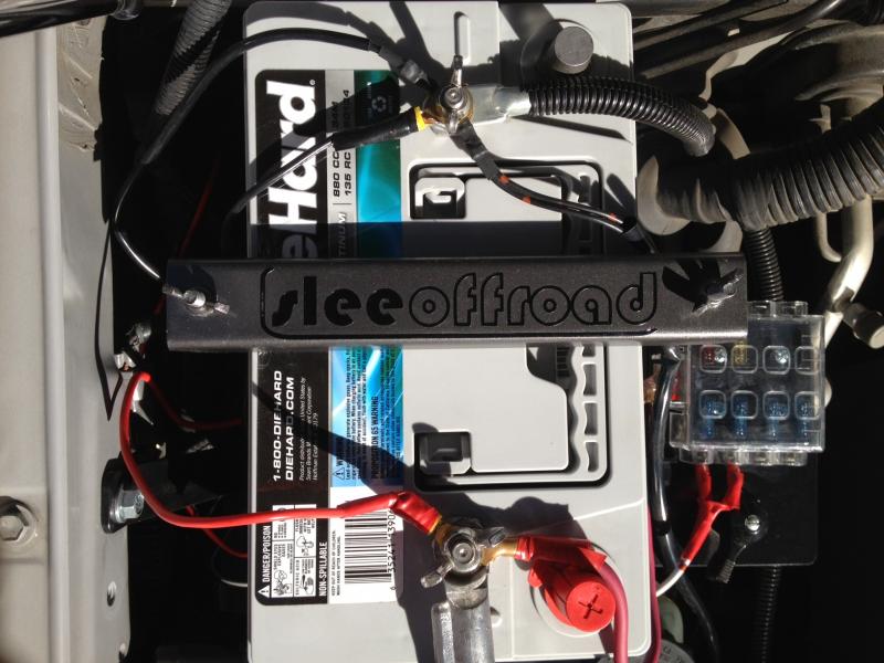

The J hooks from Slee's tray wont fit a Sears Platinum Group 34 either. I had to buy longer hooks. I also finished the bare metal bracket with primer and Duplicolor graphite paint for a more finished look. I mounted the bracket upside down and used a Slee decal to give it an even better look. Disregard the wiring job, I've been in the middle of wiring and rewiring for a few weeks now. Two more things to get figured out, then I'll make it look nice. You get the idea though.
Where to look locally for the longer J hooks, any ol auto parts store? How much longer approx?
The Slee tray shows up for the Sears Group 34M tomorrow.
Careful you don't get to jiggy with the top of the battery hold down and punch a hole in your hood. Also, that crossbar should be the other way, with the two edges they could start cutting into the plastic depending on how tight you have the battery. With it the other way you have more surface area and no edge.

Mine is similar in idea but I used a Cole Hersee isolator. I flip the switch when camping to isolate the aux battery. I mounted it on the wing of the SLEE tray with the fuse block. It's nothing more than an open/close relay. Very simple.
Worked for me, but I flipped the bracket
