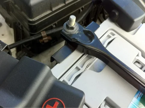

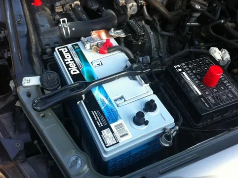

I replaced my OEM battery with a Diehard Platinum Group 35 at 8 years and 115,000 miles a few months ago. I experienced the same poor bracket-to-battery fit you describe (the OEM bracket is too wide for the recommended Diehard Platinum Group 35 battery). I made sure the bracket was centered with even pressure across the top of the battery. I'll post a picture in the morning.

Mine bolts down nice and snug but the tray is too large and the bracket is longer than the battery so either you center the battery b/w the angle brackets or you snug up the battery to one of the angle brackets. I'd like a better bracket or additional bracket just not sure whether that has to be custom or whether aftermarket adjustable brackets are available or whether i can get some pieces from a hardware store to make it fit better.

OEM battery bracket and DieHard Platinum Group 35 battery.

I added some short pieces of aluminum angle from HD plus some adhesive-backed neoprene from my local gasket shop...that allowed me to tighten the bracket with room left on the hold-down threads.
