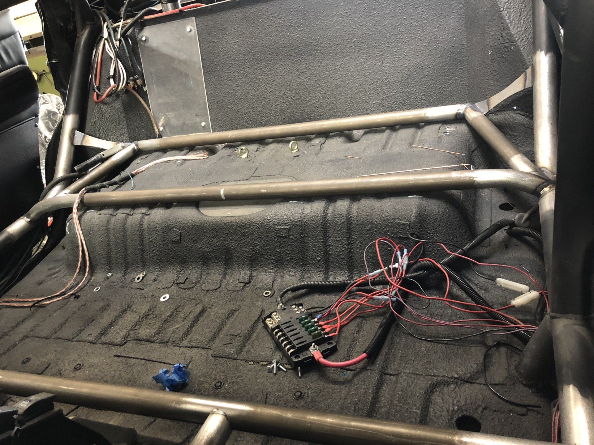

So Am I, Speaking of Saddle. here are the new race seat tie ins for my Roll Cage.
