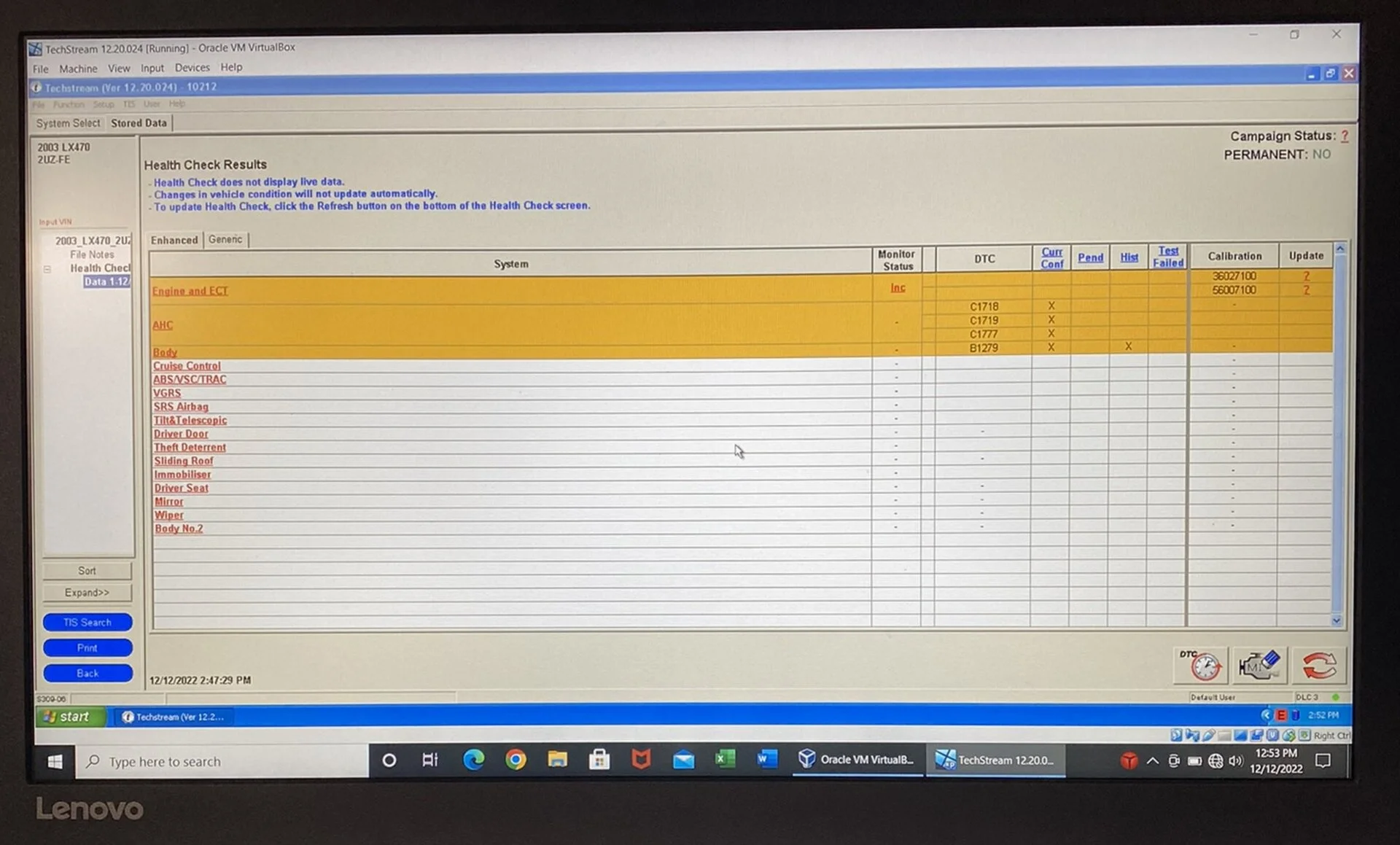

I did hook-up tech stream and check for any DTC, NO VGRS DTC, NO CEL or NO VGRS light (VGRS light does work, during key on self check).
The DTC you see below, have been active since AHC delete, is my understanding.

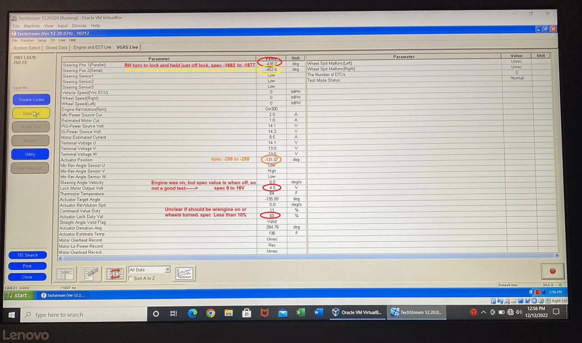

I've not done a comprehensive system diagnostic. This is just some pictures I snapped while in tech stream. Wherein I did turn steering wheel lock to lock and hold near each lock (lock than relax off lock 1 deg and hold 3 seconds or more). But I did not follow any procedure. So numbers out of spec, may be meaningless.
RH turn (- deg)
LH turn (+ deg)
