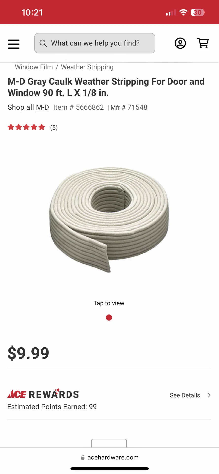

I have used this with good results, its not permanent, and comes off easy!
Is this tacky or just a soft foam you stuff into the crack? Either way I will order some up and give it a try. Thanks!
