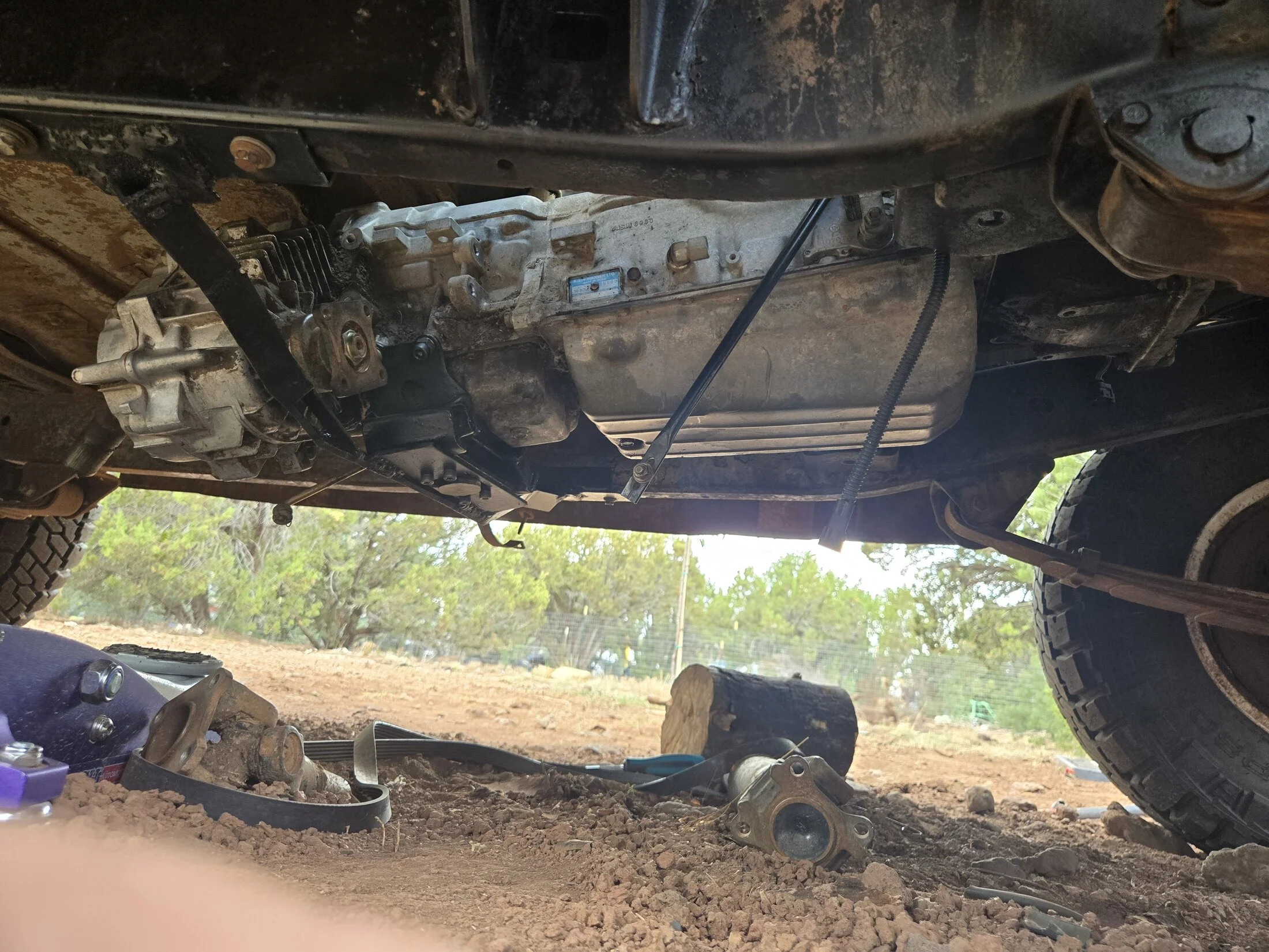

Working with a 55 with custom driveline so i can change all that on the fly, ive already dropped the front output flange down a good 2 inches. My concern is the steering part. If I put the caster 10 degree part to raise the pinion up more, am I going to have steering issues or what my next move is. Right now I just have to put the lift to get the oil pan away from the diff.

I have my driveline tilted approx 3-4 degrees for when the lift is on the rear driveline angle is easier which aided in decreasing front angle as well by lowering the flange down from the OE position. Driveshafts will be cut down to fit, rear is a good 8" too long now, front I need an adapter which is also a 0.5" spacer, and that driveshaft will be custom cut based on the adaptor. I just wanted to clarify that im not shooting my foot off rolling the caster the wrong way or something steering related

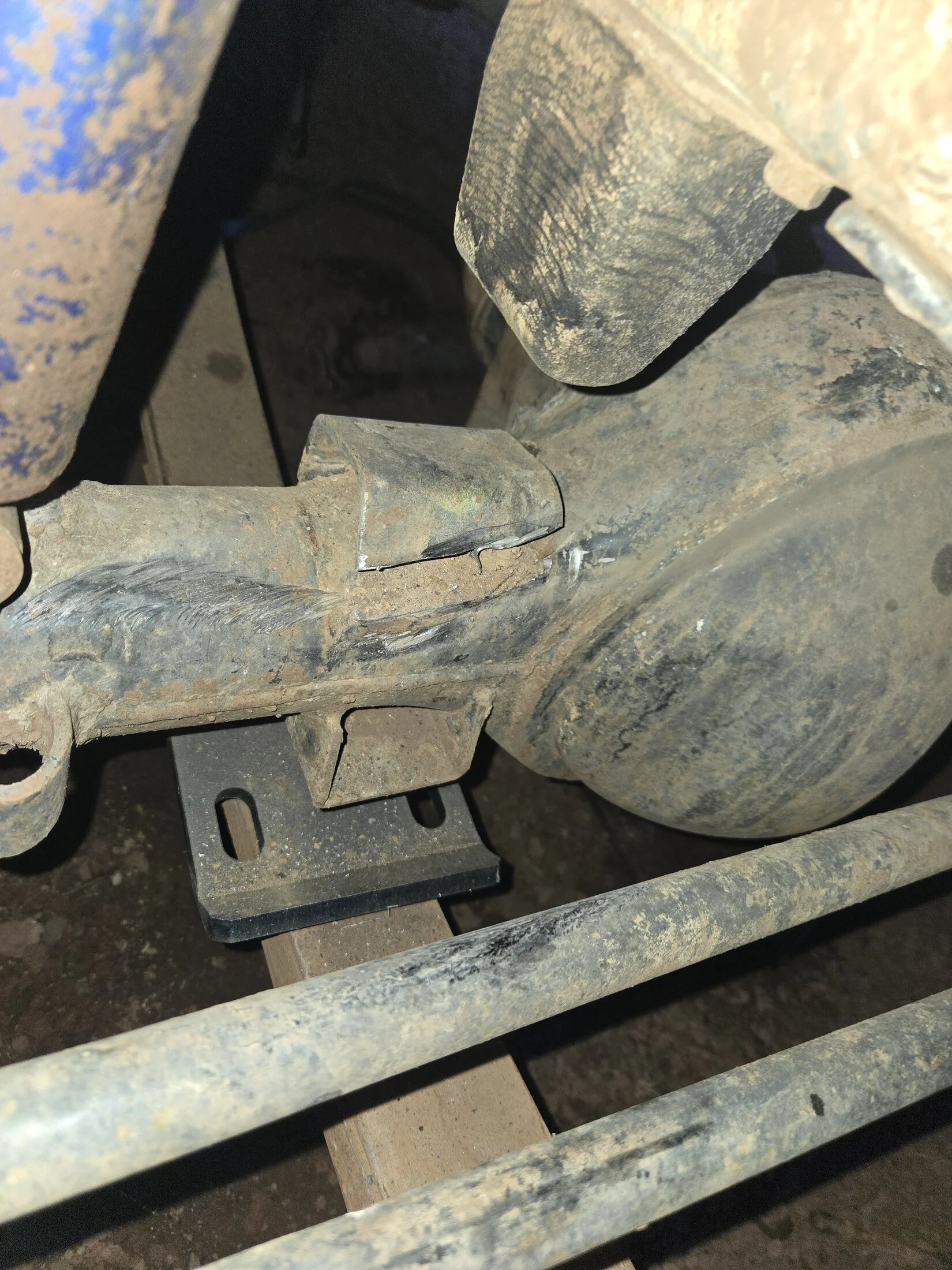

Step 1. Jack up car. Step 2. Remove leaf springs (ask me how I know this is next). Step 3. Remove u bolts. Step 4. Cut off upper spring perch (which is a lot harder with the leaf still on, and now when I try to remove the bolts the leaf articulates -_- )
If it was me I would have unbolted the u bolts, unhook the brake line, unhook shocks, unhook driveshaft, take shackles loose and roll axle out to work on it.

I would do that but im afraid if I remove the axle, then I wont have the steering components to keep the axle centered. Im also workin on a dirt driveway so having the car above me keeps me outta the rain we are having lately lol
