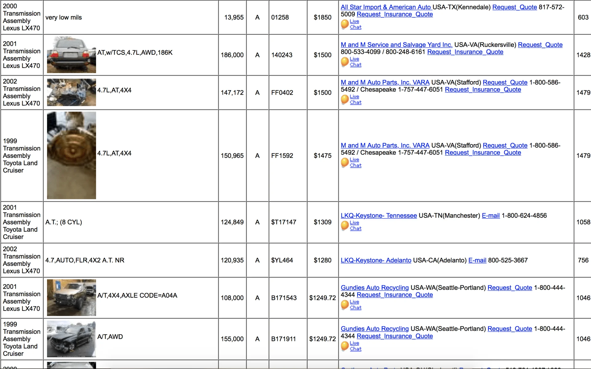

car-part.com shows there are many to be had to be able to replace with functioning units

It1fire: Yeah you are right, the quote for a rebuild was $500 less than swap! not worth it...
abuck99: Good advice, then maybe it will get more into the "good" territory and not so deep into "Fair" condition. Will clean up inside as much as possible.
Rolocado:
Thanks! That changes things, cheapest one from dealer was $2500. I am just nervous because they are somewhat high mileage, and mine broke at 175,000. I assume that most LC transmissions last longer than mine did, even though mechanic said it was "within range". I am guessing they meant at lower end of the scale?
